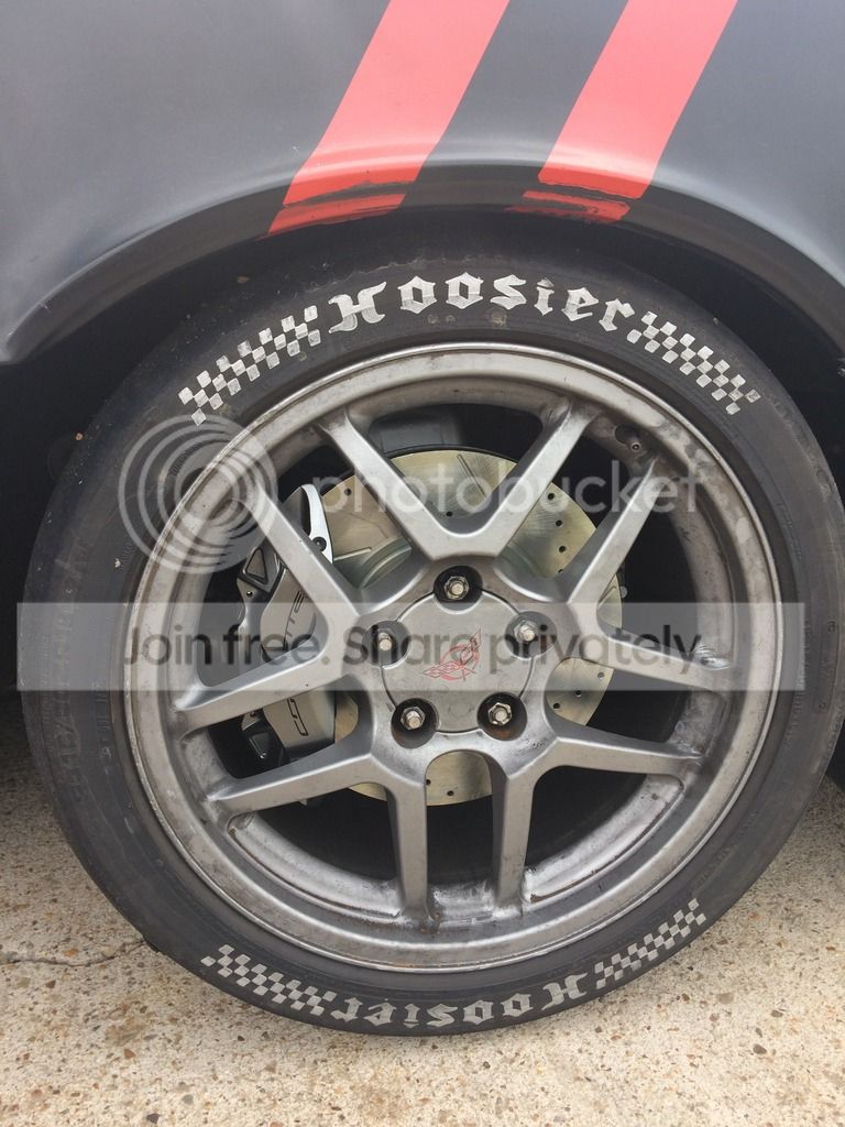

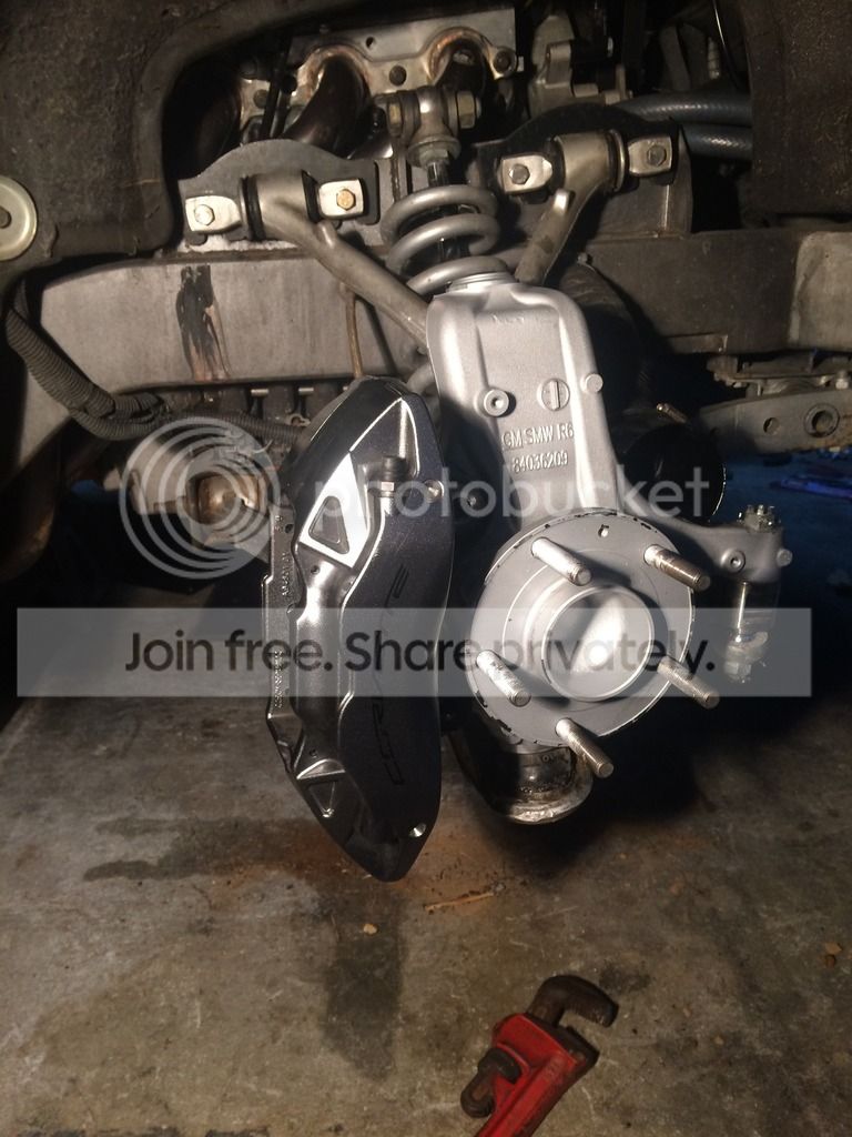

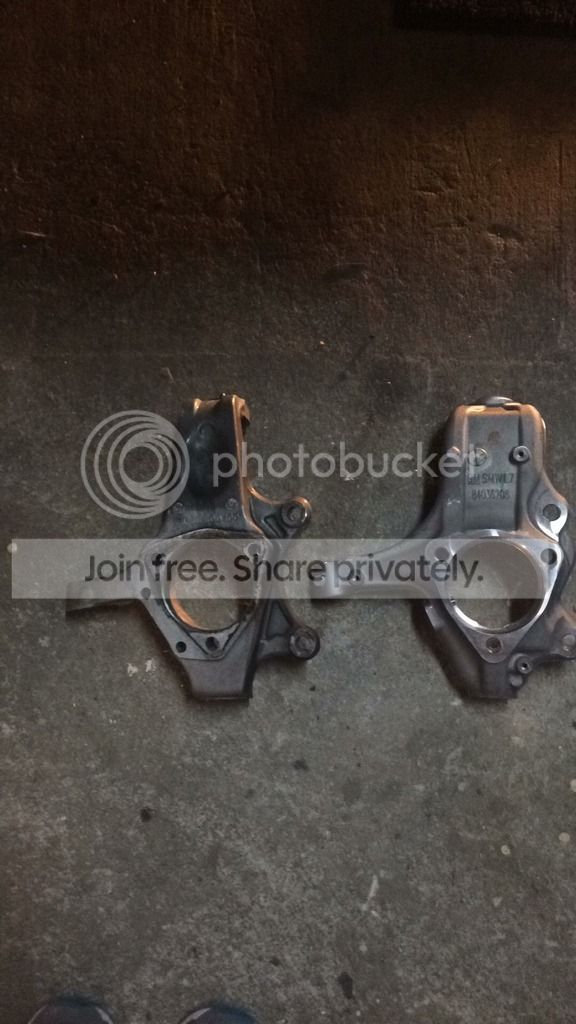

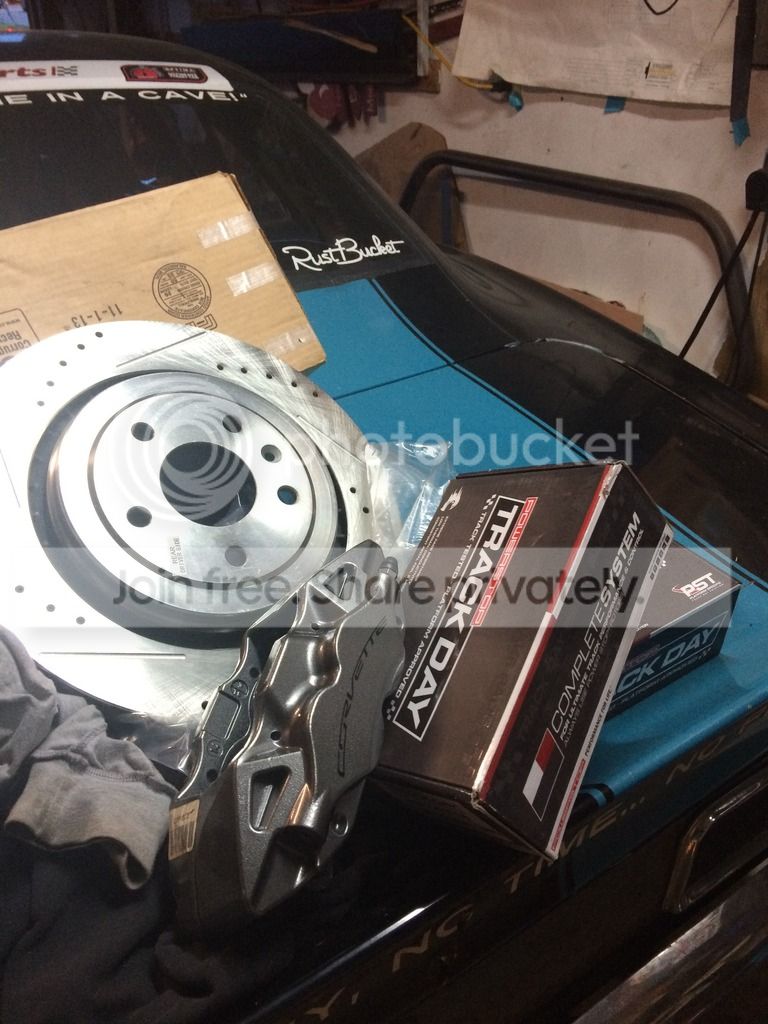

Updates! Well I pulled the car all the way to NOLA for the second Optima event of the season. That's 20 hours each way! Not fun. I'll write up a recap of that weekend later, here's the fix on the brakes.
Since the both the hub and spindle were broken and I planned to buy 2 hubs and a spindle I looked into upgrading to a C7 spindle and hub assembly. They are almost the same but just a little different. The C7 pieces are much beefier. Plus of this swap was that if I could make it work, then my calipers would bolt right on. So that's what I did! now the whole front is C7 less the control arms. I made up some brackets to hold the calipers on the rear and bolted everything together. I'd like to thank Powerstop Brakes for helping out with the rotors and pads for the swap!

I see you ran GS/C6Z rotors on your C5/C6 setup.
Was that the only thing needed to get the C7 brakes on your C6 setup?
Do you think Brembo C7 stuff is better then the C6Z PBR's?
Beach Cruiser 05-23-2017 04:26 AM
I never actually ran the Z06 rotor with the brembos, but I did mock it up to see if it would work. The only issue I could see without actually using the setup is that the C7 pad hangs just a slight bit over the outside edge of the rotor. This is because the radius it was designed for is different than the radius of the C6 Z06 rotor. but it all fits and bolts together! That's about all I can tell you. I do have some more pictures if you're interested.

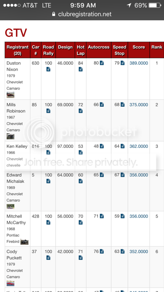

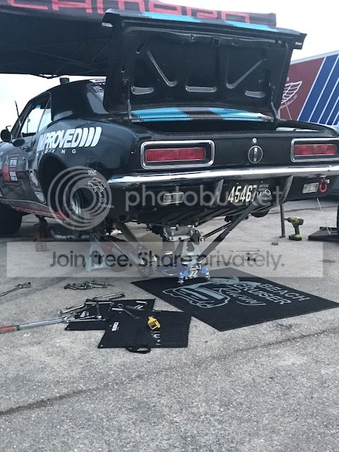

Nola update! finally sat down at my desk long enough to type this up. Like I said before I Hauled the car all the way to NOLA so I could get in three Optima Events this year for the points chase. The drive wasn't fun, and the weekend was exhausting. For the first time in D&E all of my lights and streetcar required stuff worked! Horn, dome light, HVAC, wipers and of course all the lights. Score! The new stereo in the car helped with D&E too, and I recorded my highest D&E score to date. Stereo? yep, I put in a thumping mostor stereo thanks to Soundwave Customs here in Va Beach.
Back to NOLA, the veryfirst autocross run my entire exhausts dropped off the headers halfway through! yikes! I'm just glad my wideband O2 wires kept it from coming all the way off and I was able to salvage it. It took about an hour to get the car up on stands and replace the exhaust, so I lost quite a few autox runs. Once back, something didn't sound right and there was a lot of clunking going on in the rear end, I ran a total of 4 runs and during the lunch break I put it back up in the air to check things out. Well, the crossmember that holds the Pinion mount (IRS remember) was broken in two! Its a 3" piece of heavy pipe! broken. No more autox for me that day. Patched it up best we could for the road rally, and I was extra extra gentle on it for the rally portion. Once back to the track we tore into it to remove the crossmember and re weld it back together for Sundays action. Good thing we had a keg because that attracted a lot help! We managed to get it out and one of the other teams stepped up to help us weld it with their portable set. Got it back into the car and finished the keg about 1am sunday!
On Sunday I made sure I got at least one speed stop run in before I hit the open track laps just incase I had any issues in either. Turns out the parking lot welding and extra bracing held up just fine all day on Sunday!
I gave it all she had on the road course and even sprayed a whole bottle of NOS through it, but I just couldn't make up enough ground to take the GTV win home. I was close, and only a few points out, but it's not a win. Still 2nd in GTV is my highest finish yet! and I got to grab some of Falken tire's contingency money! win win!
