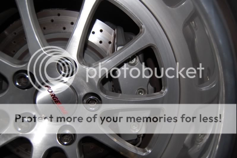

Originally Posted by GregWeld (Post 296438)
I still wonder if these valves wouldn't "help" (not cure) the KB issues on the discs you guys are using.
RP valves won't help knock back at all.. Think about how little two pounds (or even 10 lbs) of force is.. almost nothing.
Sure, they will stop fluid from gravity flowing backwards but they arn't going to stop piston knockback at all.
And you're right, you can't stop knockback with a MC.
Knockback is a mechanical issue, not a hyd/fluid one. Physical forces are acting on the caliper and pushing the pistons (by way of the pads) back into the calipers. The first pump of your brake pedal resetst the pad to the rotor and the next "pump" works the brakes.
The basic truth is that our axle ends aren't designed to handle high side loading like we get in autocross or road racing. If your axle tube is off center or warped then the problem is compounded.
A floating rear caliper will help mask the problem of the bearing/axle tube. If you want a rear fixed caliper then you need to
1) make sure your rear housing is as straight as possible to take pressure off the bearing
2) service your bearing on a regular basis (when it gets play in it)
3) Move to a stronger system like a floater or such
4) Move to a stronger bearing than can handle the forces involved better
Once I had my rear housing done by Currie my KB issue was nearly solved. But I'm sure it will creep back with more laps and require a bearing service.
