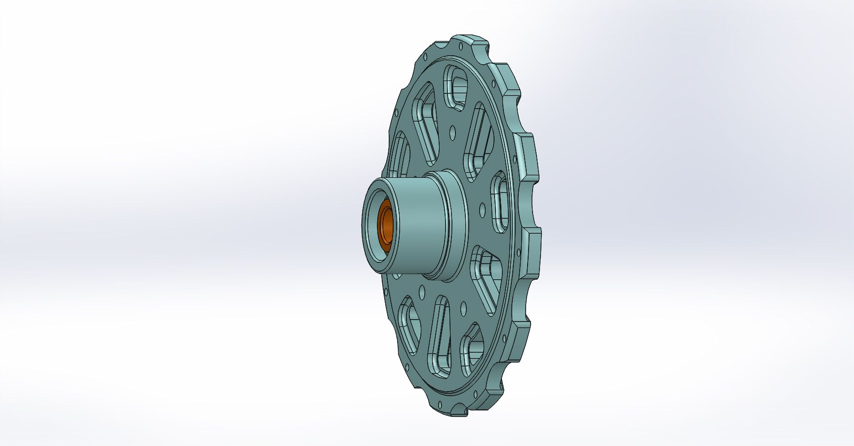

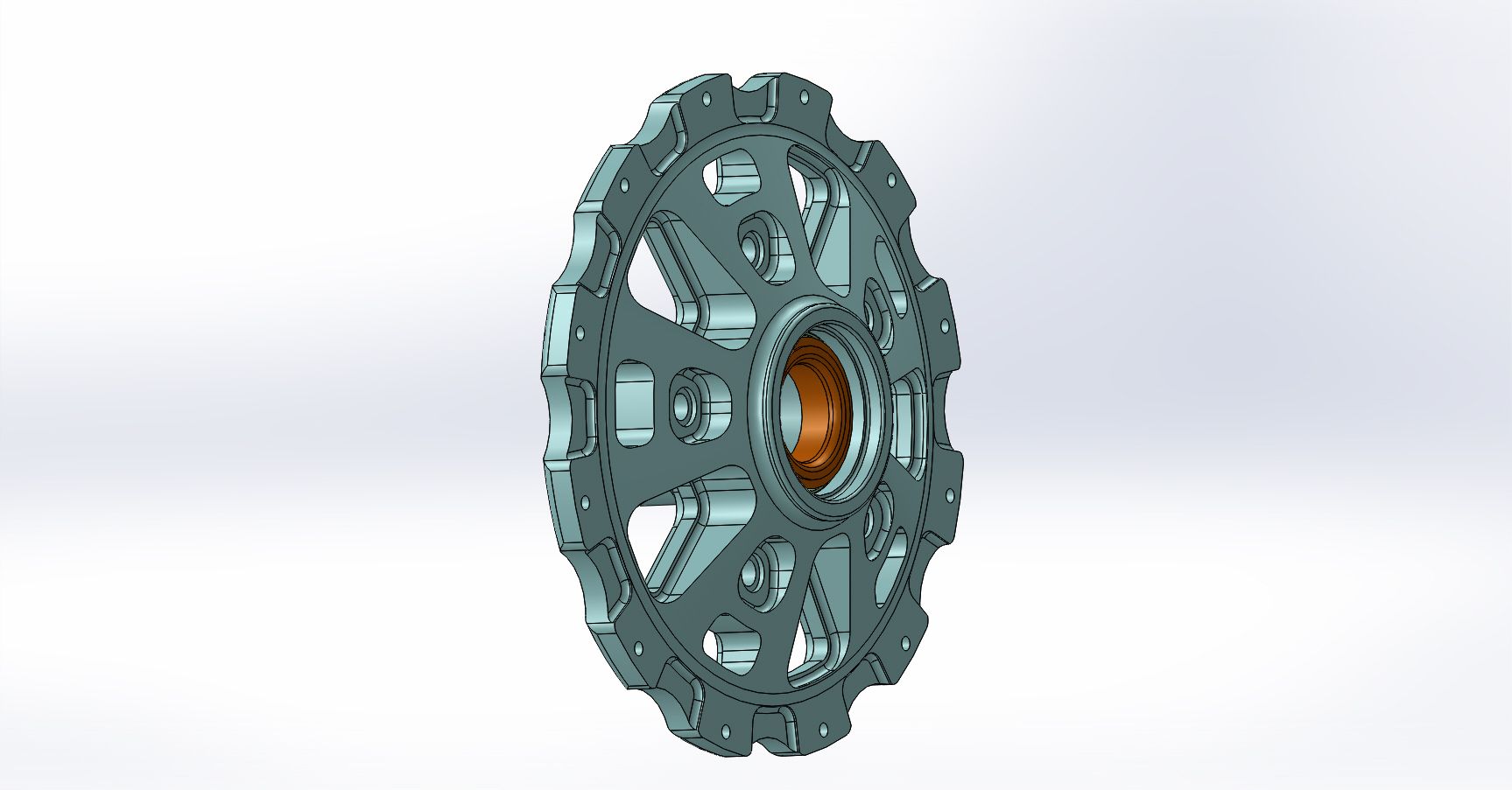

here is a hub we designed for my fabricated C6 Corvette upright using a Pinto pin that Speedway makes.. I would like the Impala pin due to its larger bearings but packaging on the hub becomes a problem due to keeping the mounting face of the wheel in the stock location to maintain the stock Corvette scrub radius.. Another thing I implemented into the design is that you mount the rotor to the hub.. It keeps rotor run out to a minimum & added some weight reduction with the pocketed holes.. Gave it a tapper machine in the back side for strength under load.. But this is as far as I have gotten.. machining is not gonna be cheap on these hubs.. But if you can machine a billet diff cover & you can get Aaron to machine sum more stuff for you.. I got a design & concept!!
http://i1015.photobucket.com/albums/...pseee83e9e.jpg
http://i1015.photobucket.com/albums/...pse67909df.jpg

Shooooot, that ain't' nothing :thumbsup:
How many you guys want? :G-Dub:
