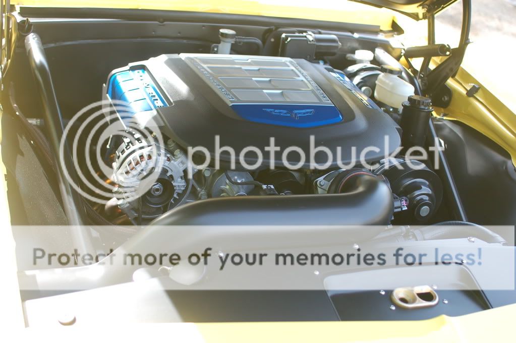

Engine bay all squared away
http://i439.photobucket.com/albums/q...5/DSC_2633.jpg

That engine bay is so perfect. Simple and factory looking install. :yes:
The way GM would build a '69 today. :thumbsup:
