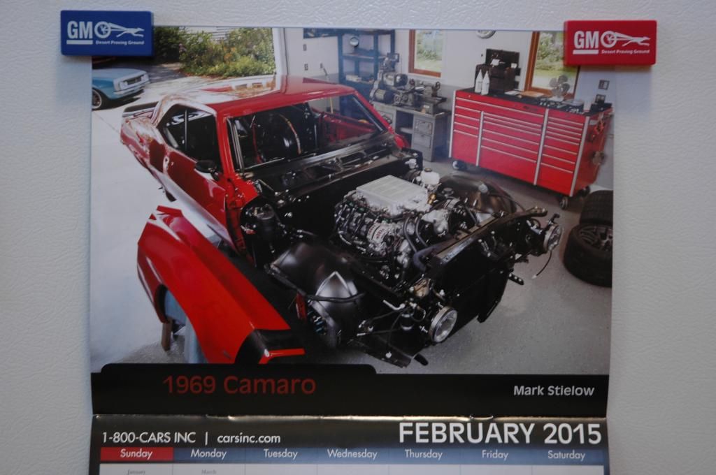

Hellfire in CARS Inc 2015 Calendar
Hellfire, as a work in progress, is featured in the 2015 CARS Inc. calendar for the month of February.
