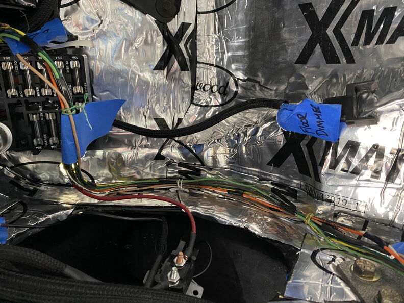

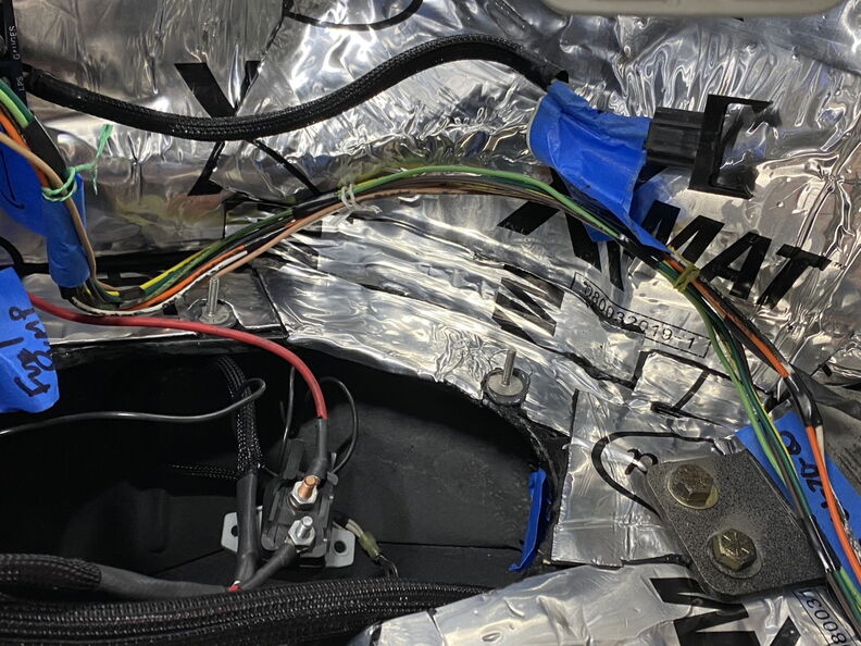

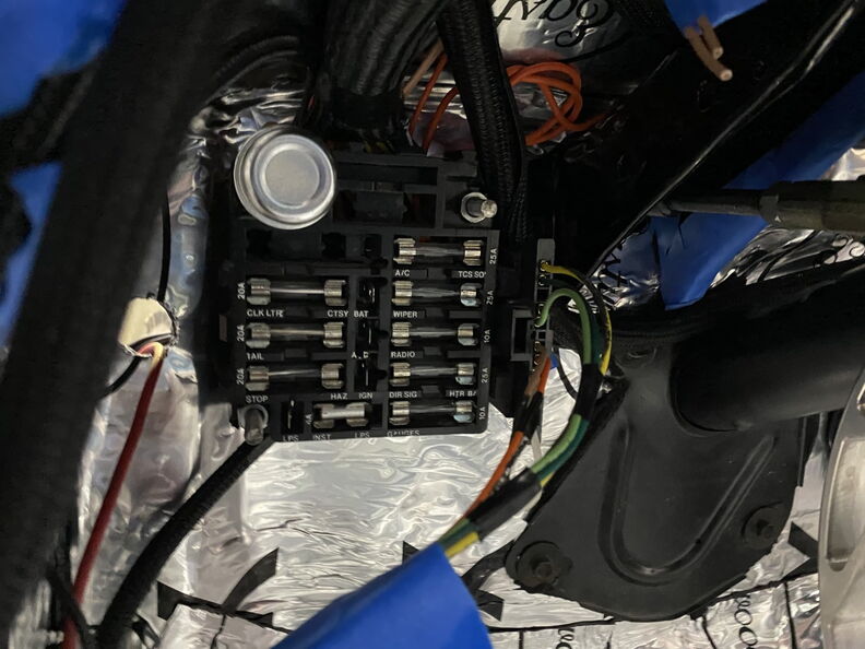

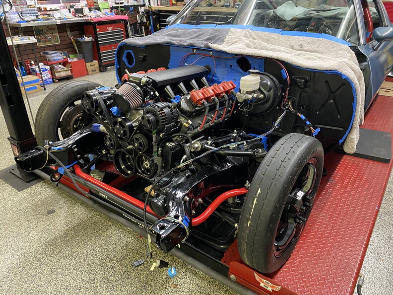

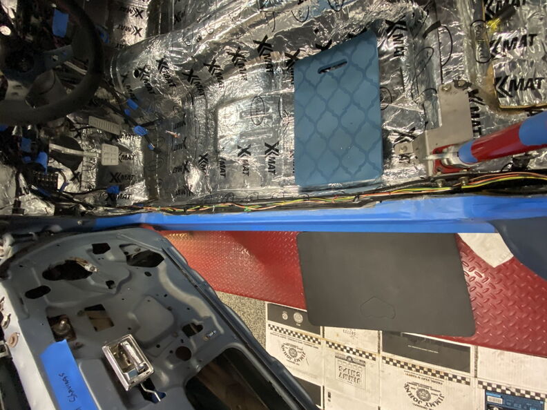

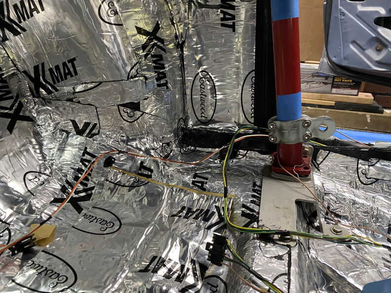

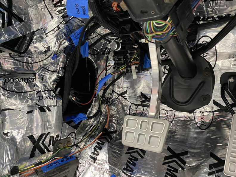

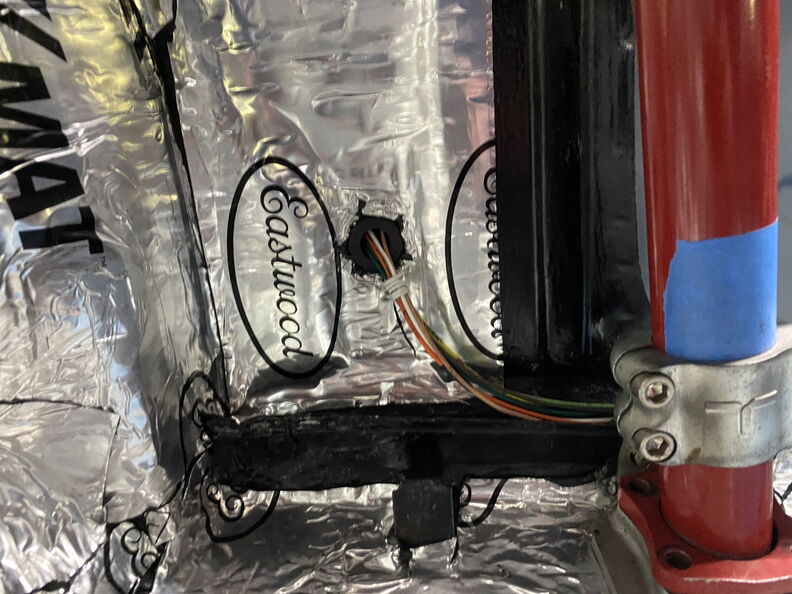

Working on wire routing and keeping it so I can service it if needed.

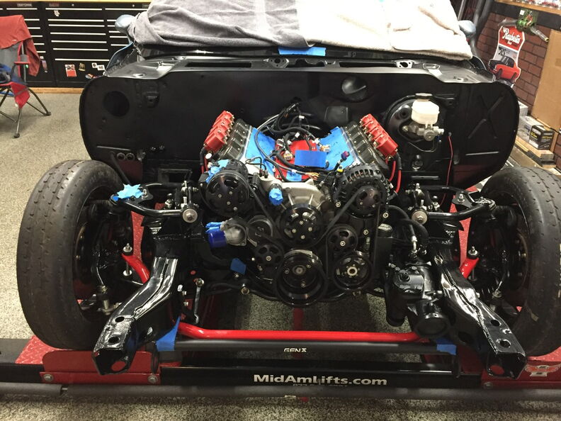

Gratuitous Front End Shot. (02-25-20)
http://www.garagescene.net/_data/i/u...e8f6345-me.jpg

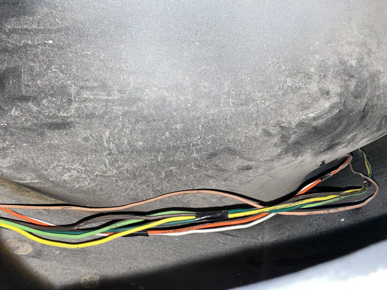

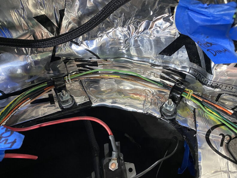

So the plan is to run a portion of wires down the rocker gutter and sneak into the inside of the rear quarter.
http://www.garagescene.net/_data/i/u...8d03f10-me.jpg
http://www.garagescene.net/_data/i/u...df1666f-me.jpg
http://www.garagescene.net/_data/i/u...7f02ced-me.jpg

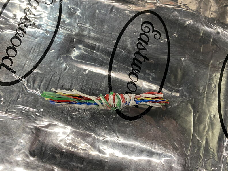

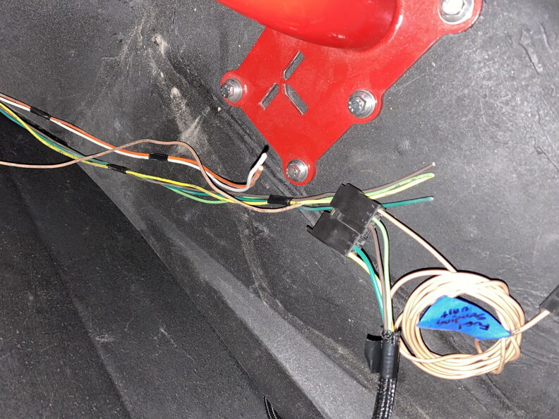

So if you have been in my garage you have seen my collection of twist tie's. I use these for mock up instead of zip ties as I can quickly change directions and not waste zip ties.
http://www.garagescene.net/_data/i/u...fcf68a2-me.jpg
If you look closely you can see all the wires are twist tied together and when I add the last couple wires I can easily add them in.
http://www.garagescene.net/_data/i/u...aafd59d-me.jpg
http://www.garagescene.net/_data/i/u...bbe9300-me.jpg
Eventually these will be secured inside the quarter after I confirm everything works correctly.
http://www.garagescene.net/_data/i/u...a24df25-me.jpg
Instead of using the giant factory plug I will replace all of the unions with weather pack connectors.
http://www.garagescene.net/_data/i/u...df5138e-me.jpg
http://www.garagescene.net/_data/i/u...68b94d0-me.jpg

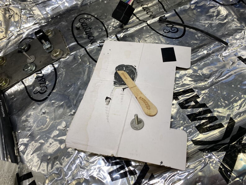

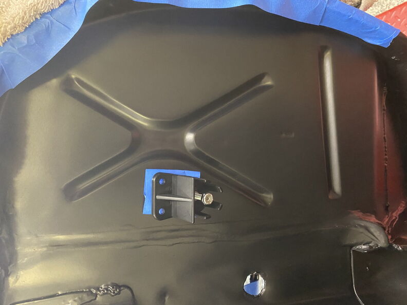

Time to epoxy in a few more Weld Mounts
http://www.garagescene.net/_data/i/u...0376e92-me.jpg
http://www.garagescene.net/_data/i/u...edaefc5-me.jpg
Loom Anchored in place (02-26-20)
http://www.garagescene.net/_data/i/u...df71267-me.jpg
syborg tt 04-29-2020 07:06 PM

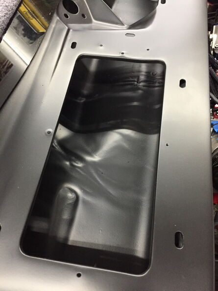

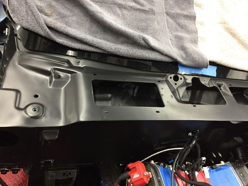

Firewall Complete.
http://www.garagescene.net/_data/i/u...01f24f5-me.jpg
Perfect time to surface protect and area that once the fenders and inner fenders you can't access.
http://www.garagescene.net/_data/i/u...a43be16-me.jpg
http://www.garagescene.net/_data/i/u...57e82db-me.jpg
Yep, he even did inside the cowl.
http://www.garagescene.net/_data/i/u...ac04969-me.jpg

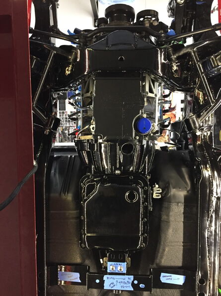

Subframe
http://www.garagescene.net/_data/i/u...bd97a95-me.jpg
http://www.garagescene.net/_data/i/u...784c9cb-me.jpg
http://www.garagescene.net/_data/i/u...9f60277-me.jpg

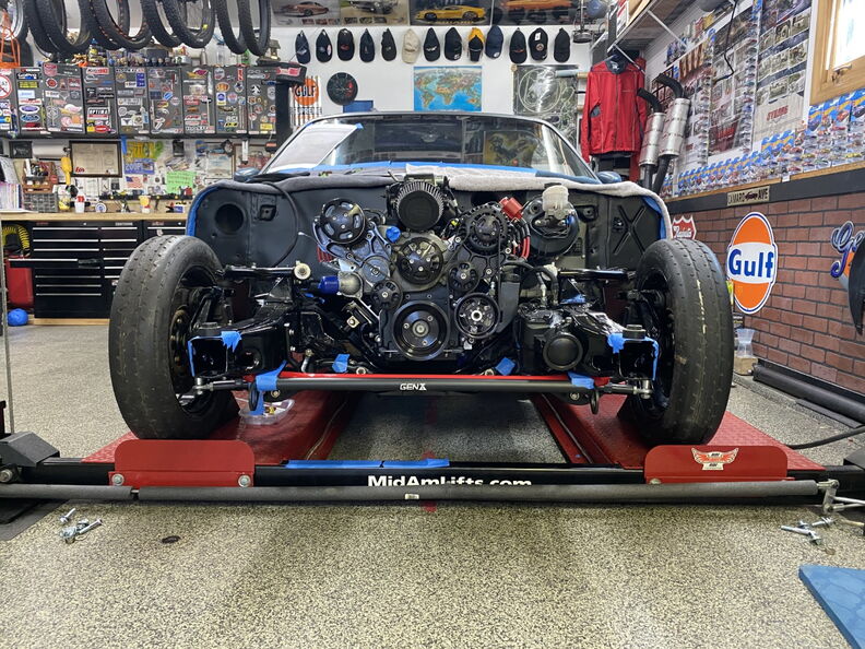

Workbench is looking a little thin & Building a better center channel mount. (02-29-20)
http://www.garagescene.net/_data/i/u...4755e77-me.jpg
http://www.garagescene.net/_data/i/u...de9cce3-me.jpg

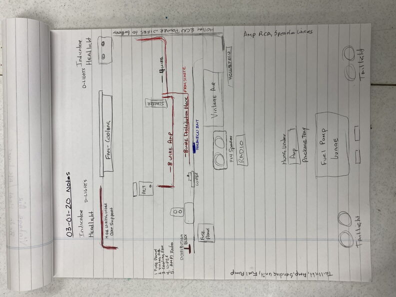

After seeing my wife work on white boards for years I realized that I could get a dry erase board for the garage and plan
the wire routing that I wanted to do in this version of the car. It so much easier for me to have a visual plan versus something
in my head.

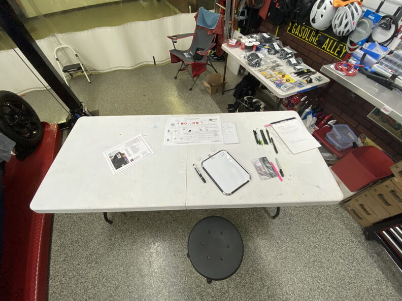

So once again out comes my Garage Desk and the dry erase board.
http://www.garagescene.net/_data/i/u...b40c213-me.jpg
http://www.garagescene.net/_data/i/u...79741a0-me.jpg
Honestly, I really love Blue Tape if you all haven't figured that out yet.
http://www.garagescene.net/_data/i/u...cd2da39-me.jpg
Once I am comfortable with the dry erase board I transfer my thoughts to the cars note pad.
http://www.garagescene.net/_data/i/u...3a0e857-me.jpg

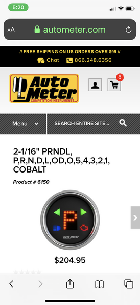

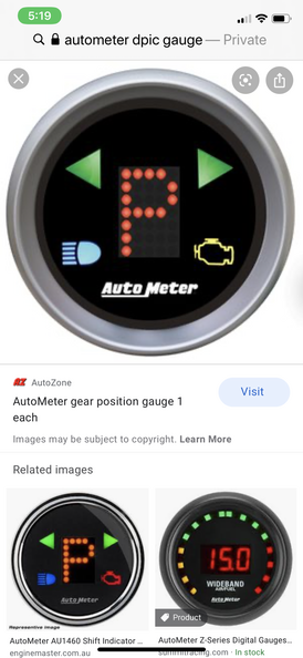

At the same time I am trying to plan the new dash layout since I am going with the new 7" Holley dash and I still want to
have something that will fill the right side of the dash surround and I think this is what I am going to put in that area.
http://www.garagescene.net/_data/i/u...61d938a-me.png
http://www.garagescene.net/_data/i/u...867fd68-me.png

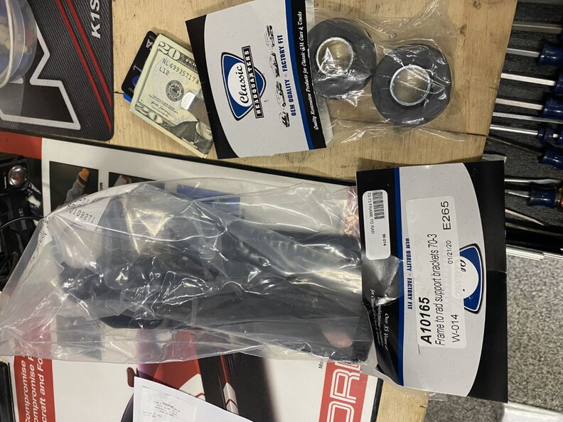

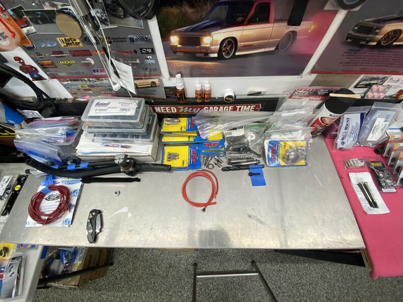

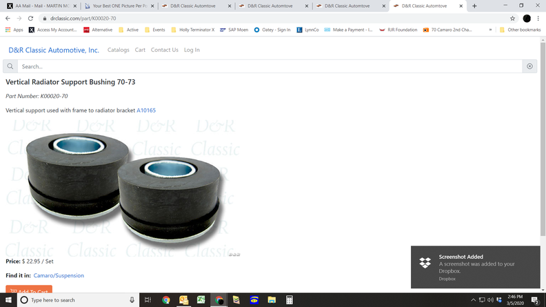

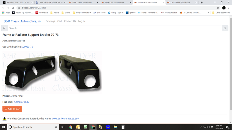

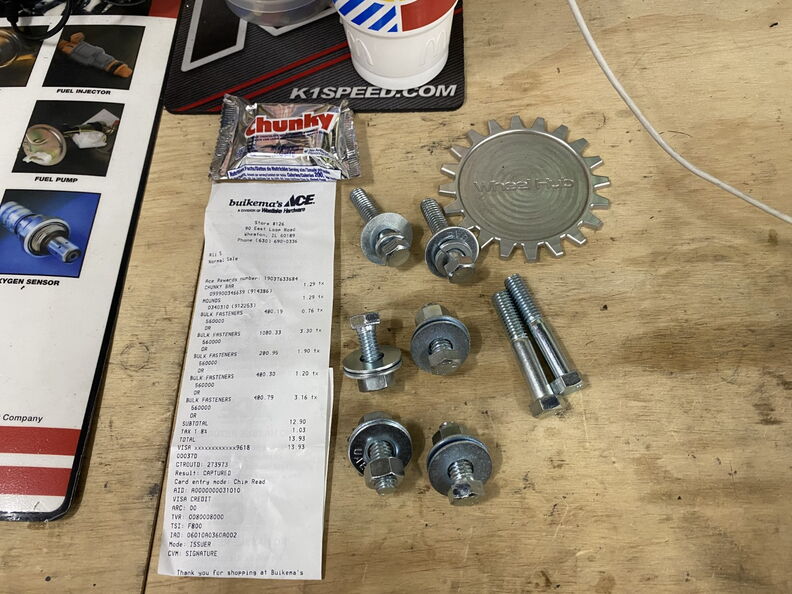

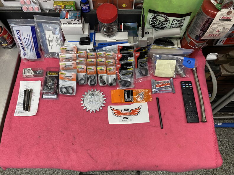

Well somewhere along the way I misplaced a couple brackets and some hardware.
Thankfully D&R Classics is only 25 minutes from my house so a Quick trip over and some Taco's and I am back to
work on the car.
http://www.garagescene.net/_data/i/u...73a99dc-me.png
http://www.garagescene.net/_data/i/u...2f1457e-me.png
http://www.garagescene.net/_data/i/u...e841587-me.jpg

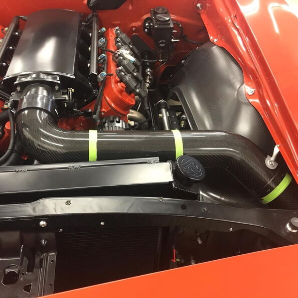

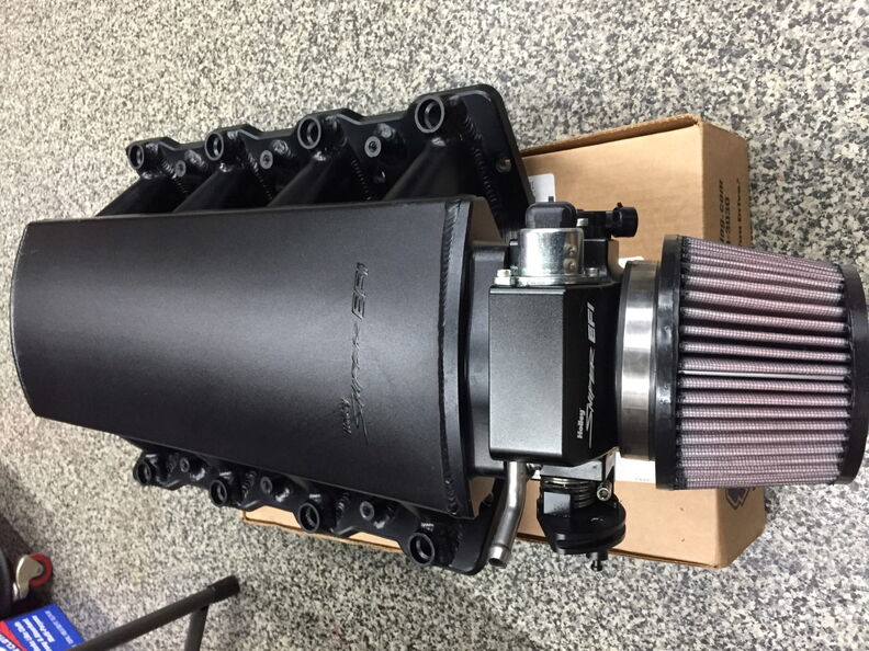

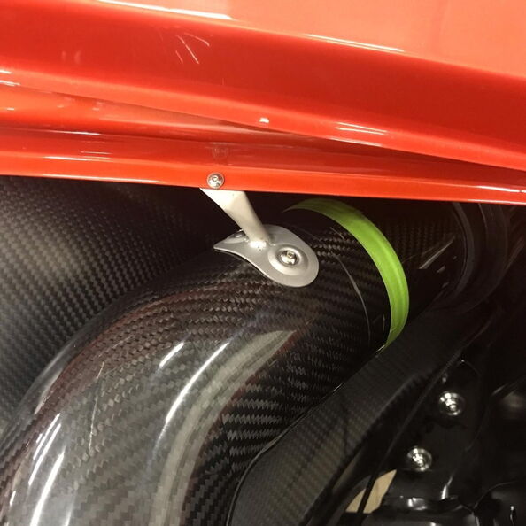

I also spent a little garage time searching for intake tube idea's and I am in love with the set up the guys at
Chris Holstrom Concepts executed on there Camaro. (03-06-20)
http://www.garagescene.net/_data/i/u...dd438d6-me.jpg
http://www.garagescene.net/_data/i/u...4da83c1-me.jpg

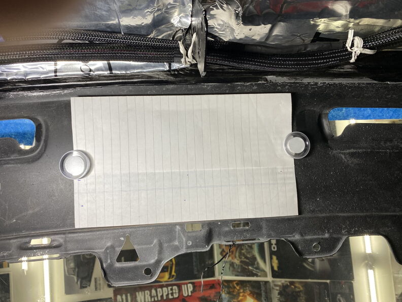

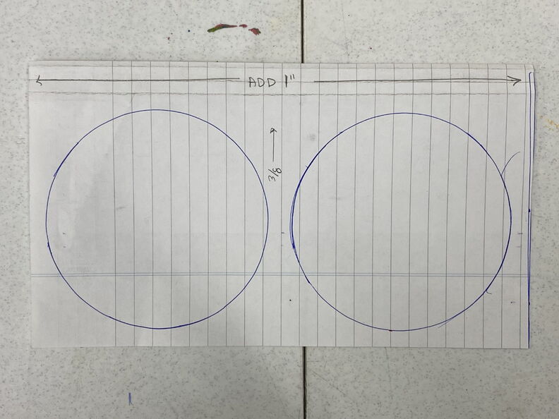

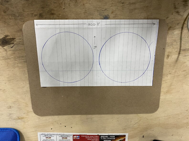

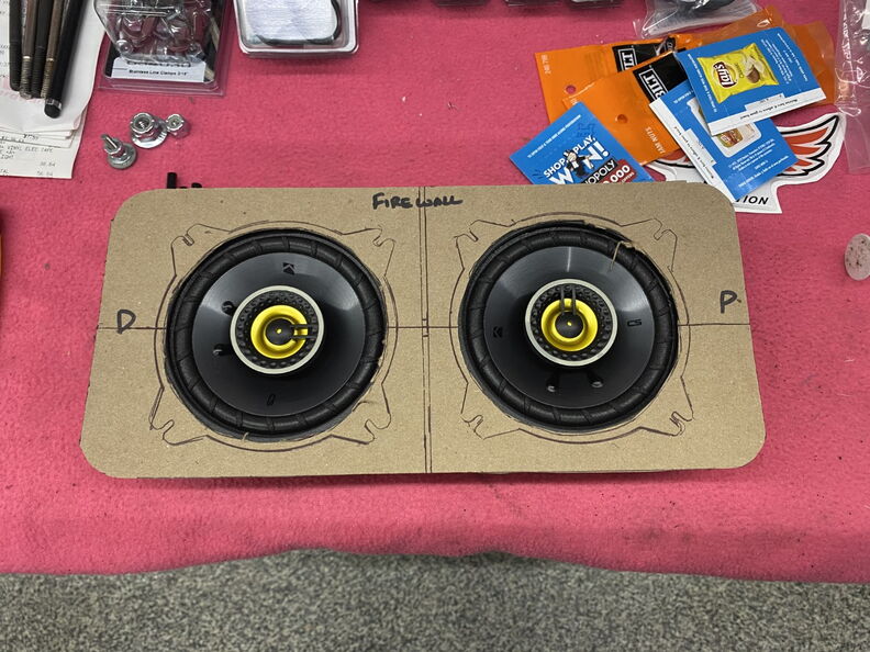

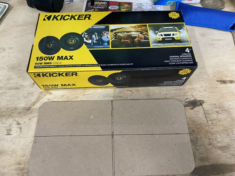

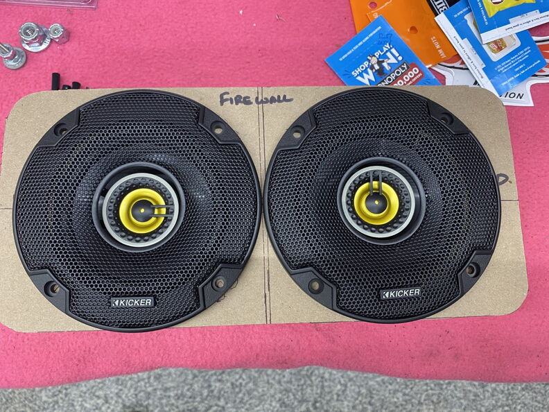

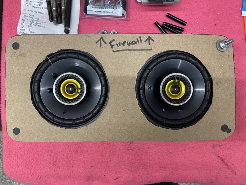

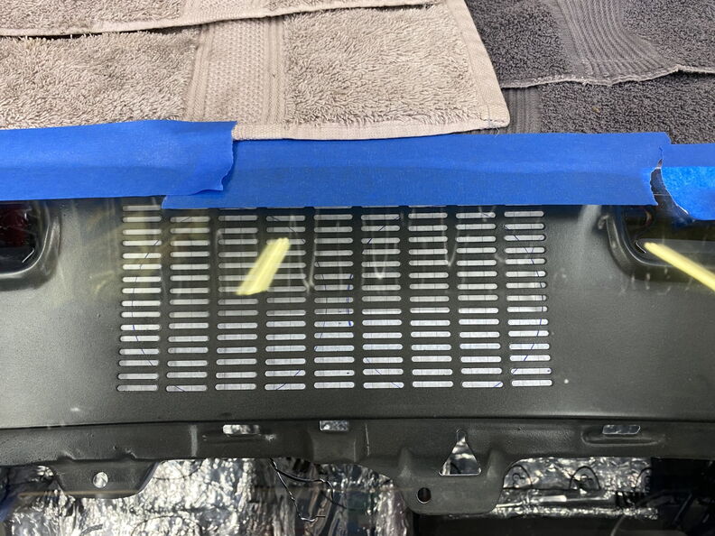

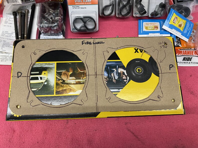

Working on the Kicker Center Channel (03-14-20)
http://www.garagescene.net/_data/i/u...e11d604-me.jpg
http://www.garagescene.net/_data/i/u...932a9fe-me.jpg
http://www.garagescene.net/_data/i/u...111570f-me.jpg
It's to bad I won't be using the grills as they look really nice.
http://www.garagescene.net/_data/i/u...461b04f-me.jpg
Making sure I have enough clearance for the weld studs.
http://www.garagescene.net/_data/i/u...a8f8099-me.jpg
http://www.garagescene.net/_data/i/u...210dc87-me.jpg

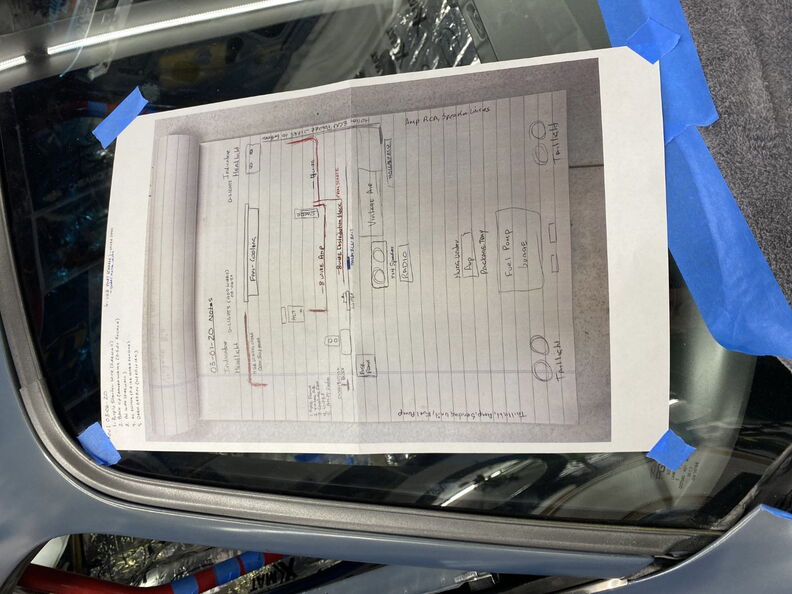

Remember my note pad well I took a pictures of it and printed on 11 x 17 paper so I could tape it to the windshield. This way I
won't need to look for my glasses every time I want to read it. I will also writes notes and changes on this so when the car is
complete I can redo the wire diagram in case I ever need to look back I will be able to have a reference sheet.
http://www.garagescene.net/_data/i/u...8a65a78-me.jpg

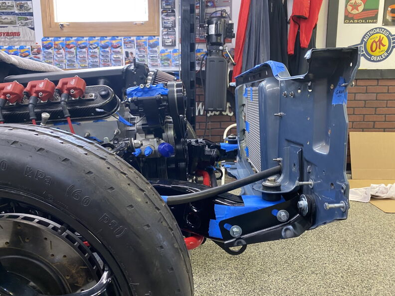

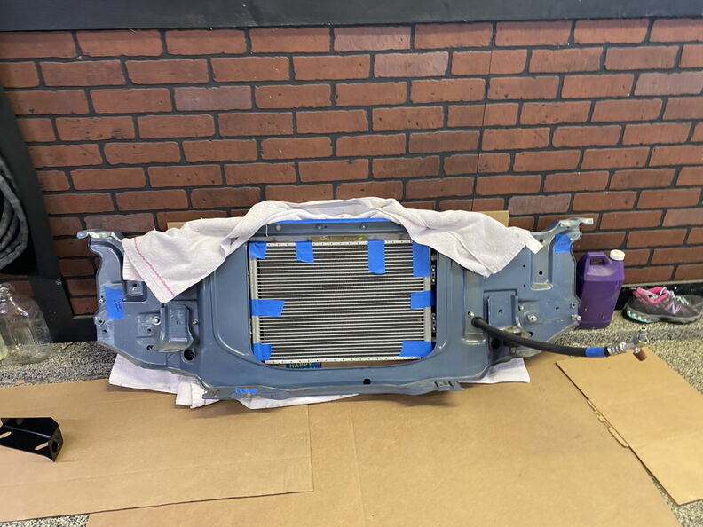

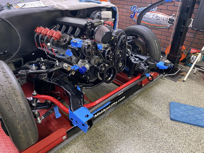

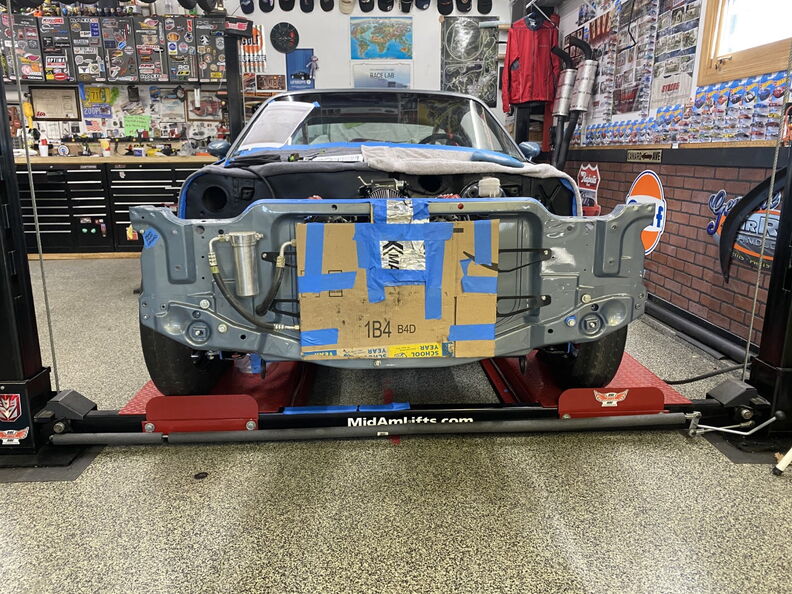

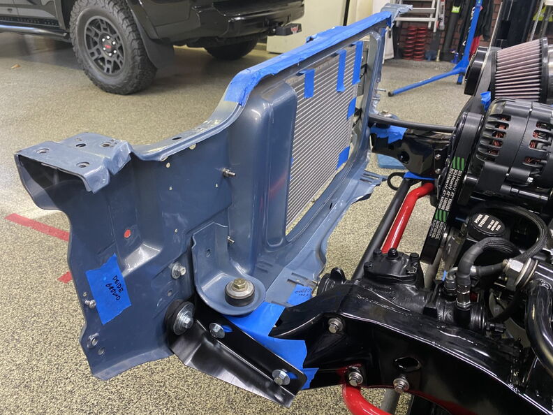

Time to fit the core support and yes more blue tape as the Covid-19 Lock down makes it difficult to mount the core support safely by myself.
http://www.garagescene.net/_data/i/u...8b17ace-me.jpg
http://www.garagescene.net/_data/i/u...316b58b-me.jpg
Here goes nothing.
http://www.garagescene.net/_data/i/u...98f91af-me.jpg
http://www.garagescene.net/_data/i/u...f4ef3df-me.jpg
http://www.garagescene.net/_data/i/u...e9b80dc-me.jpg
http://www.garagescene.net/_data/i/u...756d590-me.jpg
