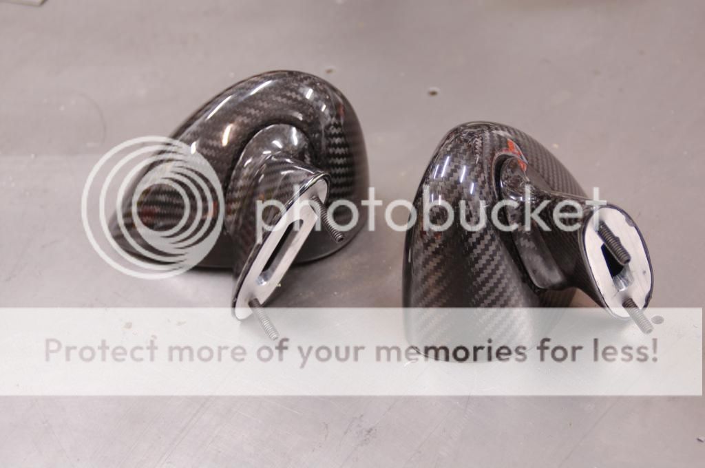

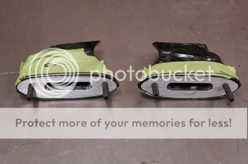

mike343sharpstk 02-28-2015 09:59 AM
Originally Posted by Stielow (Post 465643)
I also had to make mount to bond to the mirrors to mount the mirrors to the doors.
http://i439.photobucket.com/albums/q...ps9041351f.jpg
http://i439.photobucket.com/albums/q...psdbad7eed.jpg
Can you please tell me what you used to bond your side mirror aluminum base to the carbon fiber?
I've done a test using the loctite marine 2-part epoxy but it doesn't hold like I expected.
Thanks
Mike
onelapduster 02-28-2015 01:52 PM
Thanks
Mike
You could use what is called B-1/2 in the aviation world, it will work.
http://www.aircraftspruce.com/catalo...lickkey=104482
Stielow 03-01-2015 07:41 AM
Thanks
Mike
I used 3M panel bond adhesive. I'll see if I have a part number.
Mark
