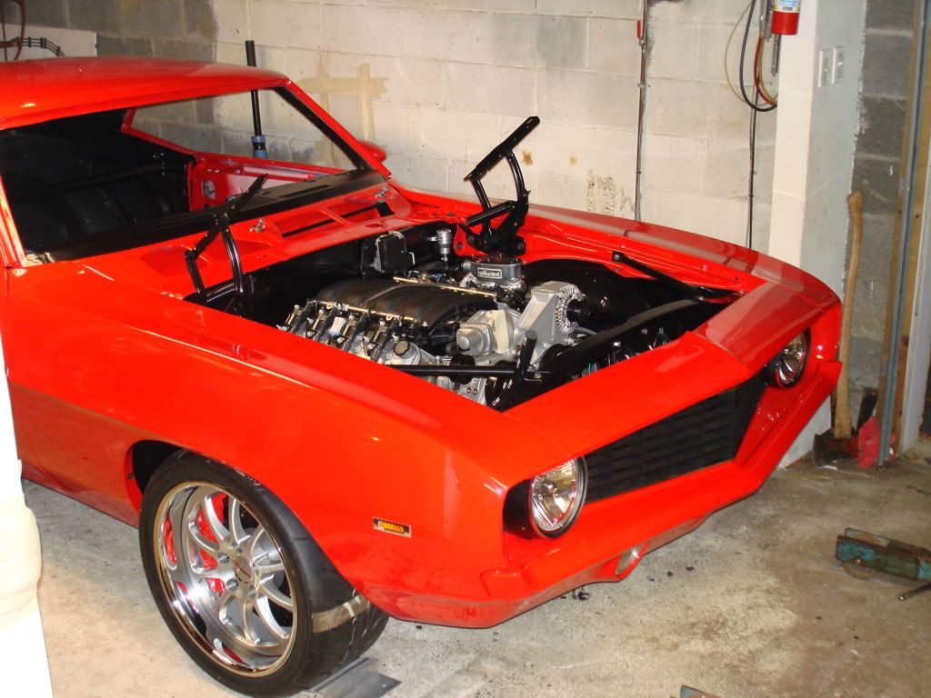

Im pretty pumped up tonight, got the engine off the floor and in the car. It really went smooth. Im shocked how much room there is up front, it almost looks like the engine is set back an inch or so, but theres plenty of room in the back as well. Can't wait to get the gear box back from Liberty, I sent it over there about 5 weeks ago, they should be shipping it back to me this week. Ive talked with Paul and Brad a few times. I figured since the TKO 600 is going behind a motor that can turn 6500+ it better shift nice. I have one already in my 67 and its a bit notchy and not so smooth. It will be interesting to compare the two once I get the new car on the road. Its nuts how nice that engine fits in there. Cant wait to get the pipes and RD radiator in.

Rich that looks sweet in there, you must be pumped. Who's headers and mounts are you using? So are these going to be his and hers Camaro's??? lol Keep up the good wrok and the pictures.

Thanks guys- The headers and mounts are all DSE. Its to bad I didn't get the car back 3 months earlier, I may have had it done. Oh well, we can feel the fall/winter knockiing on the door here in Jersey.
