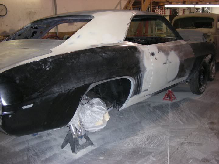

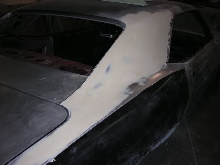

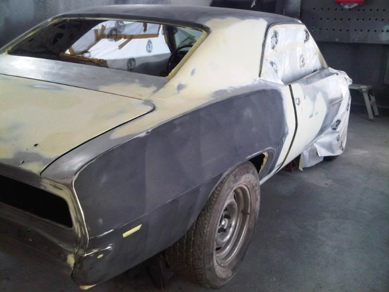

g356gear 10-26-2010 08:56 PM
A little more bodywork.....
http://i20.photobucket.com/albums/b2..._5503246_n.jpg
http://i20.photobucket.com/albums/b2..._5857577_n.jpg
http://i20.photobucket.com/albums/b2..._2015515_n.jpg
http://i20.photobucket.com/albums/b2...0_898708_n.jpg
http://i20.photobucket.com/albums/b2..._1554336_n.jpg
http://i20.photobucket.com/albums/b2..._6306607_n.jpg
http://i20.photobucket.com/albums/b2..._5353412_n.jpg
http://i20.photobucket.com/albums/b2..._1028622_n.jpg
http://i20.photobucket.com/albums/b2...545539_n-1.jpg

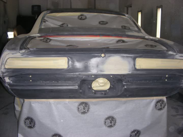

g356gear 10-27-2010 04:27 PM
Thanks!!
Into the booth and getting masked upfor the first coats of primer this afternoon!

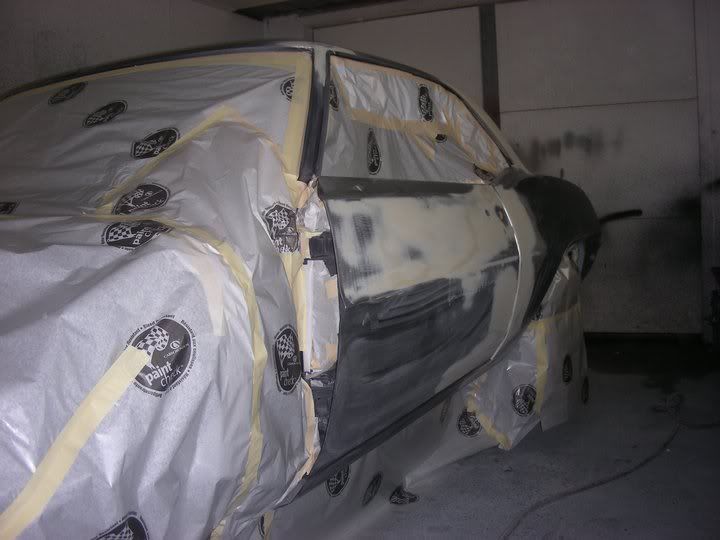

g356gear 10-28-2010 08:39 PM
Finished up with the masking
http://i20.photobucket.com/albums/b2..._2100548_n.jpg
http://i20.photobucket.com/albums/b2..._7281771_n.jpg

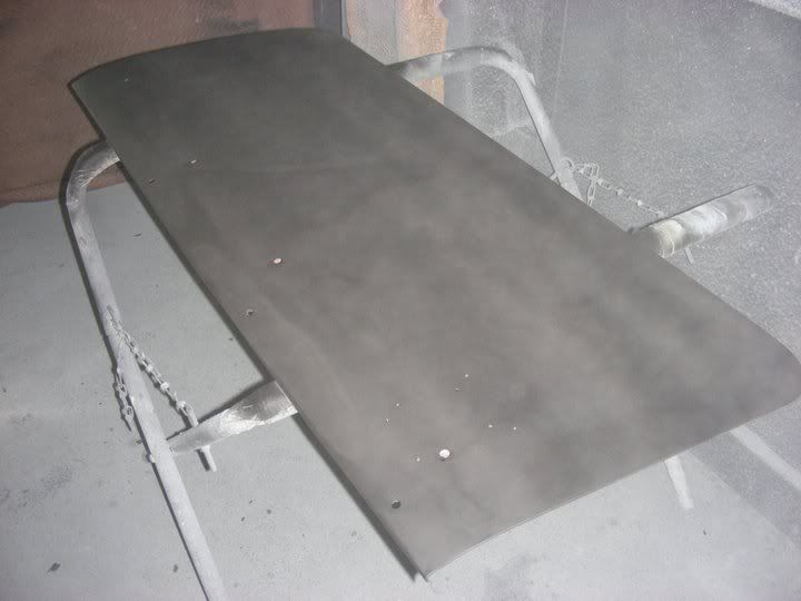

First coats of epoxy
http://i20.photobucket.com/albums/b2..._2807571_n.jpg
http://i20.photobucket.com/albums/b2..._4815517_n.jpg
http://i20.photobucket.com/albums/b2..._5435155_n.jpg

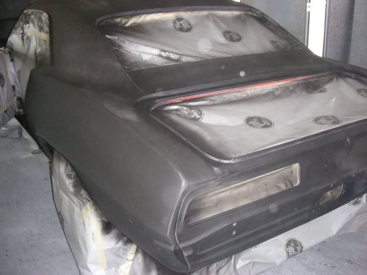

Then 4 coats of slick sand....
http://i20.photobucket.com/albums/b2..._1887454_n.jpg
http://i20.photobucket.com/albums/b2..._4514630_n.jpg
http://i20.photobucket.com/albums/b2..._1629666_n.jpg
http://i20.photobucket.com/albums/b2..._3132118_n.jpg
http://i20.photobucket.com/albums/b2..._7186471_n.jpg
http://i20.photobucket.com/albums/b2..._1347890_n.jpg
A couple days of dry time and then board it out!!

awr68 10-29-2010 09:15 AM
Very cool! They are making great time on it....looks like you hired a good shop!
It also appears that the car didn't need too much filler and the shop is using it correctly! You now have a very solid car that is being done correctly! :woot:

Thanks guys. Very happy with the shop so far. Any metal that was bad (quarters, truck drop downs, lower front fenders) got removed and replaced with new metal. Everything else on the car was solid and straight and didnt need much filler. They do a lot of extra hammer and dolly work to keep the filler to a minimum. You pay a little more but you know what you are getting.
