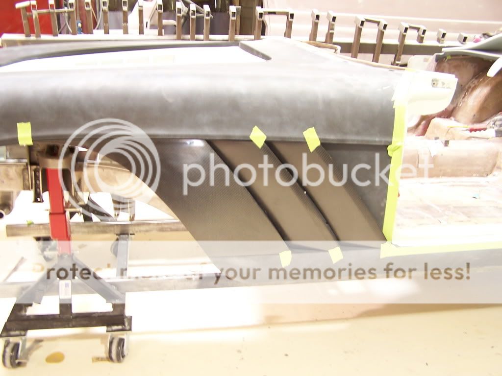

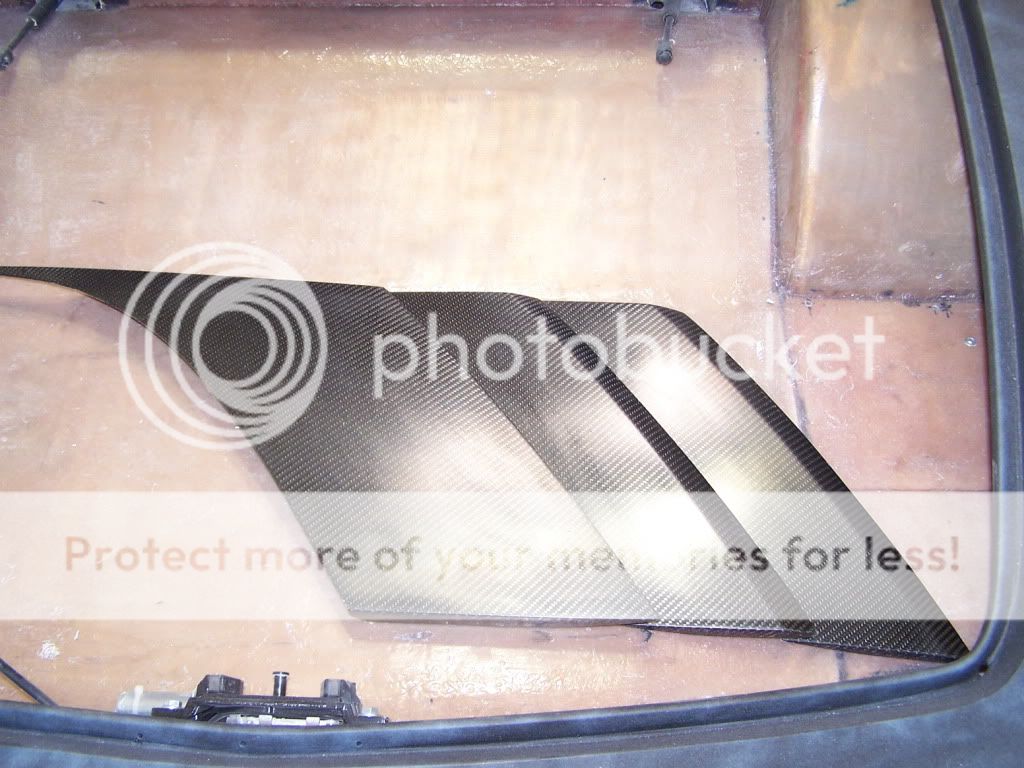

Fender louvers
http://i563.photobucket.com/albums/ss79/RS-Perf/137.jpg
http://i563.photobucket.com/albums/ss79/RS-Perf/138.jpg

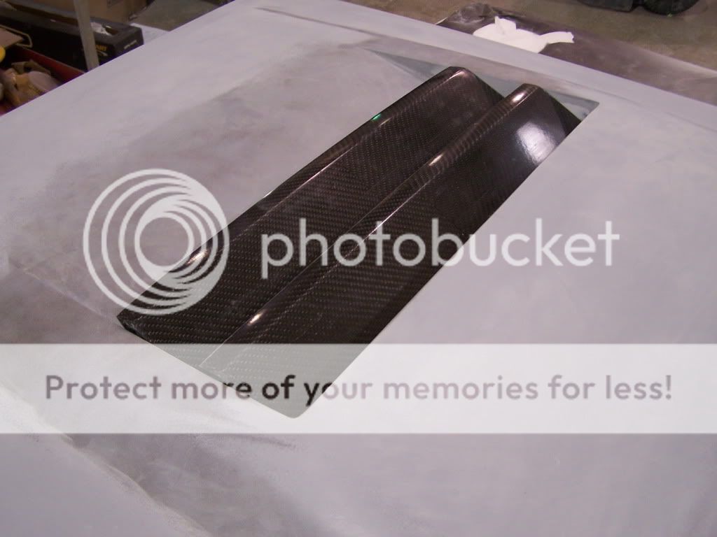

Hood Louvers
http://i563.photobucket.com/albums/ss79/RS-Perf/141.jpg

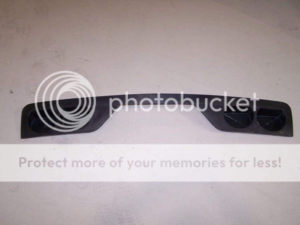

Tail Light Panel
http://i563.photobucket.com/albums/ss79/RS-Perf/142.jpg

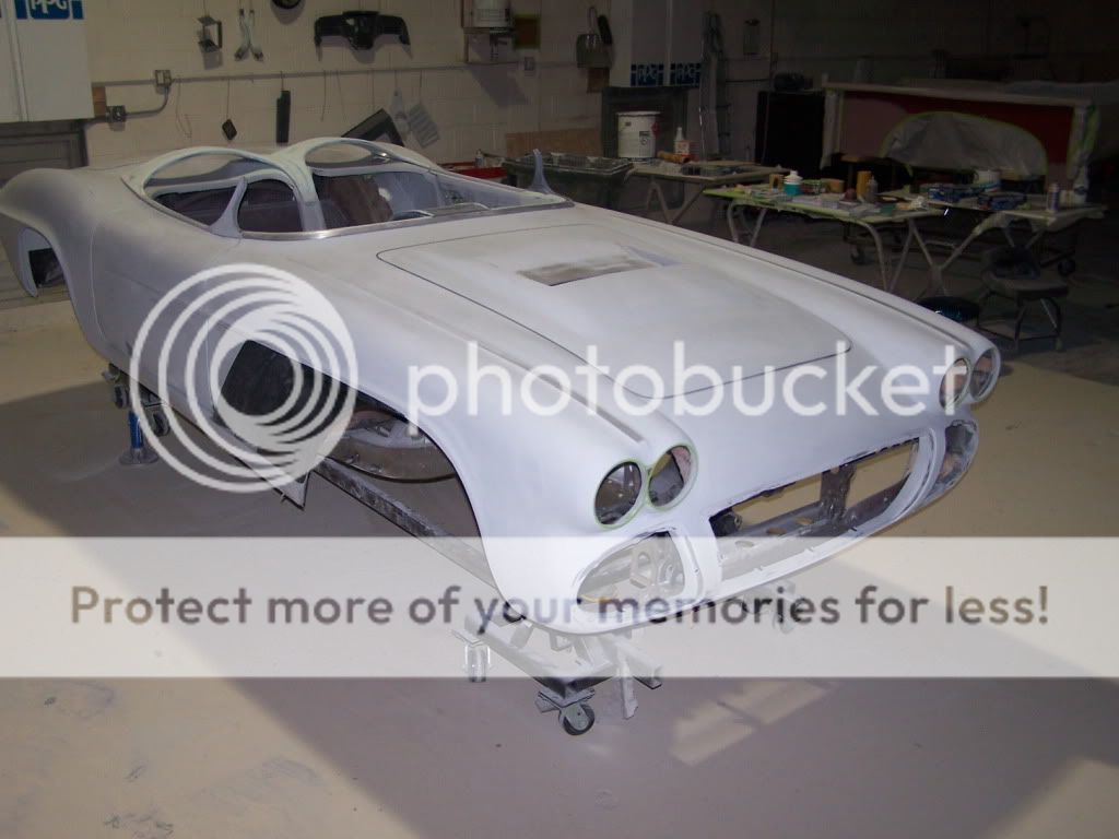

Whole thing mocked up in the final prep stages.
http://i563.photobucket.com/albums/ss79/RS-Perf/140.jpg
