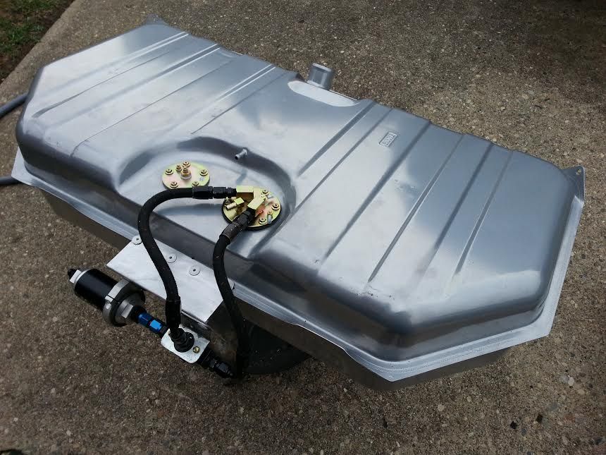

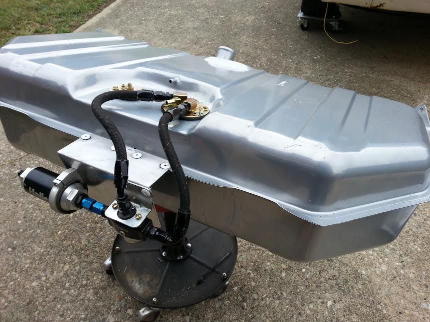

Built a small angle bracket to hold the regulator and filter on the new Tanks Inc fuel tank its a great looking tank and I'm using their sender and pump system going to get it in the car today,,,they have the Tank on there website now! look here
http://i752.photobucket.com/albums/x...psa71fabd6.jpg
http://i752.photobucket.com/albums/x...ps3b44e8f6.jpg
Nice setup there Rod ... question, not to be a smarta.., but should there be a filter before the Holley regulator and before the pump? Just asking cuz that is the route I plan to take with my carb'd SBC.
Keep upgrading and posting pixs .... thanks!
Michael
Rod P 10-12-2014 03:45 PM
Michael
great question....this tank has an internal pump and sock , then right to regulator then the filter and on to the carb...I guess I could put one between the internal pump and the reg, on that short run to the reg :thankyou:
