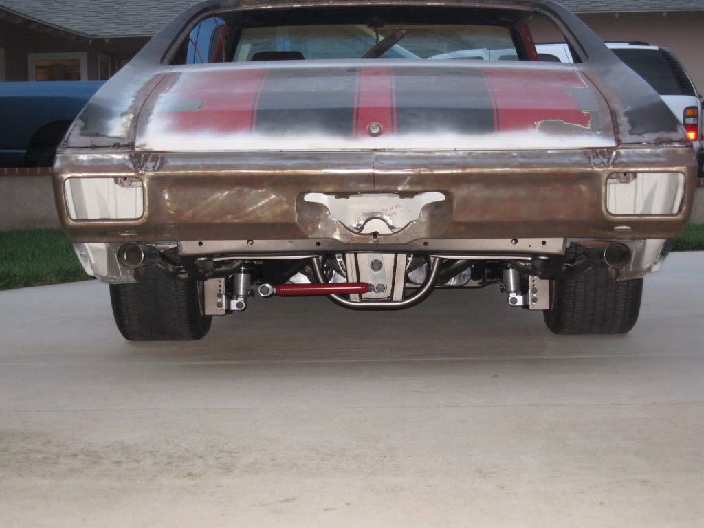

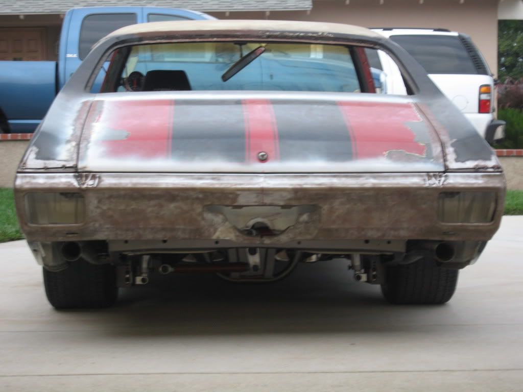

the body went back on the frame today. i plan to get the rear bumper finished and the rear side markers done in the next couple weeks. you can see how much the rear was narrowed with the old wheels on. and thats with them flipped around for more backspace. more to come.....
http://i858.photobucket.com/albums/a...i/IMG_0226.jpg
http://i858.photobucket.com/albums/a...i/IMG_0233.jpg
http://i858.photobucket.com/albums/a...i/IMG_0235.jpg

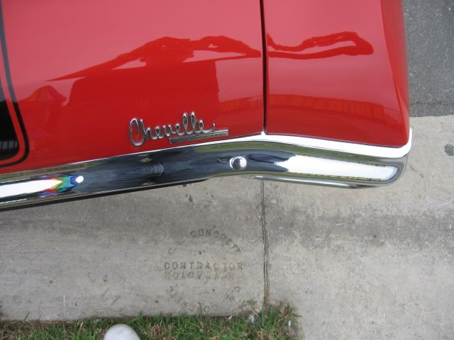

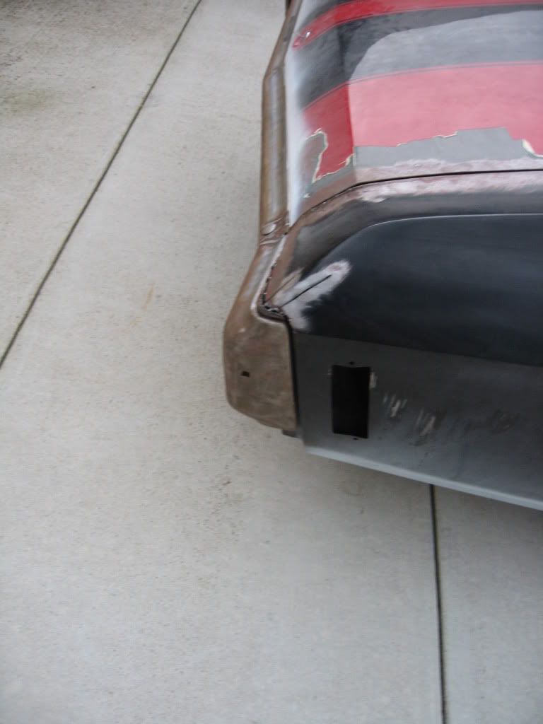

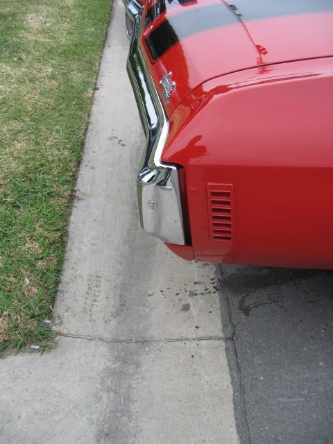

ive been busy between work, family and the promotional classes that ive been taking. but, i got a little more work done on the bumper. i didnt take a whole bunch of good pics before i started, but i did dig up some that i shot last year at a car show. it really shows how much ive been able to suck it up.
i still need to finish working the sides a little more. if you notice in the first pic of the car at the show, the bumper never followed the quarter in stock form. although i got them much closer, there was no way to make this perfect without a huge amount of work to the bumper, and if i want to get it rechromed it may have been too much. but with the bumper not following the quarter perfectly, it gives the illusion of the gap being off when viewed at certain angles. this is bugging the CRAP out of me. i also started with 1/4" gaps, but decided to close them all up to about 3/16". if you look at the side pic you can see how much black hides gaps. i have since shot the quarter white in that area, and the although the gap looks large, its only 3/16.
the last part will be getting the bottom filler piece fit and making a new "bumper pad". the stock one is rubber, but i plan to do something out of aluminum.
here are some pics of the bumper today and the one i shot at the show.
http://i858.photobucket.com/albums/a...i/IMG_8310.jpg
http://i858.photobucket.com/albums/a...i/IMG_8311.jpg
http://i858.photobucket.com/albums/a...i/IMG_0306.jpg
http://i858.photobucket.com/albums/a...i/IMG_0314.jpg
http://i858.photobucket.com/albums/a...i/IMG_0321.jpg
