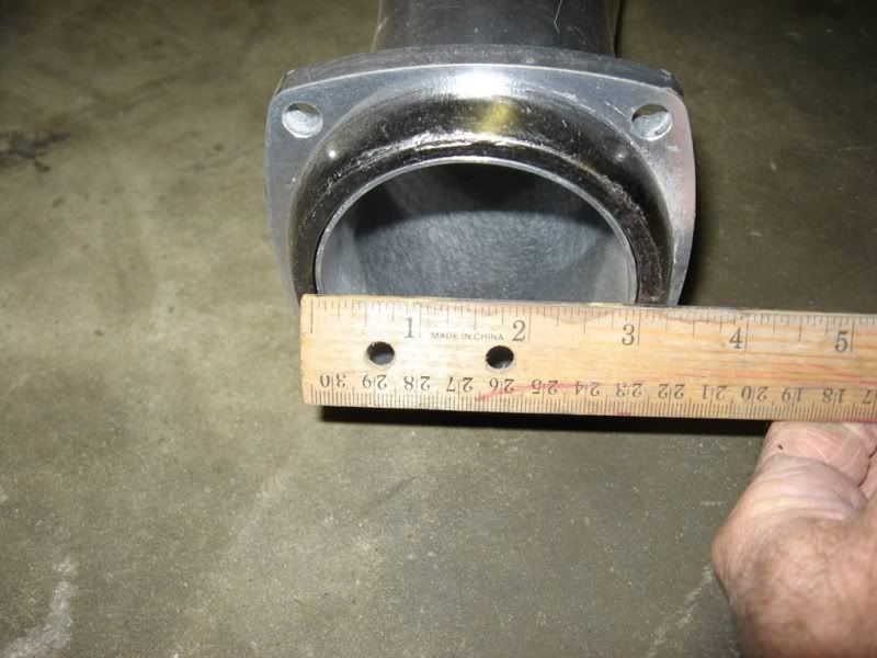

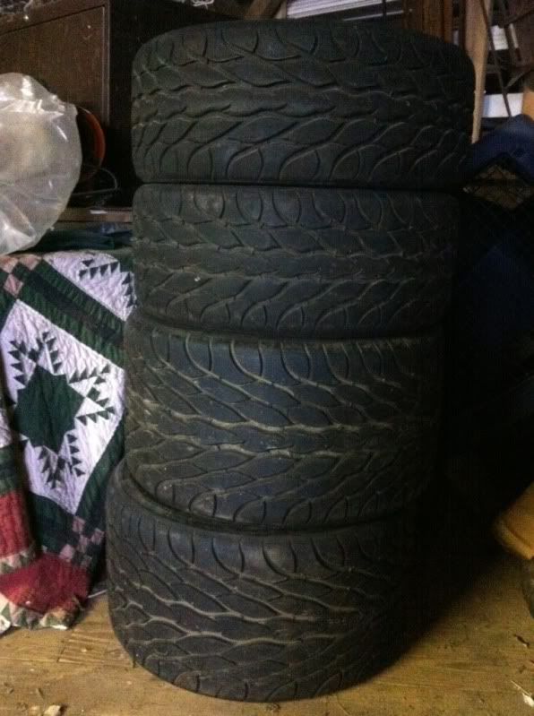

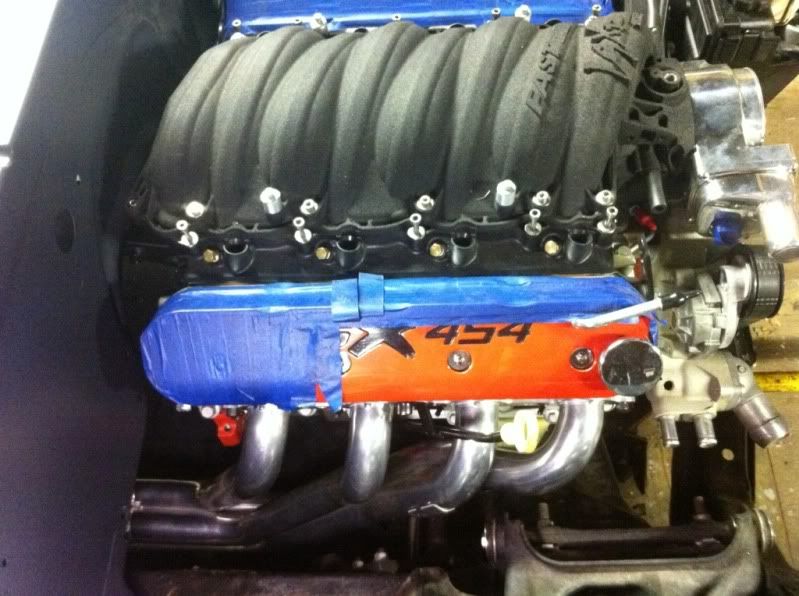

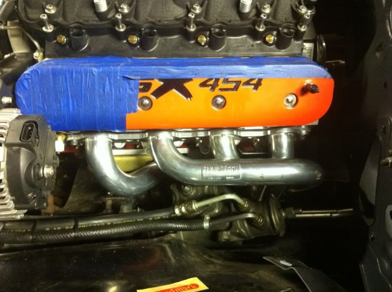

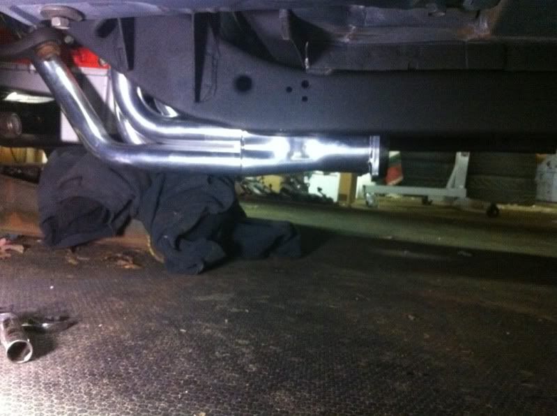

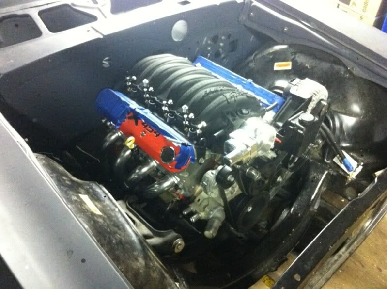

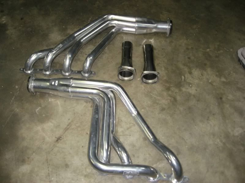

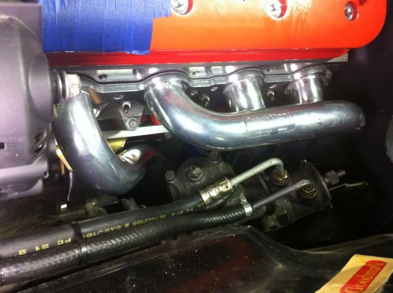

Not too much going on atm. Ridetech was selling tires so I bought a used set or bfgoodrich KDW for a killer deal. 335/30/18 for the rears and 235/40/18 for the fronts. Going to try to get the rear wheels/tires mounted this Saturday, then get a good measurement for the width of the rear. In other news a good deal came up for a set of dynatech headers so I bought them. A good friend of mine came over and gave me a hand on getting the headers mocked up to see how they sit. Overall for the price I'm very impressed. The clear the steering box with ease. The one tube is slightly touching the mount, but that's nothing a little grinding won't fix. Here are some pictures for viewing pleasure. More to come soon..

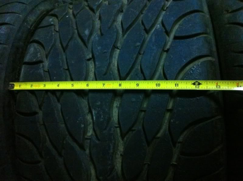

Got over to the car this weekend for a bit and got my rear tires mounted so I could get a measurment for the rear. I came up with 55 1/2 from wheel to wheel. I have to subtract out the other stuff also. Does this seem correct to you guys? The wheels are 18x12 w/ 5.75 of backspacing or -19 offset. Im guessing my final rear width will be somewhere around 54 1/2....sound right? Here are some pictures as no one likes reading..

My axle flange to axle flange is 52-1/2 with 19x12 w 5" back space. Not counting the rotors.
