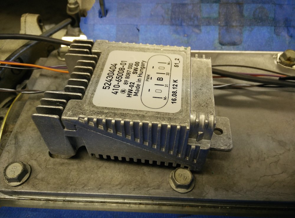

I picked up a C6 fan controller. It is definitely huge, but surprisingly light:
http://www.pro-touring.com/~andrewb/cougar/168.jpg
Andrew
