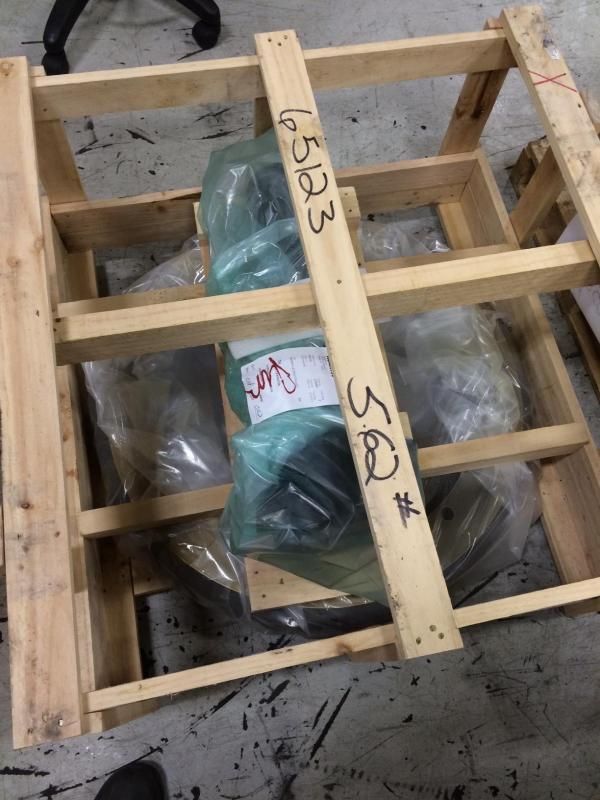

Not really an update, but I think I may have found some rear calipers.
http://i115.photobucket.com/albums/n...psabd68fa6.jpg
You won't see these at SEMA.. HAHA
Originally Posted by HEEP (Post 578876)
Scott, they are about 18-20" long. they go on a final drive brake for a large Komatsu machine. Not sure which one just yet. I am working with our Reman facility on a special project at this point, and those get rebuilt here. Kind of impressive for the process here.
Got two weeks left of a six week stint here. Really missing my family at this point.
:confused59: :confused59:
Those look HUGE!!! More specs please :confused18:
Wow six weeks that's a long time to be away from your family, how far away are you, do you get to go home on the weekends?
HEEP 11-05-2014 05:22 AM
rick, they are 21" overall length. The pistons are " and 2.75" diameter and are six piston. They are for a Komatsu HD785 mining dump truck.
As for being away from the family, yes, it has really gotten to me this week. I do get to go home on Friday, and then return on Monday around 11. About 4.5 hrs away from home. Ready for a home cooked meal every weekend. I've had two Japanese men here with me for most of the time. One went back to Chattanooga to discuss my new roll within my company. The other is still here with me. He doesn't speak English as well as the other. Communication has been fun. He does love my truck, and Cracker Barrel. HAHA
