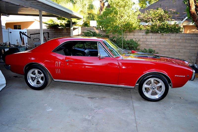

rickpaw 03-15-2013 10:48 AM
Here's my 67 Firebird. I tackled everything (sheet metal work, body work, final assembly). The only things that were sent out were final paint and engine machining.
http://i616.photobucket.com/albums/t...9_23_08002.jpg
http://i616.photobucket.com/albums/t...w/DSCN0506.jpg
http://i616.photobucket.com/albums/t...ofDSC_0030.jpg
http://i616.photobucket.com/albums/t...ofDSC_0111.jpg
http://i616.photobucket.com/albums/t...t/P1000007.jpg
http://i616.photobucket.com/albums/t...w/P1020116.jpg
Prior to this, I have not done any welding or bodywork. Kind of dove in head first.

garyb 03-25-2013 09:47 AM
Maybe a dumb question, but on your picture that shows the 'new' quarter screwed in place for tack/welding, I noticed the screws are on what's left of the existing quarter. Are the two overlapped as in lap welded? I've always wondered. I know when I did my trunk pan, I overlapped, used metal screws to hold in place and used an air body saw to cut through the old and tack as I went along.
rickpaw 03-25-2013 09:58 AM
The two were overlapped, but I cut the overlapped pieces and butt welded them together as I went along. I used a black marker to draw up the cut lines. You can see it in the picture. Afterwards I went back and welded up the screw holes.
Tu
