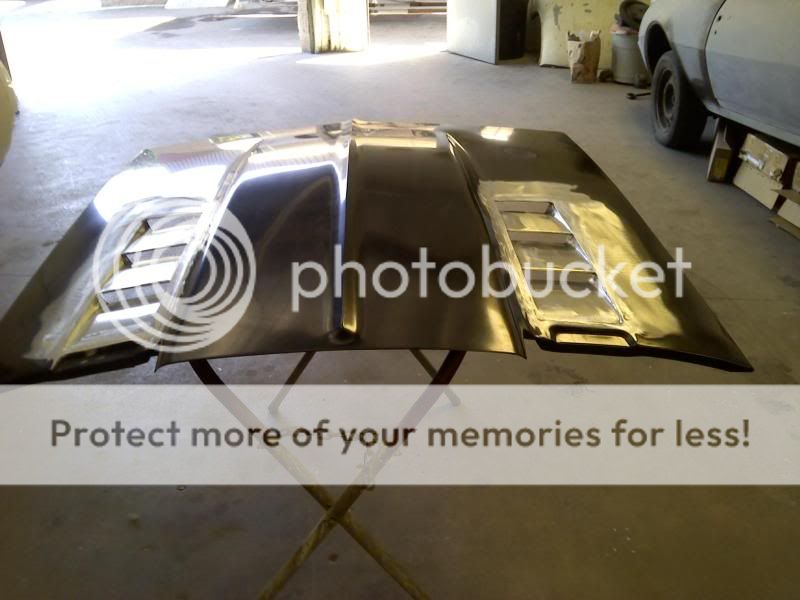

So I was going to keep a couple things a bit of a secret, but when Dick sent me this picture I just wanted to share it. Keep in mind it isn't done, and several parts of the design will be tweaked before it goes to paint, but even now I don't think it looks half bad.
http://i366.photobucket.com/albums/o...SA/Unnamed.jpg
Matt
GregWeld 09-03-2010 02:34 PM
Matt -- That's funny -- Squealin' on yourself!
Looks good!
tones2SS 09-03-2010 03:13 PM
Nice hood Matt!:thumbsup: :cheers:
Gandalf 09-03-2010 04:42 PM
Saw it at the shop today Matt - looked real nice. However, you can't have a hood like that and NOT have a twin-turbo setup wanting to be cooled by those vents!
I'm just sayin'. :-)

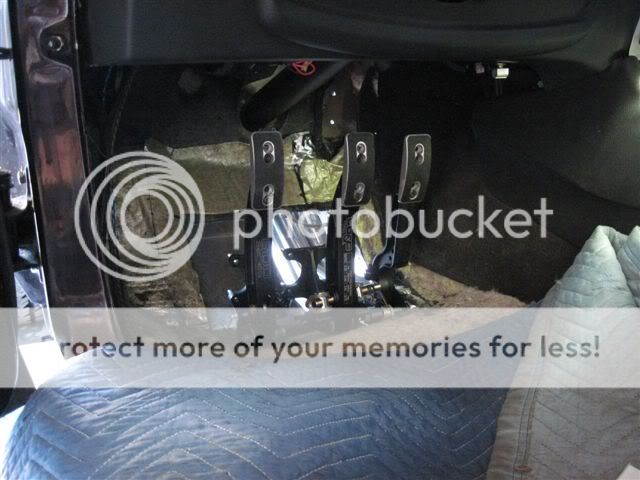

Oh, I almost forgot to mention something, I just bought a set of these pedals: http://www.summitracing.com/parts/TIL-72-603/?rtype=10
they'll require a little bit of fabrication work, but we're going to be putting down bars (is that the right term?) on this time so we're modifying the firewall anyway. I'm a little surprised I've only seen Tilton's pedal assemblies on a few cars, because this setup is uber trick. Everything is adjustable from the pedal ratio to the to the position of the throttle cable linkage and position of the pedals. I got it for two main reasons, the first being that I hated the Lokar gas pedal assembly, which pivots between the pedal and arm, and IMO just sucks. It's hard to heel-toe easily with it because when I roll my foot over it just moves the top of the pedal via the spring at doesn't blip the throttle. The Lokar pedal was also miles closer to the firewall than the brake pedal adding to the difficulties. The second reason I got it is because it provides different front and rear master cylinders, so I can run a 7/8 front and 15/16 or 1" rear m/c to hopefully alleviate some of the knock back feel.
Matt

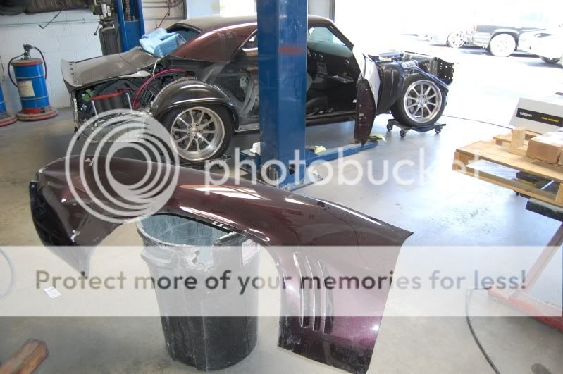

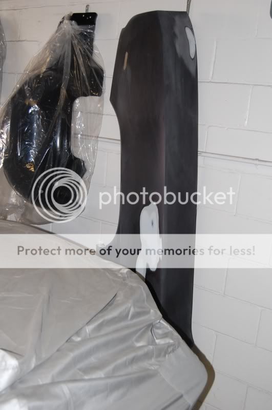

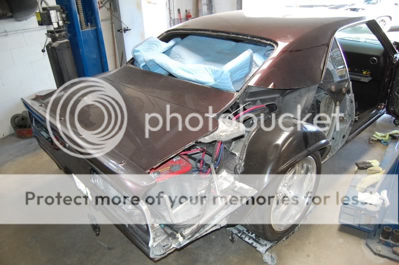

Matt@BOS 09-24-2010 03:02 PM
We've been making some good progress on the car, and we intend to have the car done in mid November in case we happen to win Muscle Machine of the year. I never figured in a million years that we would ever be in the running for such a thing when we got this car several years ago.
Dick has been thrashing away on this car, and it will be coming together pretty quickly. It's kind of like last year all over again.

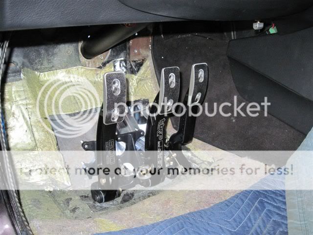

Dick and I (mostly Dick) have been trying to figure out the floor mount pedal, and it looks like they are going to be a royal pain. The clutch master needs to go exactly where the frame rail bends up on the subframe. In order to be close to making them work we're going to have to have the drivers seat way back and move the steering column closer so everything will still be within reach. I might have to go with a set of hanging pedals if everything fails.
*edit* found some pictures of the pedals.
http://i366.photobucket.com/albums/o...SA/shop044.jpg
http://i366.photobucket.com/albums/o...SA/shop043.jpg
Matt

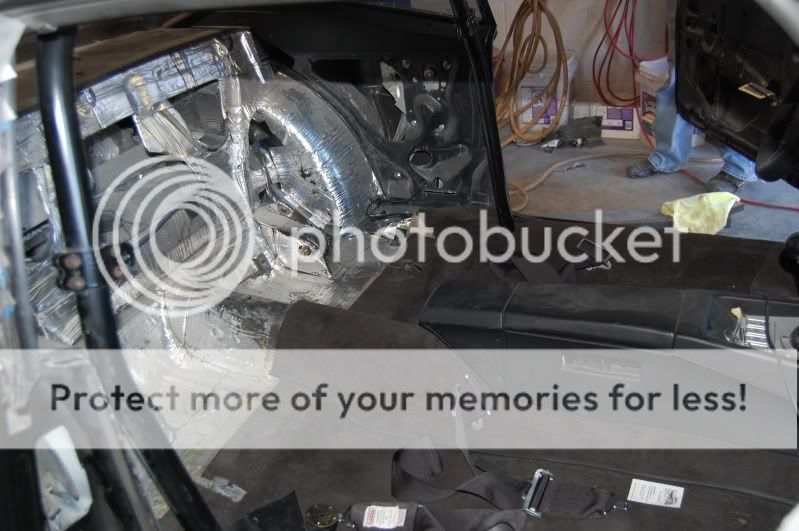

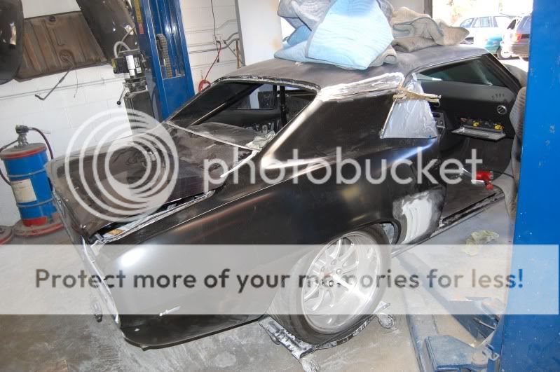

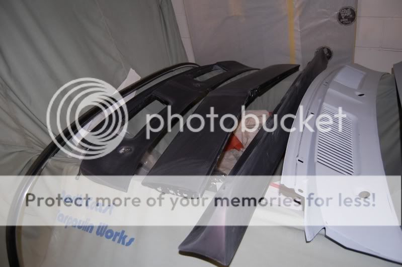

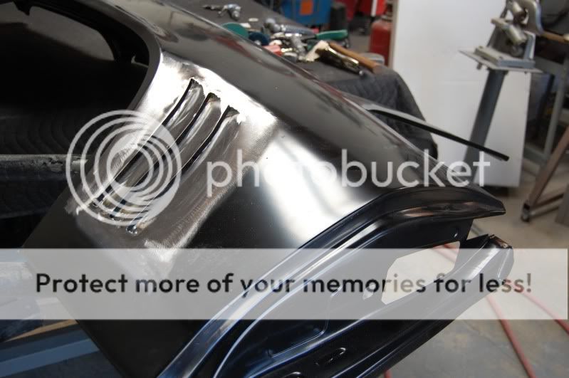

Update: More progress from the end of last week/weekend. After pulling out more of the interior my usefulness is approaching its end. Luckily though, Dick is ready to fit the quarter, and soon it is off to the paint shop. In fact, someone has already been busy prepping parts...
http://i366.photobucket.com/albums/o...A/DSC_0712.jpg
http://i366.photobucket.com/albums/o...A/DSC_0713.jpg
http://i366.photobucket.com/albums/o...A/DSC_0715.jpg
http://i366.photobucket.com/albums/o...A/DSC_0716.jpg
http://i366.photobucket.com/albums/o...A/DSC_0720.jpg
and of course, your daily dose of carbon fiber: http://i366.photobucket.com/albums/o...A/DSC_0718.jpg
Matt
