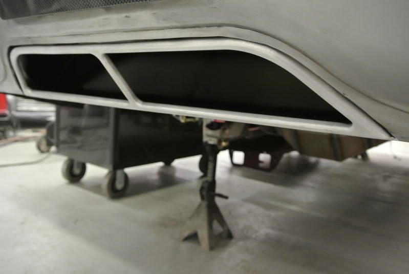

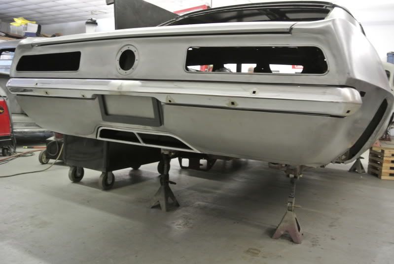

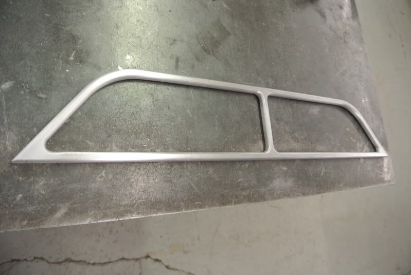

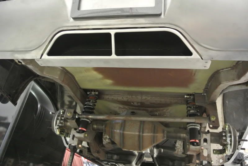

BBT FAB 06-08-2012 01:44 PM
update:
http://i32.photobucket.com/albums/d3...l/DSC_0354.jpg
http://i32.photobucket.com/albums/d3...l/DSC_0360.jpg
http://i32.photobucket.com/albums/d3...l/DSC_0361.jpg
http://i32.photobucket.com/albums/d3...l/DSC_0362.jpg
http://i32.photobucket.com/albums/d3...l/DSC_0363.jpg
-troy

That ass looks great Mario. What's the plan for the fuel tank?

Mario- Fab work is looking good.. I now have a better visual idea on exhaust opening you were try to explain to me. :thumbsup:

Thanx Todd! Troy is going to build a tank that will work with the exhaust .When Mike did the floor he took out the spair tire well so the tank will sit higher.
GregWeld 06-10-2012 07:39 PM
Just remember to allow for that old man HEAT which will make the exhaust grow bigger than you're you know what!
Frisbee managed to cause all manor of crap for me on the '32 with not allowing for that growth.

Thanx Josh !! I think this was my only design idea on the whole car.:lol:

The problem was that the "tip" was FIXED.... so all the nice "wubba" hangers didn't help - because the end was fixed solid. That's what I saw about the way your's is done. It appears to be bolted in place "solid".
Just tossing this out there to help.
BBT FAB 06-11-2012 09:57 AM
A flex joint will be installed at the rear of the exhaust to allow for movement.
-troy
DOOM 06-11-2012 12:08 PM
AHHH I see what your saying! Thanx Greg I don't even want to know what that repair cost you! But this is how we learn. And see my man is already on it! Its nice to know you have extra eyes out there you da man..
