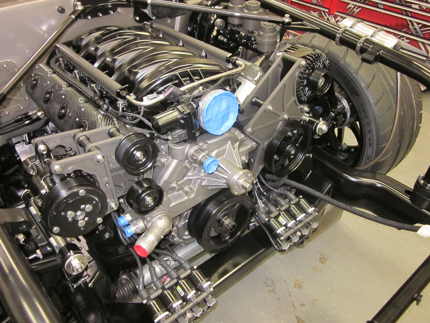

Cris@JCG 09-30-2011 05:48 PM
Ron- How about a few detail pics that you will never see.. That can speak in a few words...
http://i1015.photobucket.com/albums/...n/IMG_1580.jpg
http://i1015.photobucket.com/albums/...n/IMG_1581.jpg
http://i1015.photobucket.com/albums/...n/IMG_1582.jpg

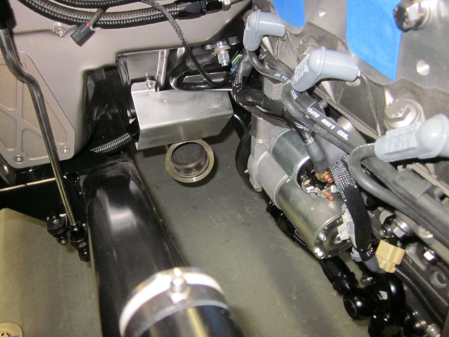

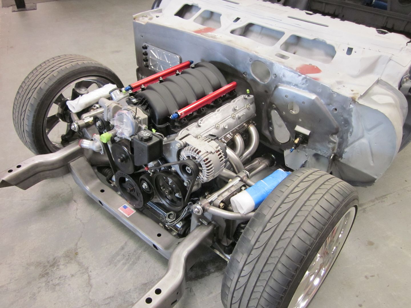

KILLER work! Have to be honest, don't like the oil lines right above the exhaust collector in that close proximity. Heat sleeve them at the least.

Cris@JCG 10-01-2011 07:48 AM
Thanks Todd.. It was not the ideal place for the oil lines but it was tough finding a spot for them especially where I placed the oil tank.. But I wanted the tanks feed point to be high so that gravity could keep the the oil feed to the engine.. Looked @ it last nite.. We will fab some stainless sheild to help with heat & keep direction of oil from falling in top of the header if we ever get a leak..

Here we go Todd.. We did this this morning... the stainless will shield the heat & it will draw the oil to the sides if we ever get a oil leak..
http://i1015.photobucket.com/albums/...n/IMG_1593.jpg

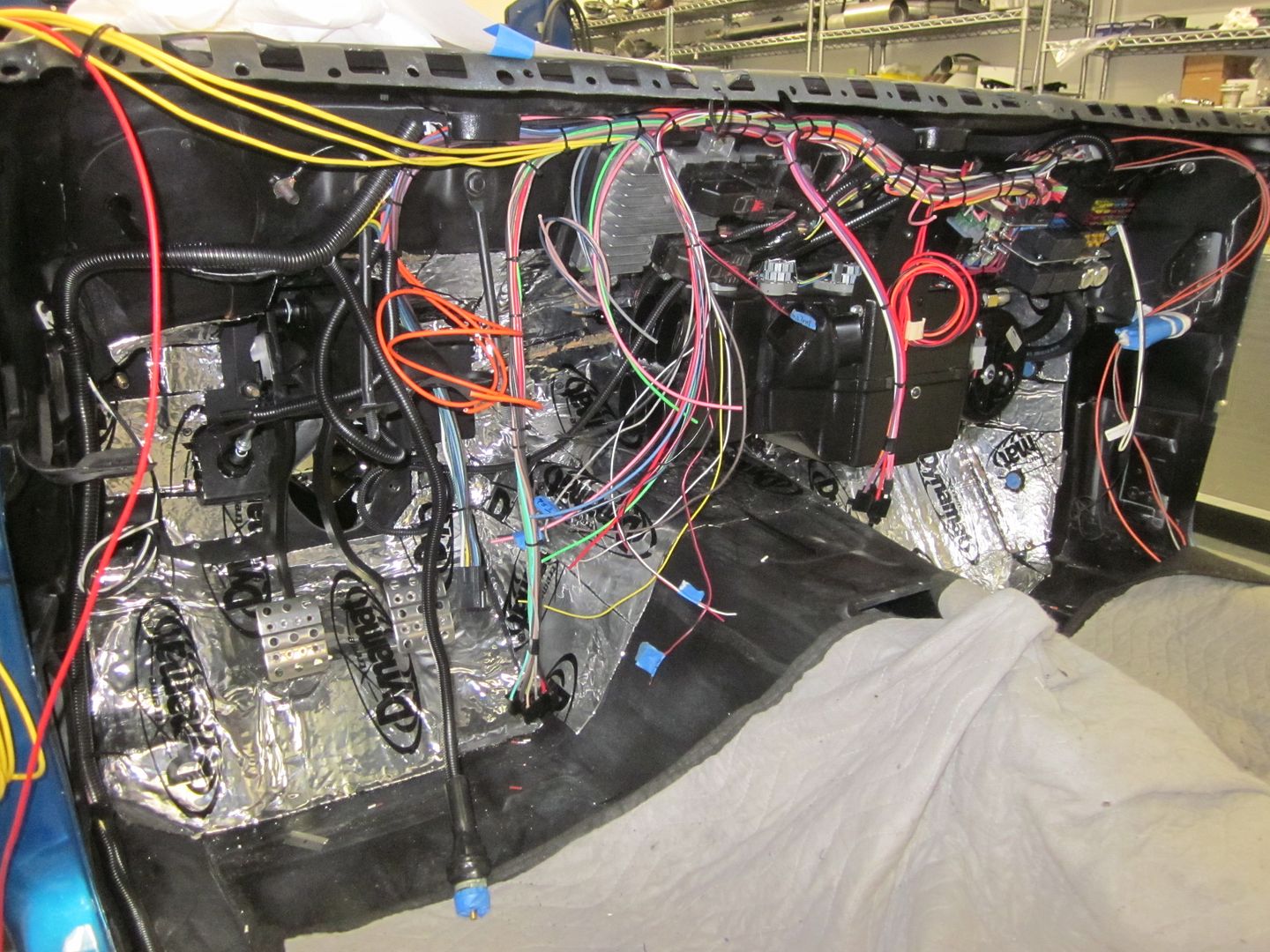

So underdash wiring pics...
http://i1015.photobucket.com/albums/...n/IMG_1594.jpg

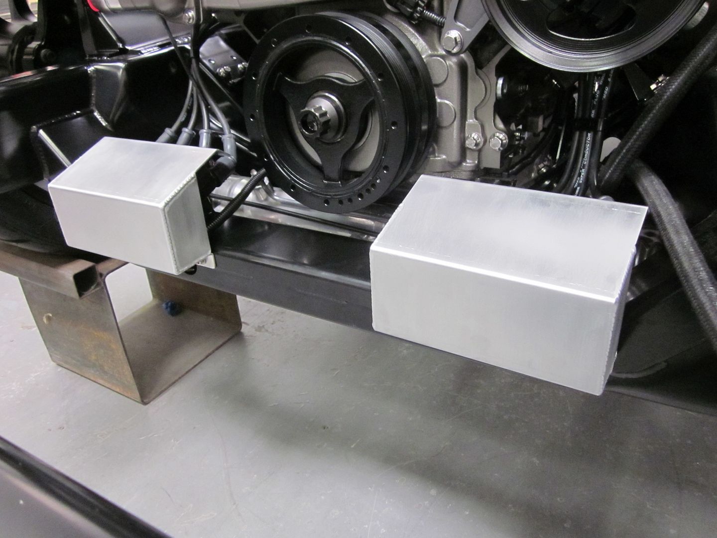

We are still hammering away on assembly.. I can't believe that I am still plumbing.. This morning we had to build another shield on the driver side to protect the cooler lines to the block...
http://i1015.photobucket.com/albums/...n/IMG_1600.jpg

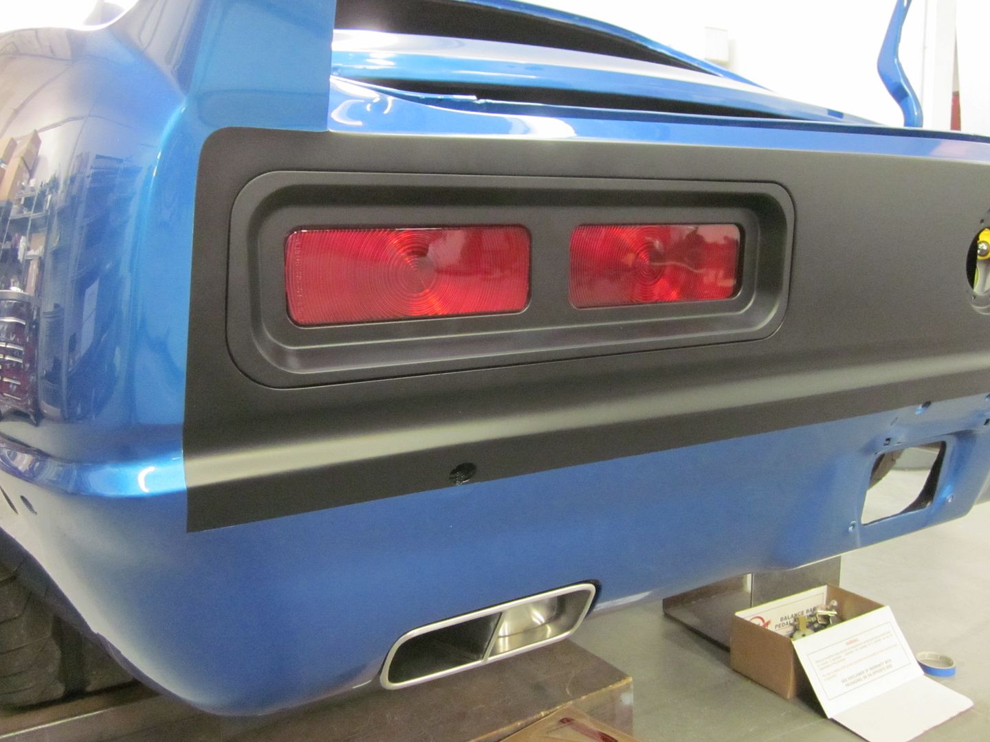

Cris@JCG 10-07-2011 06:25 PM
Thanks Guys! Please make sure you stop by & introduce yourselves @ SEMA..

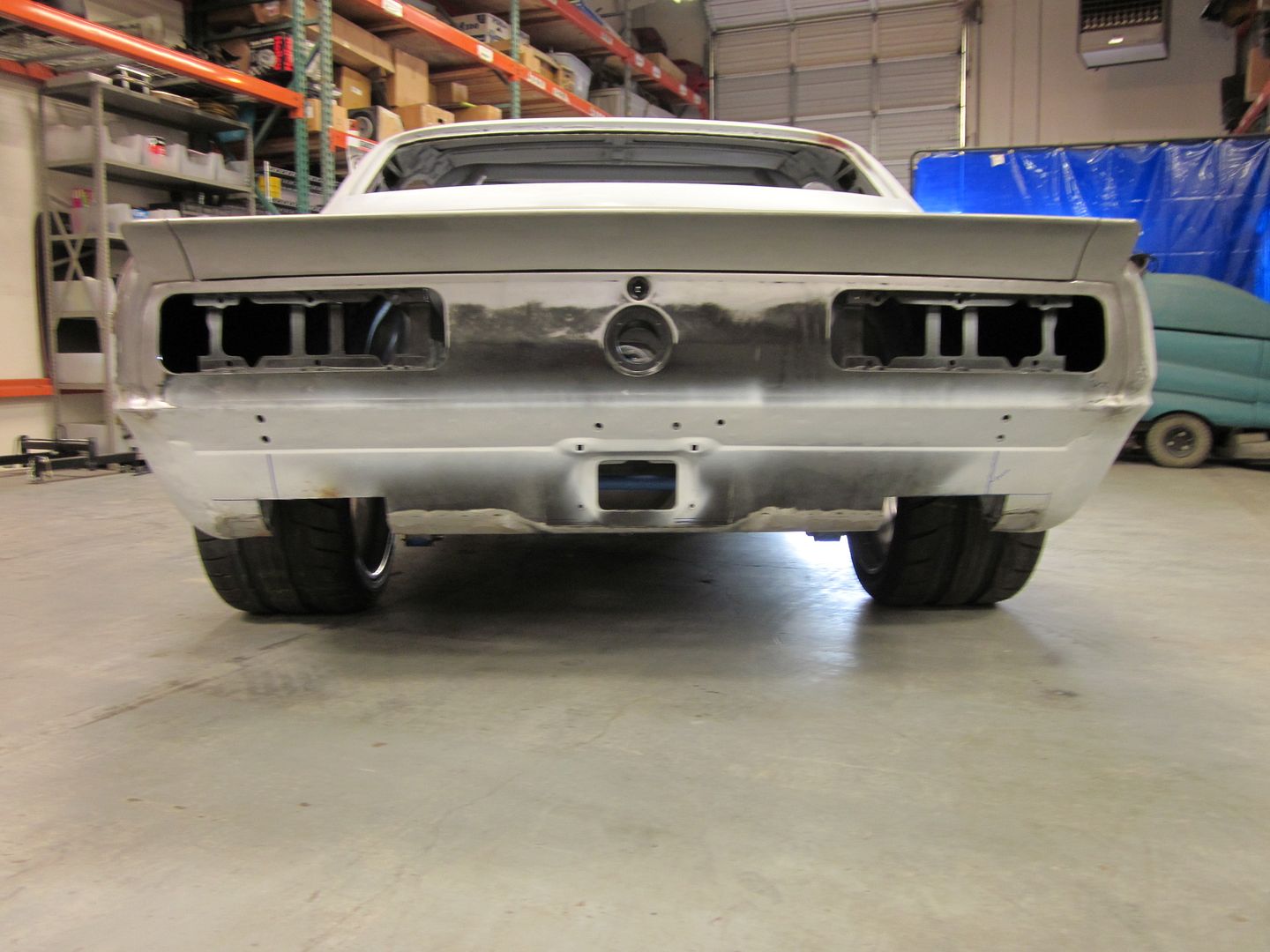

Here is a pic of our billet flush mount tail lights.. One of my favorite pcs. on the exterior..
http://i1015.photobucket.com/albums/...n/IMG_1604.jpg

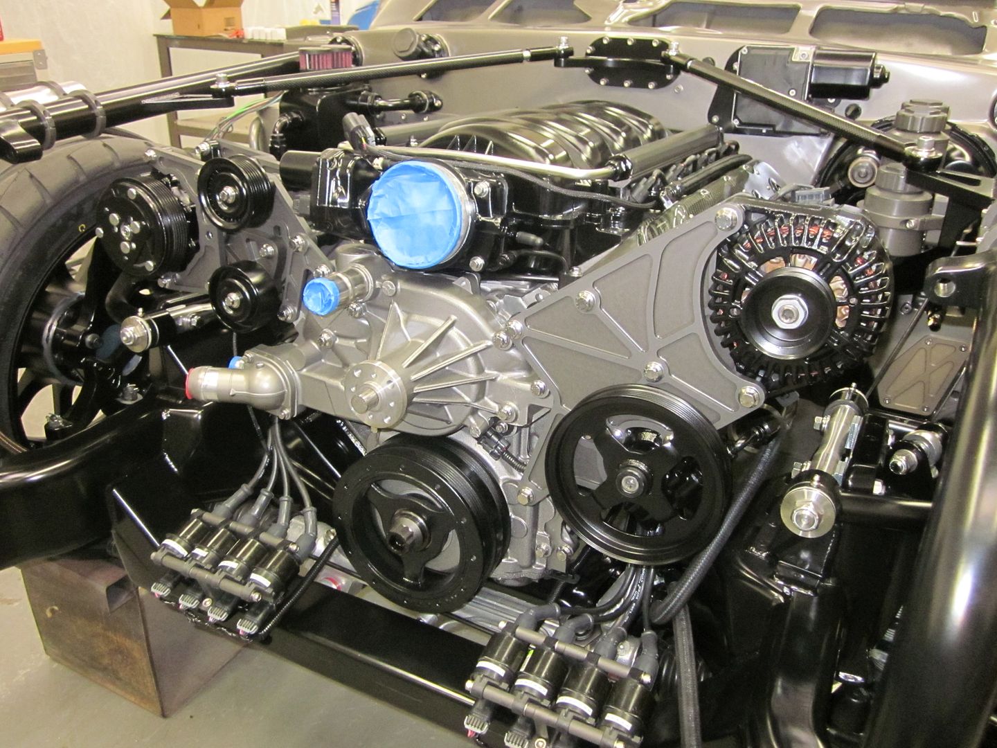

Car looks amazing! I almost went with a similar location for my coils but decided to change it for fear of throwing a serpentine belt and slicing the plug wires. I know it is rare to break a belt but...
Cris@JCG 10-07-2011 07:55 PM
I can understand your reason for not putting the coils in my location.. I was more worried about getting caught in a rain storm.. So, we built this covers to protect the coils from getting wet.. We need to paint them black..
http://i1015.photobucket.com/albums/...n/IMG_1595.jpg

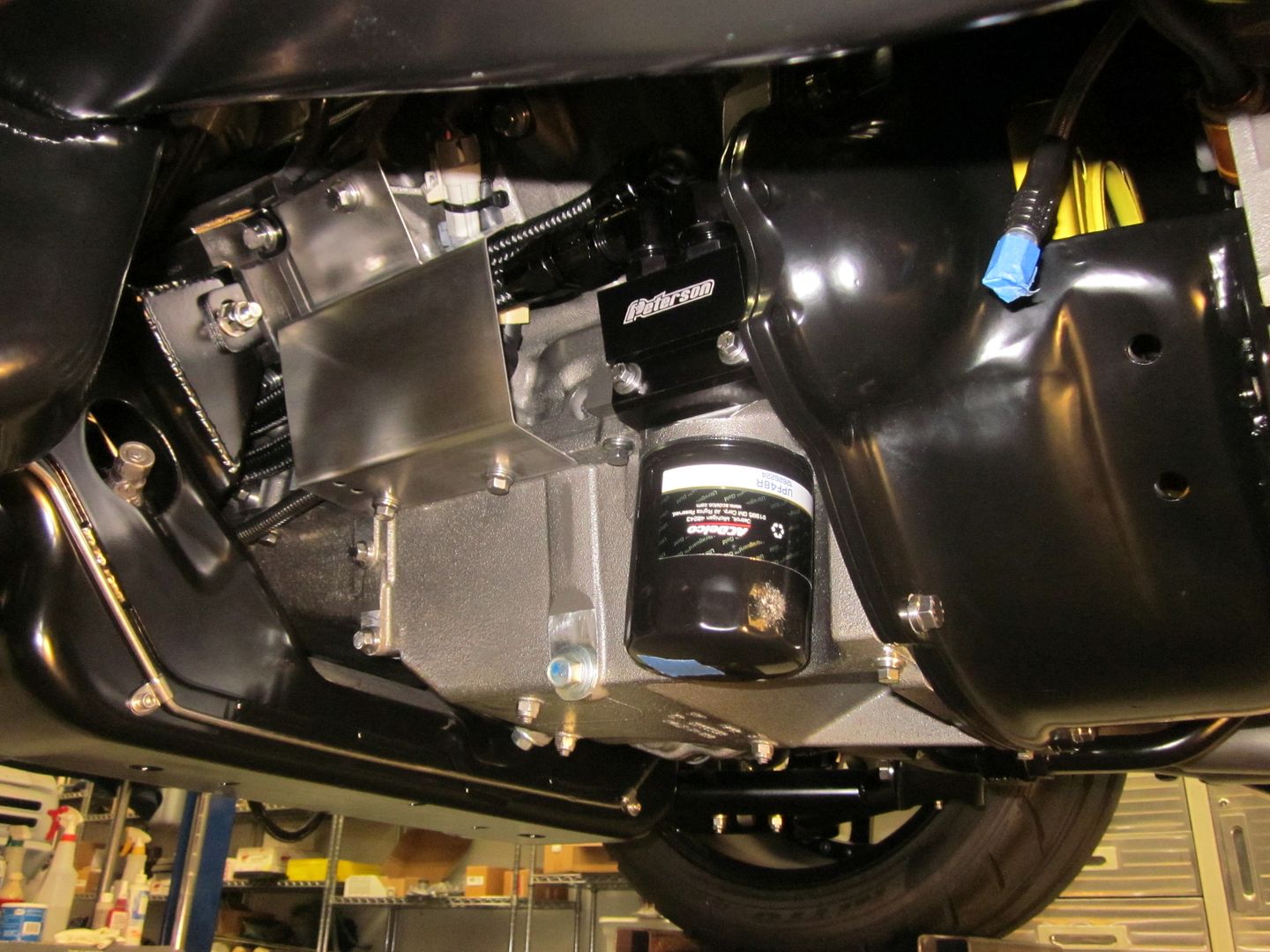

Here is another pic of a shield we built for the oil lines on the side of the block plus it also keeps heat away from the wiring for the engine.. Take a look @ the bottom of the bellhousing.. It is a Mcleod.. I knew we were going to run the car low.. the lower portion of the bellhousing was the lowest point.. so we grabbed a stock f-body bell housing & a modified it look like the stock one.. Plus a notch for header clearence..
http://i1015.photobucket.com/albums/...n/IMG_1606.jpg
Vince@Meanstreets 10-07-2011 10:16 PM
nice touch on the bell, what oil pan is that again? stock f body?
Cris@JCG 10-08-2011 07:08 AM
STock LS7 oil pan with a Aviaid Oil Pan Baffle Kit...

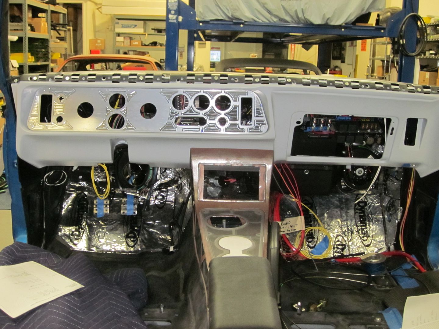

Cris@JCG 10-09-2011 06:59 PM

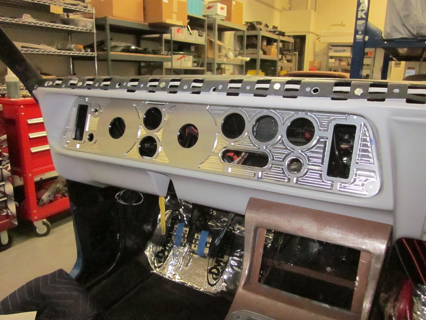

My machinist just brought the dash plate over to proof fitment..
This dash is going to lay out just right for function & sight!!
http://i1015.photobucket.com/albums/...n/IMG_1609.jpg
http://i1015.photobucket.com/albums/...n/IMG_1610.jpg
