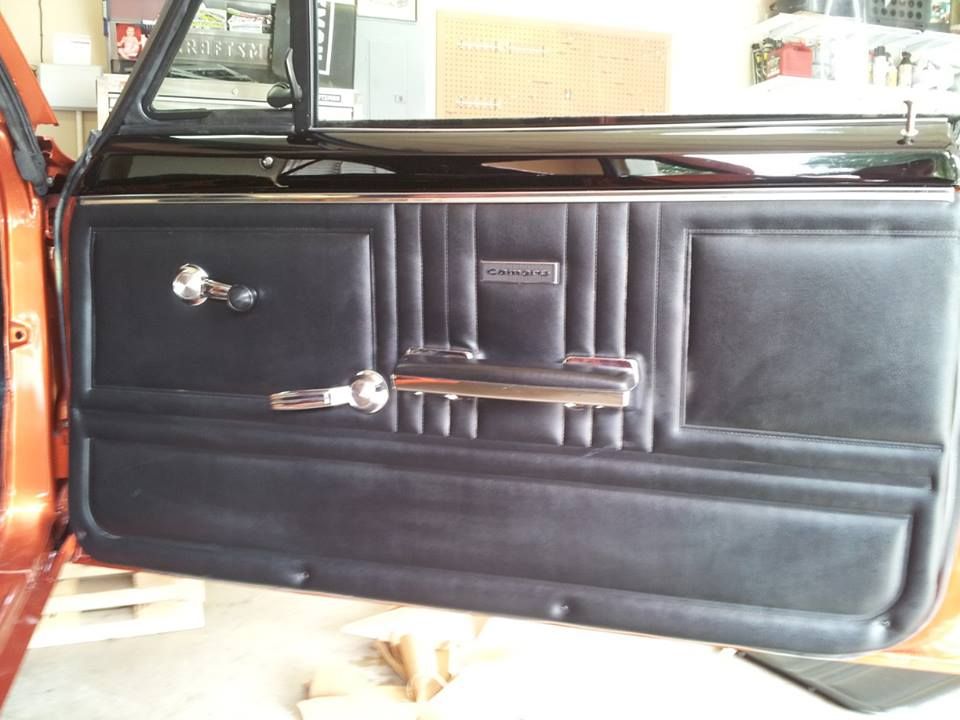

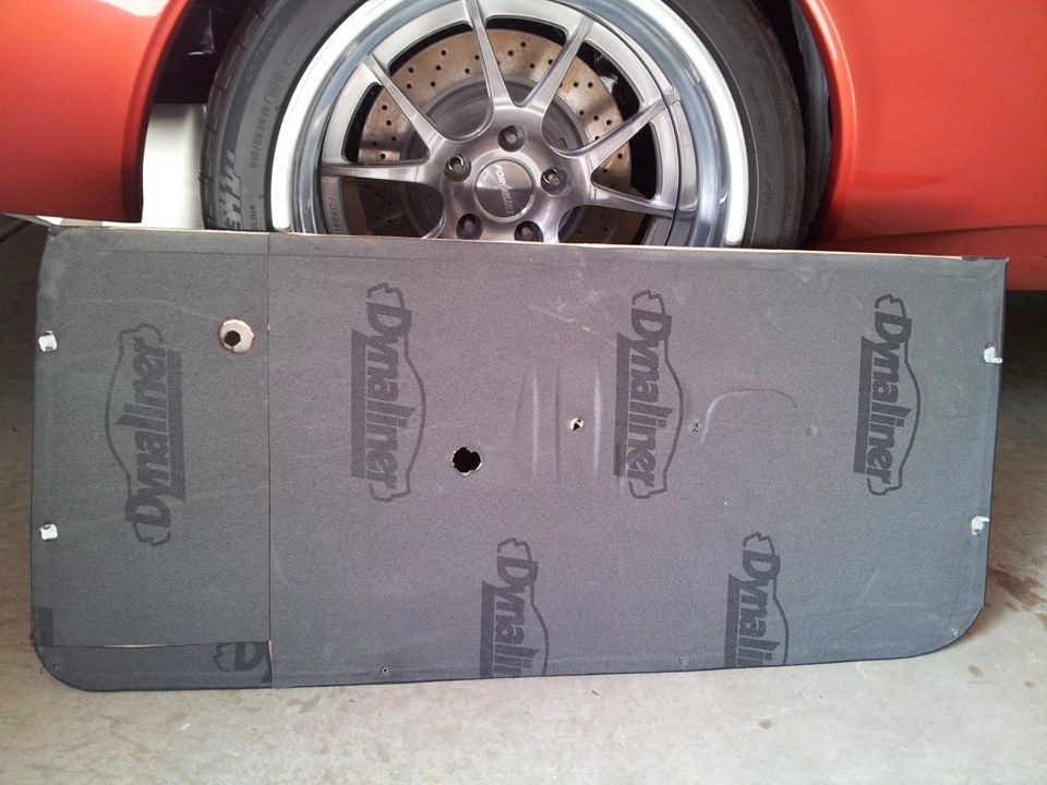

dynaliner installed on the panel. The inside of the door is dynamated. I used one sheet for the door. I didnt feel the need to cover the entire inside of the door. Dynamat is a vibration dampener so this should do. You can tell a difference already just knocking on the door

Heres a short video of the dynamat door Vs non dynamat fender. Its hard to tell in the video but in person OMG there is a huge difference. As far as the dynamat goes i did not cover the entire inside of the door. I cut each sheet in 4" strips and installed it that way leaving a little gap between each sheet. I was able to use one sheet of dynamat per door even adding some on the sides and the front of the door.

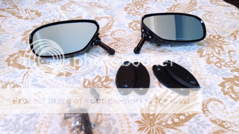

Murakami Motors sells a set similar to those but with a price tag close to $500. Being on a budget I decided to try my luck on finding a used set of Magical Racing mirrors from a motorcycle forum. Sure, enough my patience paid off and I found a decent set for a decent price.
http://i454.photobucket.com/albums/q...ps19e7e0b2.jpg
They had type 1 mirrors with type A bases with an elbow and a 45mm stem....everything I needed.

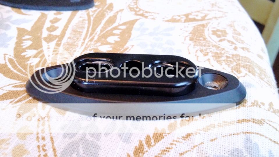

Next came the SlickAuto Miata bases. You can purchase just the Miata APR mirror adapter kit separately without the mirrors for $90.
http://i454.photobucket.com/albums/q...ps93271292.jpg
SlickAuto mirrors bases comes with two smaller holes for the mounting of the APR mirror base. I decided to use the threaded hole closest to the driver to mount the Magical racing mirror. The same way the Garage 502 mirrors are off center so they can be clearly seen and not blocked by the triangle pillar on the window.
You can use the magical racing mirror base and mount it on the SlickAuto miata bases but I really hate the way they look stacked on top of each other. I wanted a cleaner look so I went the extra mile.

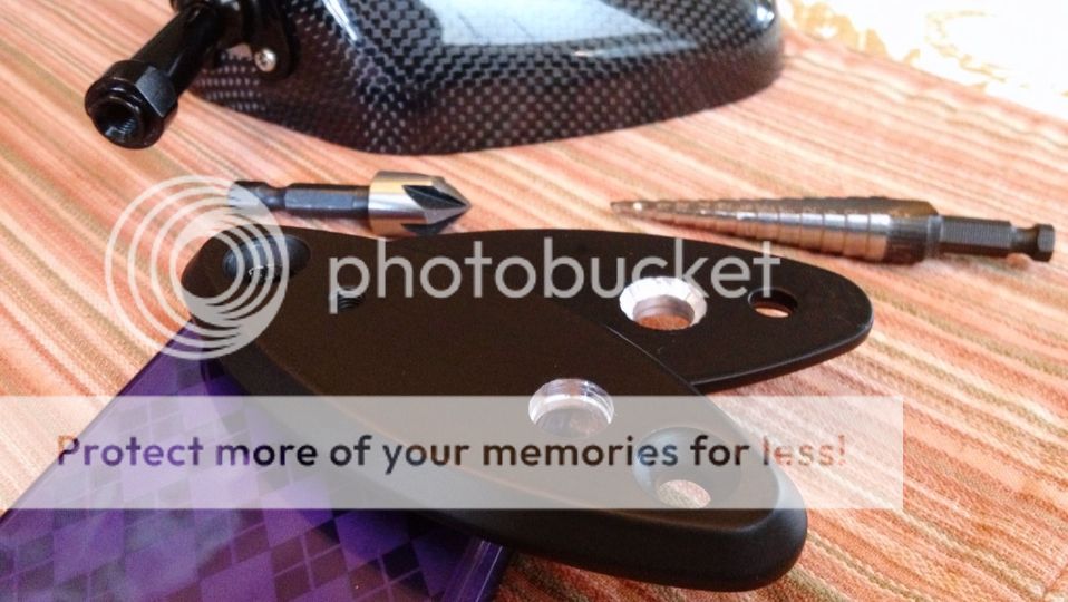

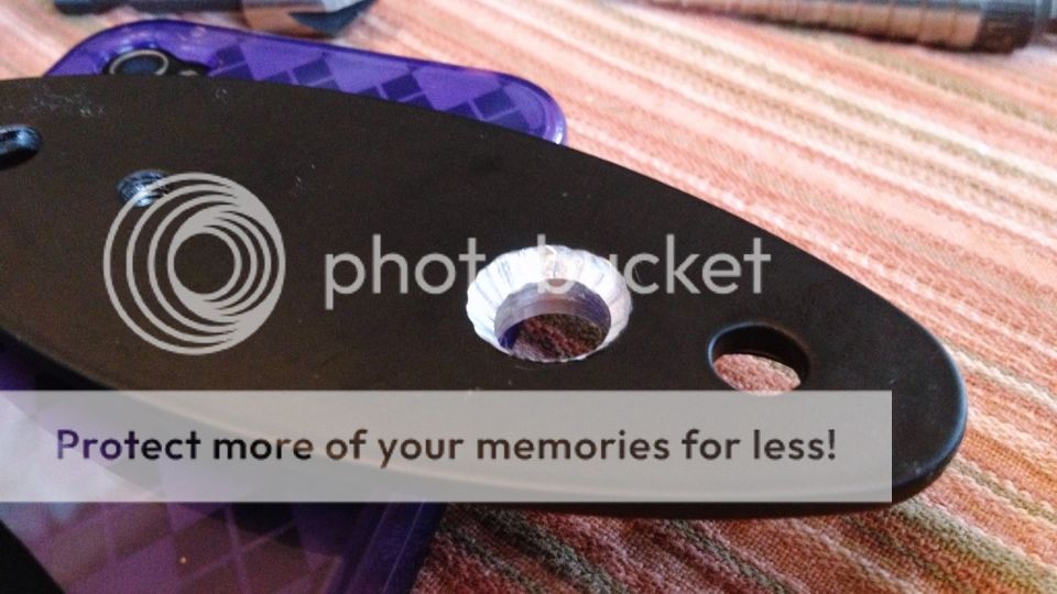

http://i454.photobucket.com/albums/q...psb1cf2532.jpg
10 mm hole is needed for the Magical Racing stems. The underside of that same hole needs a countersunk hole. 1/2" countersink drill bit took care of that.
http://i454.photobucket.com/albums/q...psf48c6b9f.jpg
http://i454.photobucket.com/albums/q...psf65acca5.jpg
http://i454.photobucket.com/albums/q...psdb06c04c.jpg

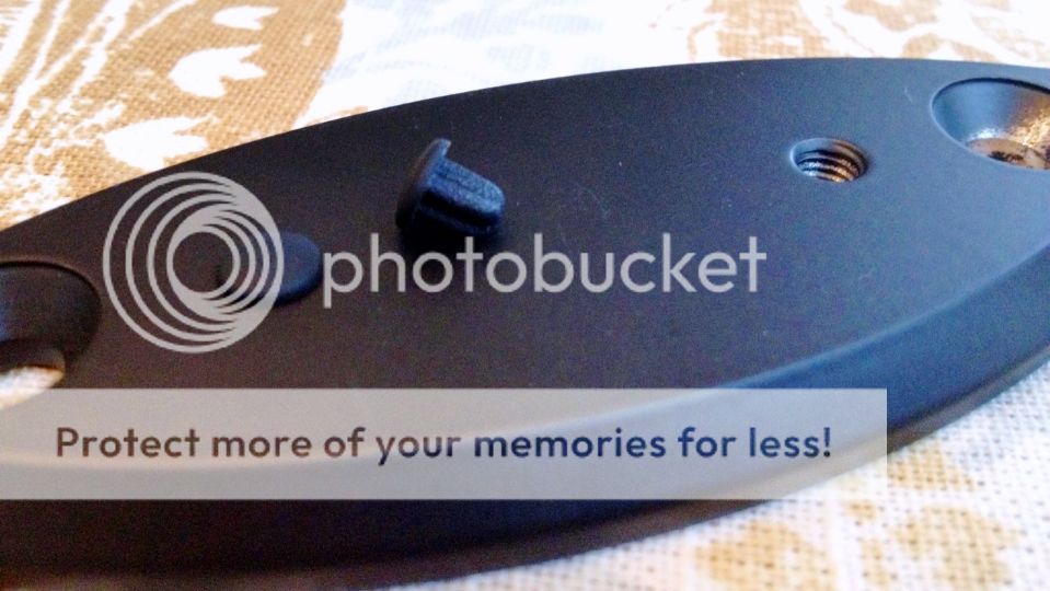

For the extra small threaded hole I purchased 3.5 mm stereo jack silicone plugs to cover the hole. It's a bit loose so glue will be needed to stay put.
