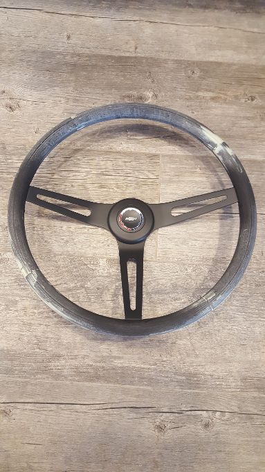

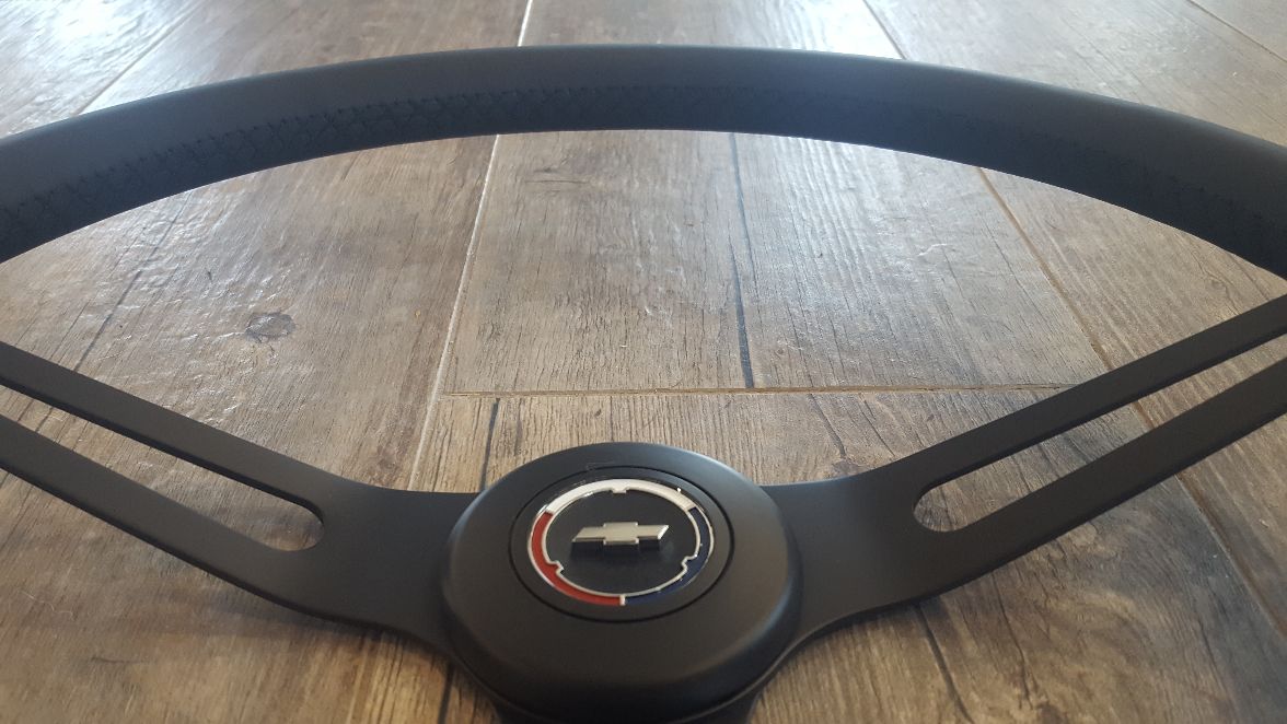

Here is the completed steering wheel back from GP Manufacturing. I am looking for a good place to send this to get a leather wrap if anyone knows of one.

Don't know where you're located, but send it to Lopez Custom's in California. That's where I sent mine. They are A-1. His son is Gabe's Custom's as well. Basically the same business so to speak. They did the interior on the 69 Camaro named Grimm 7.0. They also did the interior of the 55 Chevy named Brute Force too. Just naming a few of the top builds they've done to let you know the level of work they do.

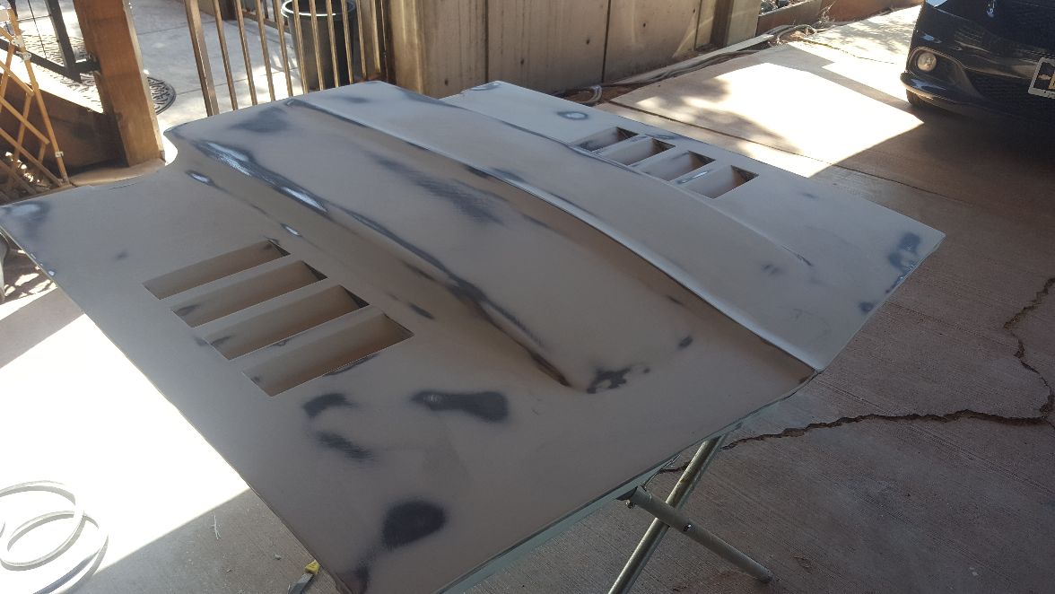

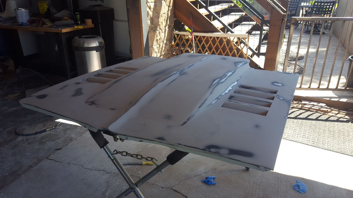

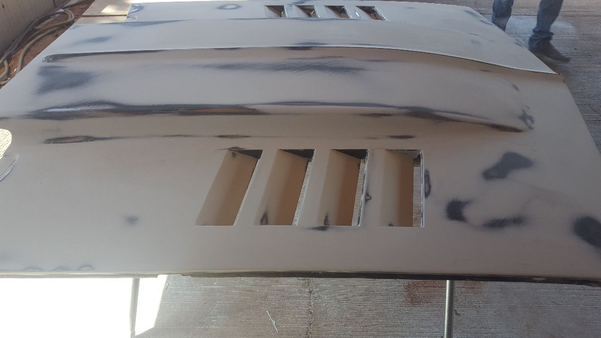

Top of the hood is now flawless with the Gray Area Steel hood louvers. Bottom is in epoxy primer and ready for body work.

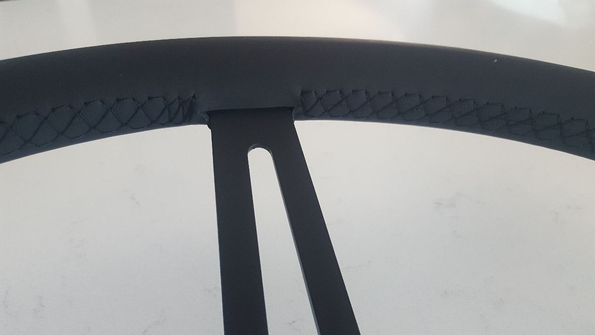

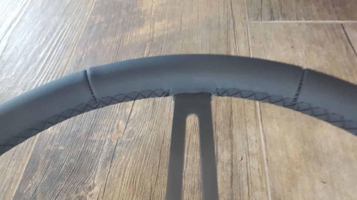

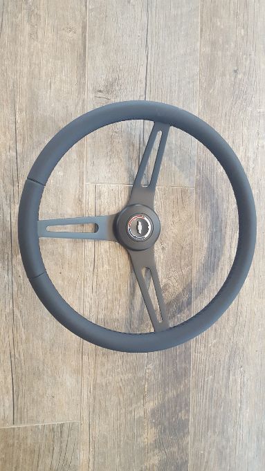

Steering wheel is back after leather wrap. The first people I contacted never got back to me so I found someone in Arizona. Instagram is steering wheel art and the only thing he does is cover steering wheels.
Attachment 77969
Attachment 77970
Attachment 77971
Attachment 77972

I would bolt the hood to the car and block it. It will change as soon as you have hinge pressure on it.

I like the hood adjusters on the truck. Slick idea but how do you plan for rain runoff? Do you plan on a drain tube? If you would off left a lip or seal it off flush. What’s your plan?

We had the hood on and latched in place with the hood bumpers set when we did the mud work around the edges. Took it off to work the center and underside. We will bolt it back in place to lay down the polyester primer, guide coat and final blocking. I have done a few builds over the years, nothing to this level. It still blows my mind how many times this car has been assembled, dis-assembled and re-assembled.
