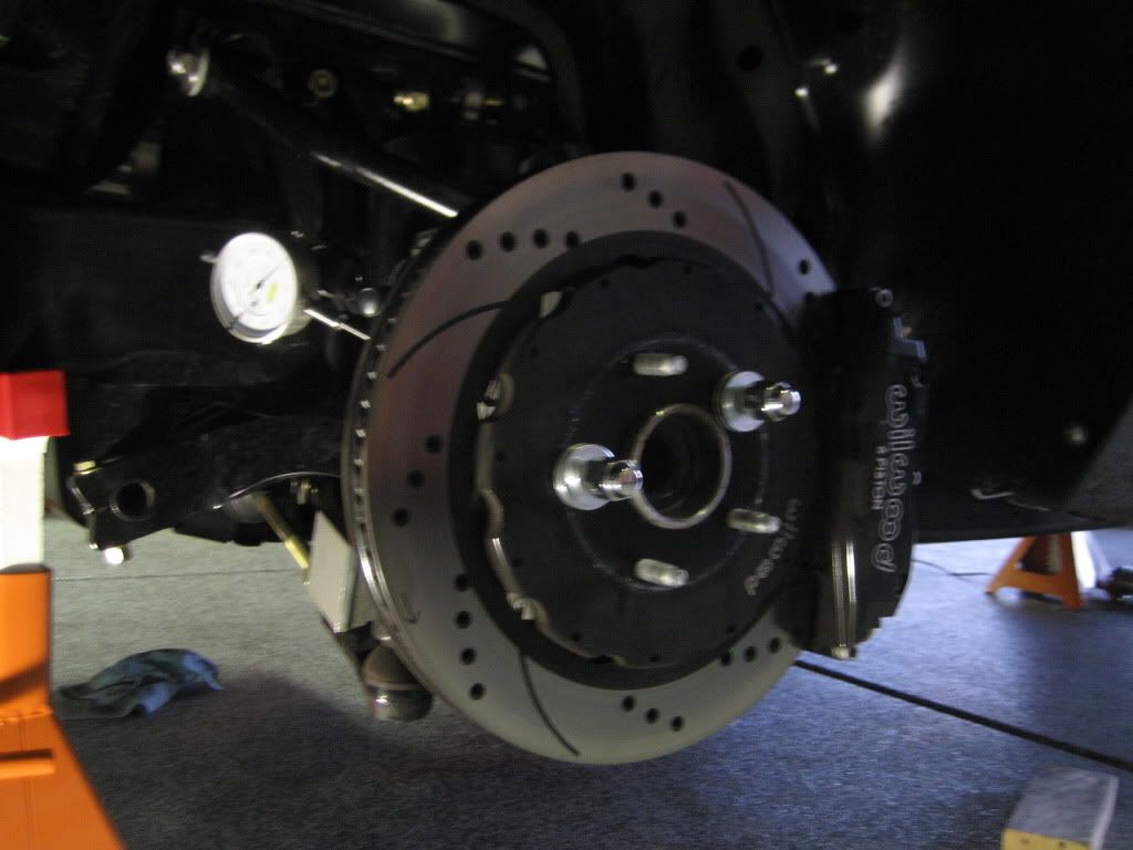

Still off the road waiting on some end links and a caliper. First batch was wrong. My last update included a residual valve to help with pad knock back I had during my first autocross. I've heard that it may not solve my issues. I hope it does, but I wanted to make sure it was the rear causing me issues. I also wanted to take some measurements with a dial indicator to find out just how much axle travel and bearing play I have.
LF .001 RF .001
LR .013 RR .010
I cinched down the rotor with lug nuts and divided the front measurment and used the whole rear measurment. I can definitely see with the added load of autocross how the rear end play could grow to at least double my measurments. I'm going to check specs on end play with moser.0 If my residual valve doesn't fix my problem, I'll be looking for some bearings that will give me less end play.

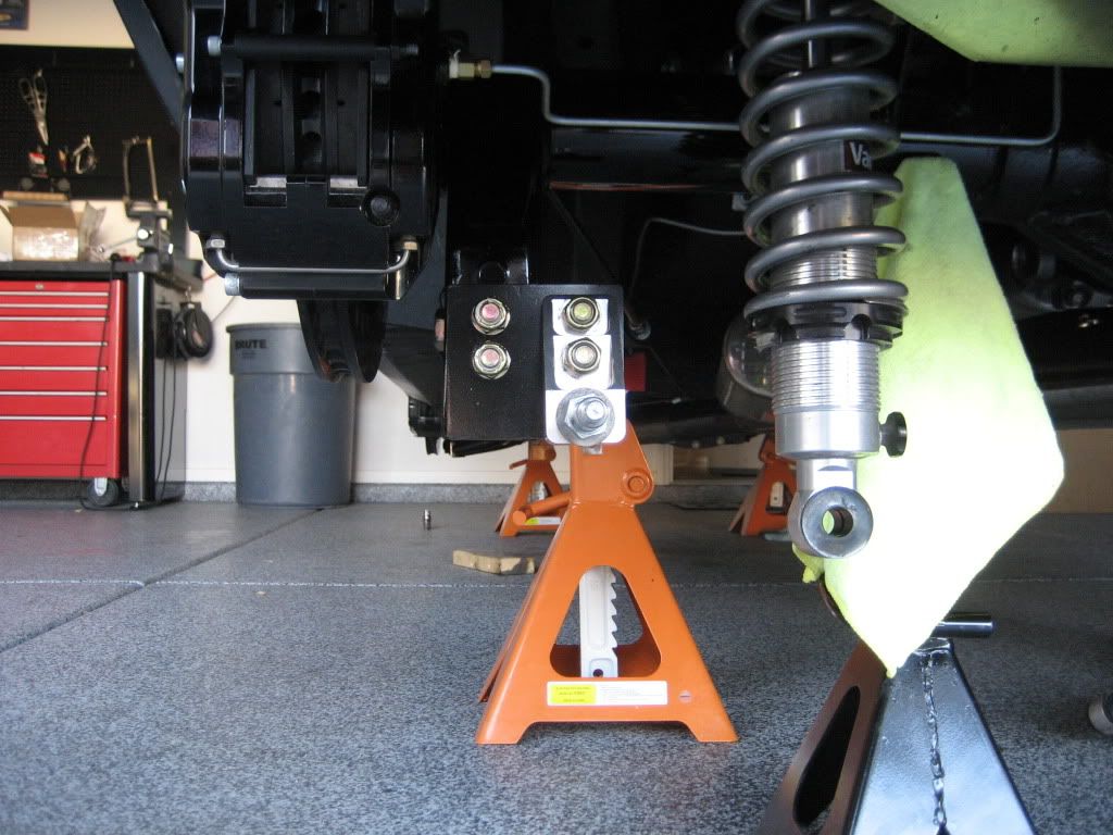

Vegas69 05-21-2009 06:39 AM
I sure did. They fit perfect. All business...1/4 inch plate with grade 8 bolts with nylon nuts.

BBC69Camaro 05-21-2009 02:32 PM
http://i200.photobucket.com/albums/a...1969/005-2.jpg
So is that a flat square plate that you bolt on that offsets the shock mount inboard? Any pictures unassembled? My lower shock mount is pretty close as well.

Ed...it's just 1/4 plate with rounded corners cut out of a water jet machine. I even had him cut the bolt holes with the water jet. Cost me under $30. The rear end housing is 1/8 plate. I'm not sure if it will effect the handling or have any other adverse effects yet. I do know that the stock setup will not work well in a racing or high load enviroment so you many as well change now. I really think it's axle end play that causes the issue now that I'm up to my eyes in brake pad knock back. It' really the easiest way to do it without any bind or a different length shock. I noticed the new G Link has the shocks mounted more vertical so that did give me the idea. I tried a set of mustand g bar lower shock mounts and the angle is off. I didn't snap any pictures before I mounted them. It moves the shock mount in 2". You could fabricate a new bracket that didn't move it in quiet as much but you would need to use a double sheer mount with a sleeve. I really don't think I'll experience any changes in ride or handling.

BBC69Camaro 05-21-2009 04:39 PM
Cool, be nice to see how it handles with that plate on it. Should fix any rubbing issues. I'll have to put that on my todo list. Thanks Todd.
Vegas69 05-21-2009 09:54 PM
Ed...don't cut those rotors just yet.
I found my brake pad knock back problem. I have to say I'm a little dissapointed in Moser Engineering and Wilwood honestly. These guys are in bed together and their products should work together. I figured out that I have .020 clearance between by bearing retainer and bearing outside race. So the bearing and rotor are sliding back and forth .020 before any bearing flex. I'll add a shim behind the bearing and it will fix it. I am going to call Moser out on the carpet in the morning.
