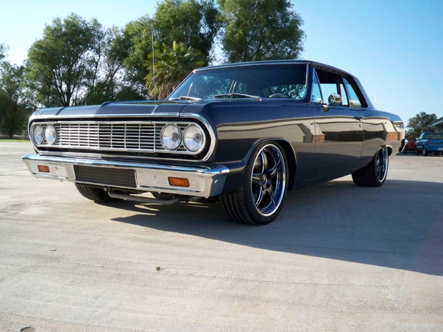

lots of responses, thanks to all. I got the car back from Jim in paint the end of February and it's been a thrash since then. I honestly thought it could be done even faster, but there's a ton of things that have to be done to put them together. I pulled this thing apart in a day or two, but assembly is a lot slower.
As fun (and frustrating at times) as this was I am very glad it's at the end of this journey. Got about a week to do the tune and fix any issues that may show up once I start driving. Hopefully this thing will quit fighting me now..................... :D
This build with the updates in a thread was a blast, and your comments and posts helped me a lot along the way. I definitely appreciate it and may have another build thread going in the not so distant future.

unfortunately it has to come up some. It's too bad, the tires clear fine and the exhaust is not an issue as is often the case. The damned trans pan is an issue, and I'd like a bit more clearance.
