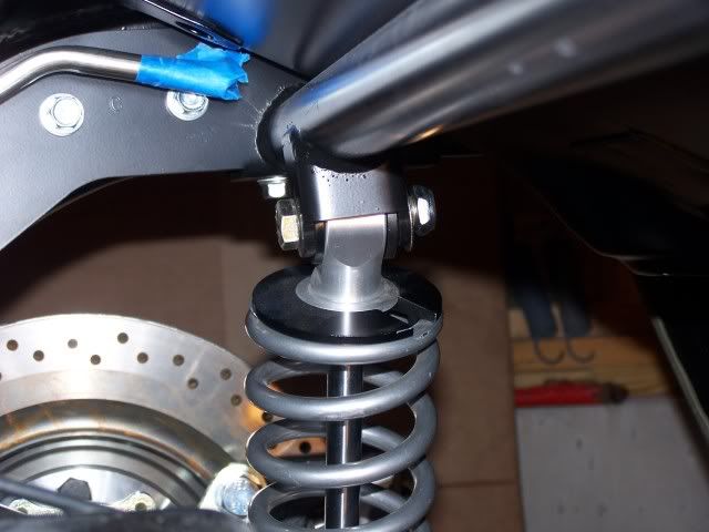

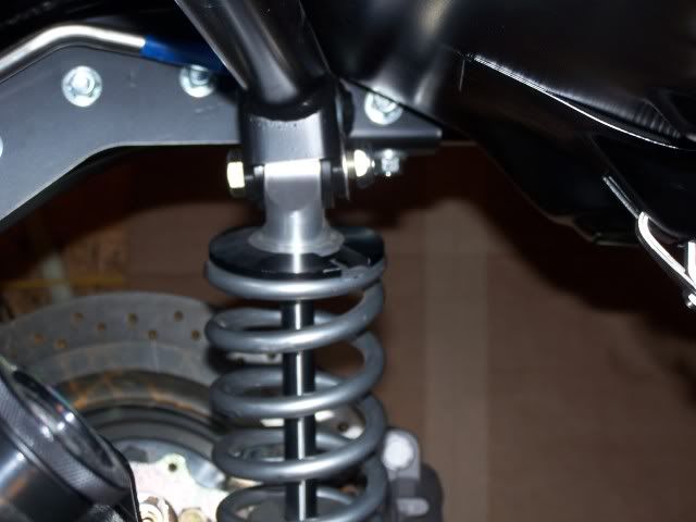

Thanks every body. Saturday I went out an finished the Dynamat behind the pedals on the fire wall. Today we started the wiring. We installed the fuse block and laid out some of the dash wiring.
We also put the rear end back in the car. We noticed the top shock mount looks like its not letting the bolt go straight through the end of the shock. I'll go take a picture and post it now.
If you look at the rubber in the shock mount where the bolt goes through you can see what I'm talking about. If I disconnect the bottom of the shock and tighten the top the shock will angle away from the bottom mount. Its like they are not in line with each other.
http://i172.photobucket.com/albums/w...S/000_1075.jpg
http://i172.photobucket.com/albums/w...S/000_1076.jpg
These two pictures are with the top and bottom bolts through but not tight.
I think its because the frame rails and the cradle have a little different shape where they mount together.
Let me know what you think.
Vegas69 02-27-2012 10:51 PM
That can be remedied by moving your rear end back or you pinion angle down. It's a little extreme for my taste. Clearly, I wouldn't move it if it's where it belongs. These setups should've never been engineered with a poly bushing. They need spherical bearings and that's another option if it ends up being a CAR problem.
Matt@BOS 02-27-2012 11:43 PM
Wayne, those last couple pictures remind me of a few other G-Bar/Prodigy bar setups I've seen. Dougie Fresh misted my car with shock fluid on a road trip, and it was because the shock had been side loaded. Gregg B (Gandalf) had a very similar issue, possibly the same issue. When Gregg was trouble shooting the issue, he was told to adjust it by changing the pinion angle, then by having different length control arms built if the former solution failed, which it did. Ultimately it was determined to be a problem with the bracketry on the housing.
Hopefully your situation can be fixed easily.
Keep pluggin' away!
Matt
Jay Hilliard 02-28-2012 05:12 AM
Todd is correct. I hope pinion angle will fix this but Im afraid there may be too much angle. I would go with the spherical bearing solution also.
waynieZ 02-28-2012 05:06 PM
I doubt the pinion angle is set because the engine and trans have never been put in the car sense the work was done. I'll wait to see how it looks when we get that far then deal with it.

GregWeld 02-28-2012 05:09 PM
The fuse holder style is all I've ever used wayne -- it works perfectly. Just remember to keep a bunch of replacement fuses handy because you forget and jump in and hit the key - and badaboom - the fuse is GONE...
Ask me how I know?!?!:willy: :D
GregWeld 02-28-2012 05:17 PM
Wayne -- I'd adjust the pinion angle UP 2 or 3* and see if that helps with the shock mount issue. You'll ultimately need to set this when the motor etc and with the car fully weighted... but this would at least let you see if that is going to be something of a cure.
I would ASSume you're motor is going to be set with a 3* down angle... and that would have the pinion angle "nose high" approximately the opposite 2 to 3*
waynieZ 02-28-2012 05:32 PM
Right now the car is up on jack stands so I don't think I can set it until its on the wheels? Correct?
GregWeld 02-28-2012 05:38 PM
Set the jackstands under the axle....
The axle will still roll on the stands so you can mess with it. If it's all nicely painted put some rags on the jackstands.
