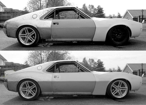

57hemicuda 05-18-2014 02:01 PM
http://57hemicuda.smugmug.com/Cars/A...DSC01116-L.jpg
GregWeld 05-18-2014 02:59 PM
Some dimple die work and stick a fork in it! She's done!! LOL
TorqDork 05-18-2014 06:27 PM
Ron,

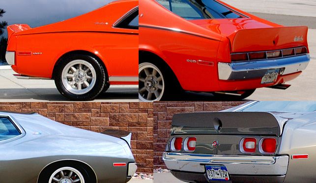

I know you said you’re not a fan of rear spoilers but this car NEEDS one. That being said, I hate 2 seater AMX morons that put Javelin spoilers on their AMX’s which makes them look even longer in back. But you have pushed the rear wheels back to the point where it will look good on your car and the look of the car will balance at any angle with the shorter front.
http://i1369.photobucket.com/albums/...ps30ed4b2b.jpg
Looks better at any angle
http://i1369.photobucket.com/albums/...psad9ba7d0.jpg
Sieg 05-18-2014 07:04 PM
Agreed but not that one. :D 2nd Gen Camaroish maybe, similar rake as the front window, but needs to blend with the eyebrows. :headscratch:
srh3trinity 05-18-2014 09:04 PM
It may not be a popular opinion, but even a front splitter and a rear wing would look right with this particular car.
Vince@Meanstreets 05-18-2014 09:23 PM
love it Ron!!!
Track Junky 05-18-2014 10:10 PM
Love it!! :thumbsup:
MSTSFabbed 05-19-2014 05:03 AM
Ooo Torq Dork is on to something! It needs to lay back a little more but I like it!
TorqDork 05-19-2014 08:34 AM
The spoiler I added is from the 1970 Mark Donohue Javelin which he designed for the Trans Am cars so it's a good fit for any 1/4 panel accent line and should be functional at speed.
The later ones are similar but different.
http://i1369.photobucket.com/albums/...psccc05c10.jpg
Think Ron is sort of thinking about the Viper Green. Rear hump and spoiler added.
http://i1369.photobucket.com/albums/...ps2552d14a.jpg
waynieZ 05-19-2014 01:46 PM
Really looking good Ron. Nice work.
TorqDork 05-20-2014 11:46 AM

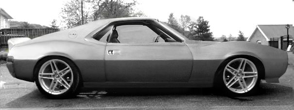

Tried to make the C Pillar accent change a little more realistic and put some color on it..... sort of.
http://i1369.photobucket.com/albums/...ps18d633fd.jpg
Sieg 05-20-2014 11:57 AM
Can't wait to see the splitter rendition. :whistling:

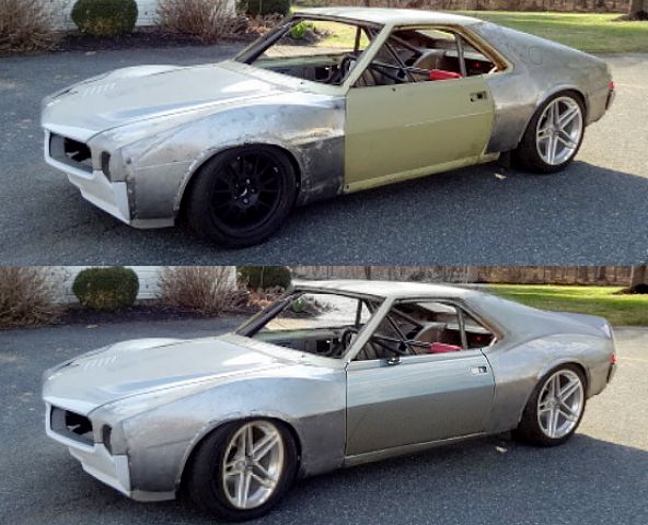

57hemicuda 05-26-2014 04:40 AM
Just thought I would post a contrast picture between the old and the new. Don't know if it was worth all the work for the minor differences, but it does clean it up I think.
http://57hemicuda.smugmug.com/Cars/A...DSC01128-L.jpg
http://57hemicuda.smugmug.com/Cars/A...bay39678-L.jpg
