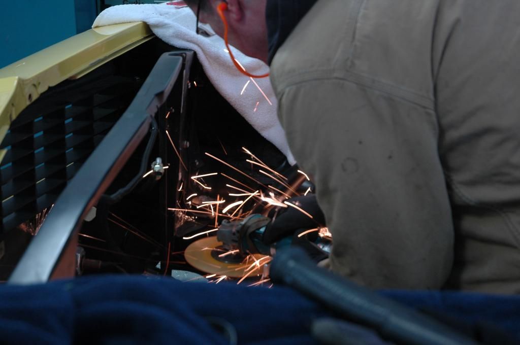

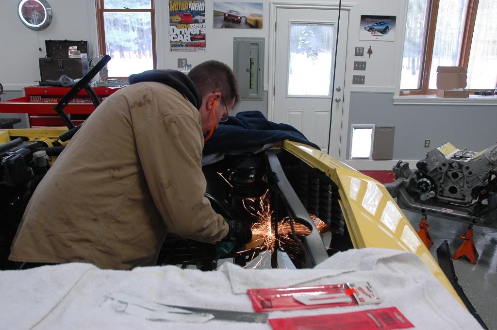

Removing the downbars from the front of dash (bolted) to the AM subframe (welded) proved to be a little difficult as the sawsall blades dulled quickly. The solution was the "wheel of death". The 7" diameter carbide disc on a 4"grinder is probably not OSHA approved, but it allowed for easy access to the work area and made quick work of the chrome moly tubing.
http://i1158.photobucket.com/albums/...2/DSC_3175.jpg
http://i1158.photobucket.com/albums/...2/DSC_3177.jpg
http://i1158.photobucket.com/albums/...2/DSC_3176.jpg

Gordon --- At least Mark had the OSHA approved flame retardant coat on!!!

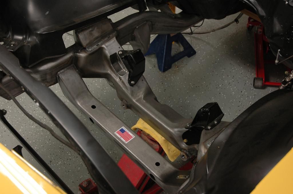

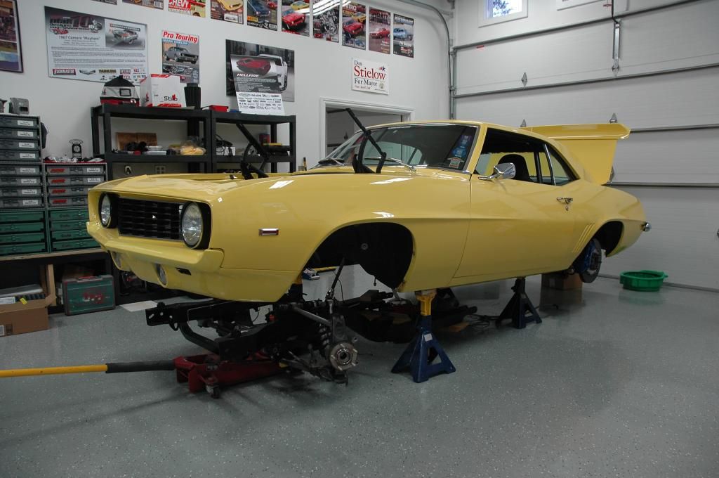

With the downbars removed the AM subframe was lowered with a couple floor jacks.
http://i1158.photobucket.com/albums/...2/DSC_3188.jpg
http://i1158.photobucket.com/albums/...2/DSC_3190.jpg
And the new DSE subframe installed.
Mark pocketed the cross member near the RH engine mount to provide clearance for the AC compressor.
http://i1158.photobucket.com/albums/...2/DSC_3199.jpg

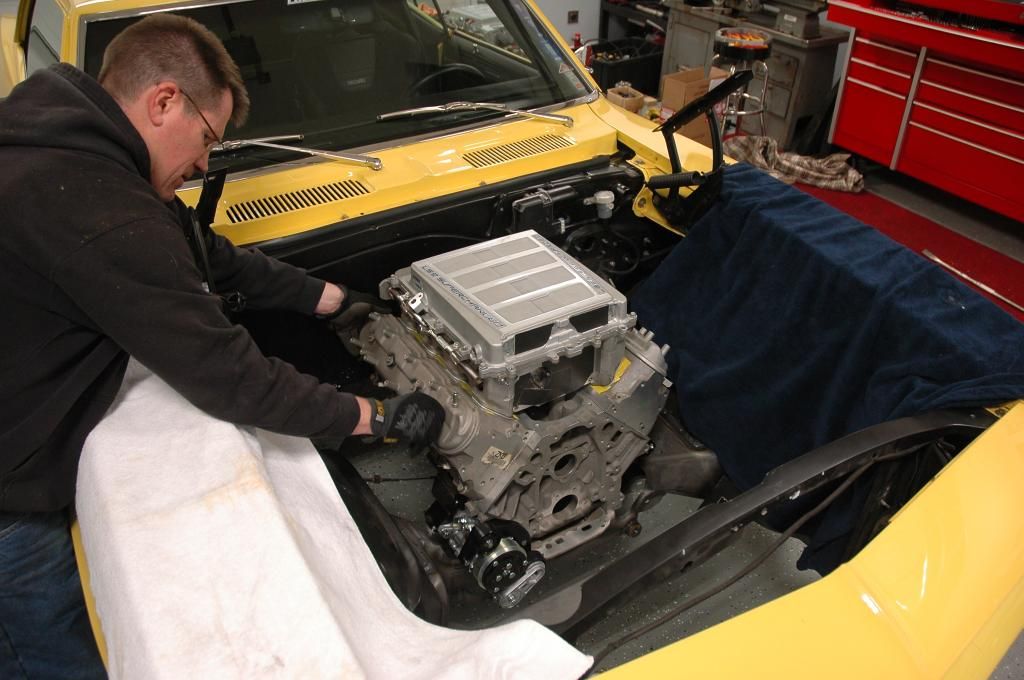

formula88 01-10-2015 08:40 PM
Next up, a mockup block, heads and blower were installed to check clearance to the DSE wiper motor.
http://i1158.photobucket.com/albums/...2/DSC_3203.jpg
Greg - Yep, and the hearing protection was a good idea too!
