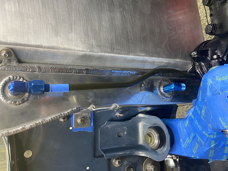

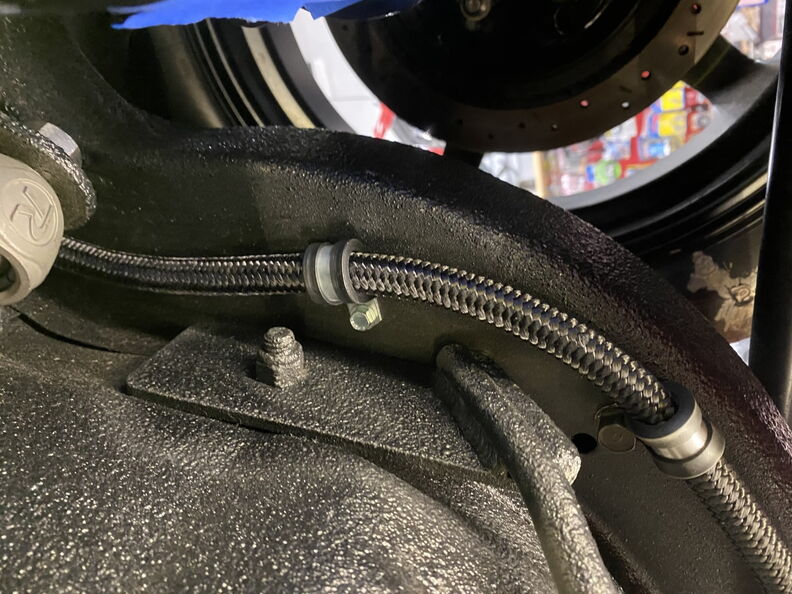

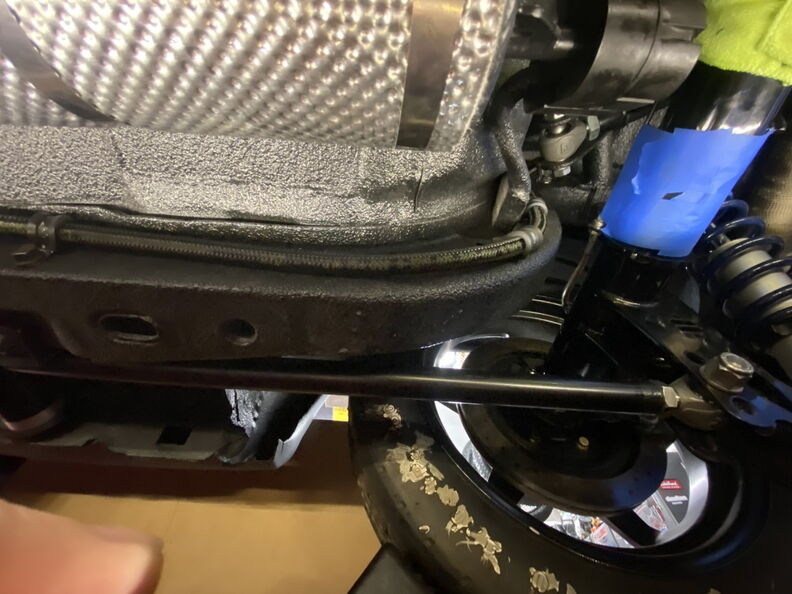

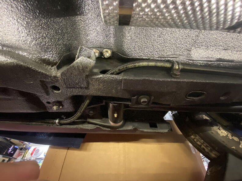

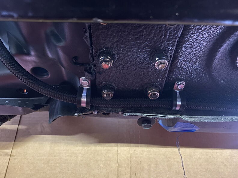

Holley PFT Fuel Line (( 10-31-20 ))

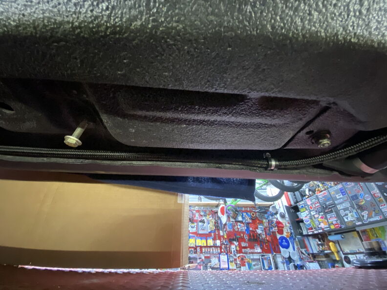

After talking with the guys at Holley I decided that I was going to skip making hard lines and just run soft lines front to rear. The benefit is there would only be two possible places it could leak and it would take a lot less time to run.
I started at the Filter/Regulator and plan to run up and over to the rear frame rail and use the OE mounting points for the line.
http://www.garagescene.net/_data/i/u...9996996-me.jpg
http://www.garagescene.net/_data/i/u...dbb98df-me.jpg
http://www.garagescene.net/_data/i/u...69baeca-me.jpg
http://www.garagescene.net/_data/i/u...adbba31-me.jpg
http://www.garagescene.net/_data/i/u...f46dda7-me.jpg
http://www.garagescene.net/_data/i/u...178b38e-me.jpg

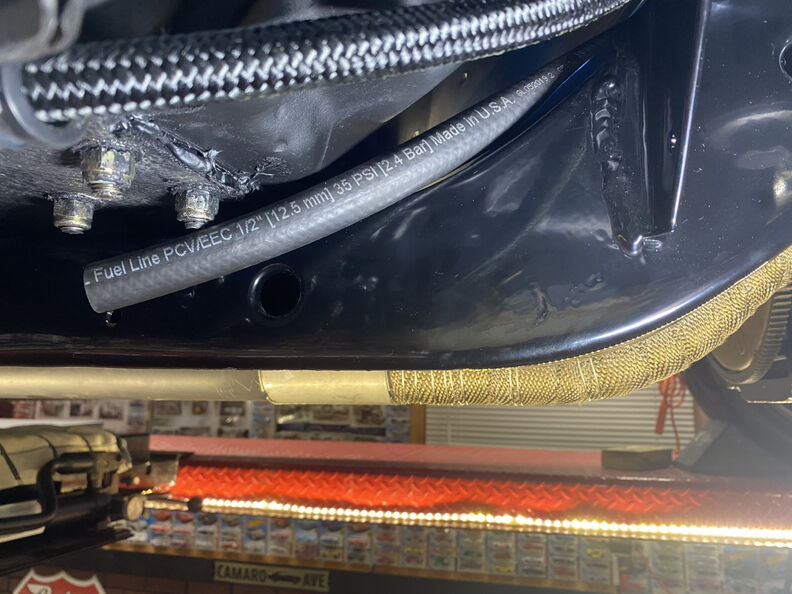

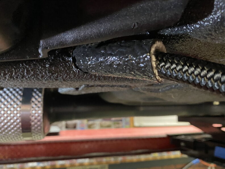

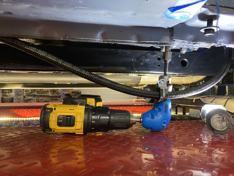

In order to keep the line above the frame I took advantage of this slot and ran the line through it.
http://www.garagescene.net/_data/i/u...8454247-me.jpg
I am also ordering some aviation wrap from Tech to put around the fuel line as it passes through this area.
http://www.garagescene.net/_data/i/u...5f781ff-me.jpg
http://www.garagescene.net/_data/i/u...d305ac2-me.jpg
Thankfully I have a nice right hand drill attachment as this prevented me from going to Ace Hardware and buying a new tool. Darn !!!
http://www.garagescene.net/_data/i/u...a31b130-me.jpg
http://www.garagescene.net/_data/i/u...beb4814-me.jpg
http://www.garagescene.net/_data/i/u...09bc60b-me.jpg

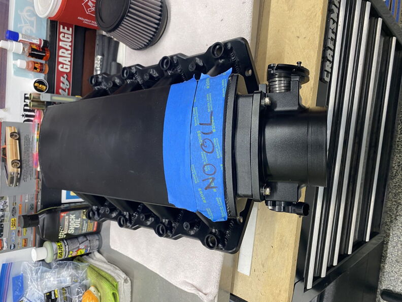

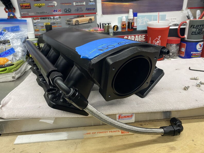

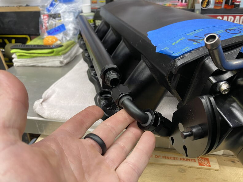

Assembling the Holley Sniper Sheet Metal Intake (( 11-02-20 ))
The car is progressing nicely and it's time to address the one issue I have with the Holley Intake. I've been working with the guys at Holley and I explained to them the Fuel Log connecting the rails in the front is way to short. It's so tight that it actually bends the rails in when I try to install the Throttle Body.
http://www.garagescene.net/_data/i/u...e51a789-me.jpg
http://www.garagescene.net/_data/i/u...717afc5-me.jpg
http://www.garagescene.net/_data/i/u...b20275f-me.jpg
http://www.garagescene.net/_data/i/u...261b264-me.jpg

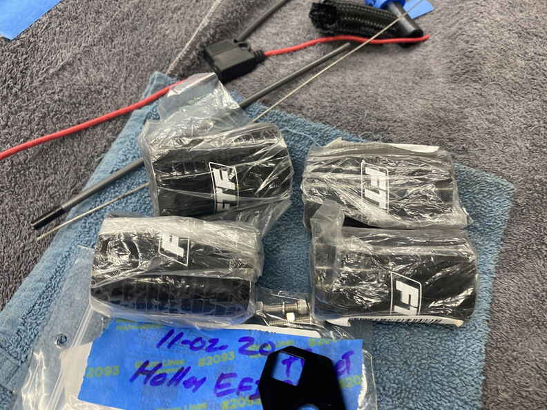

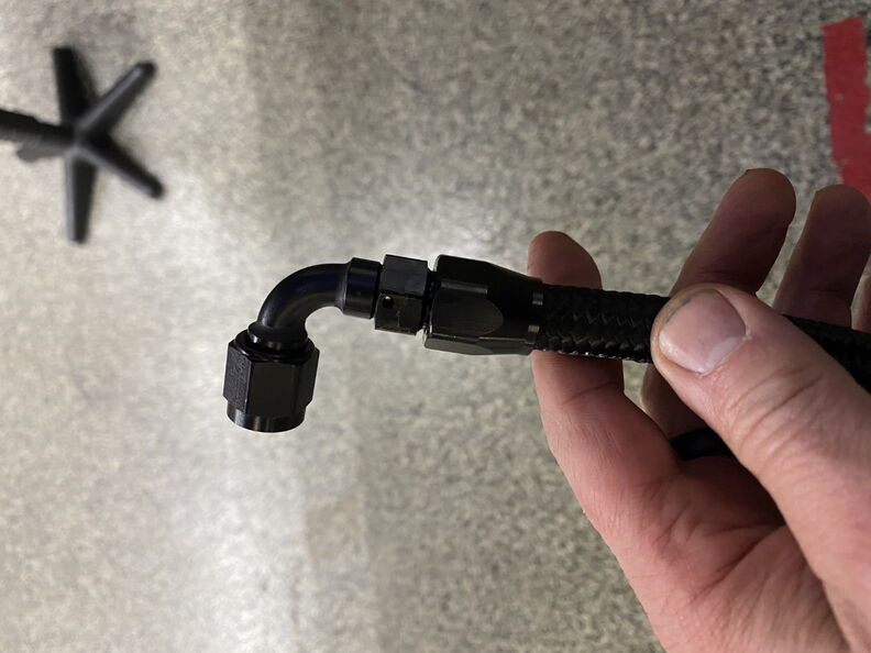

So I am going to plan "B" and ordering up a few more fitting and going to use the Black PFT line and I will add 1.5" to the length of the line so it fits neatly under the throttle body.
http://www.garagescene.net/_data/i/u...df53f89-me.jpg

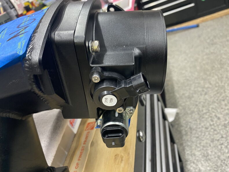

Why is this bracket so darn Ugly (( 11-02-20 ))
So I have the Holley Throttle Bracket and it has got to be the ugliest thing I have ever seen.
Hideous would be the word that comes to mind.
http://www.garagescene.net/_data/i/u...ef07277-me.jpg
Dear Lord this thing sticks up so high it could possible hit the hood.
http://www.garagescene.net/_data/i/u...34ebe8d-me.jpg

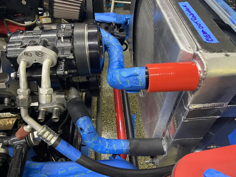

Coolant Hoses by Kenny Davis (( 11-08-20 ))
I ordered up some new hoses to connect the metal coolant hose that Kenny built.
I borrowed the red connection hose from my buddy Ben and I liked how nice it fit and looked.
http://www.garagescene.net/_data/i/u...667725f-me.jpg
Knowing that the hose I borrowed worked and looked nice I ordered up some in black.
http://www.garagescene.net/_data/i/u...1a7be02-me.jpg
http://www.garagescene.net/_data/i/u...5a4493a-me.jpg

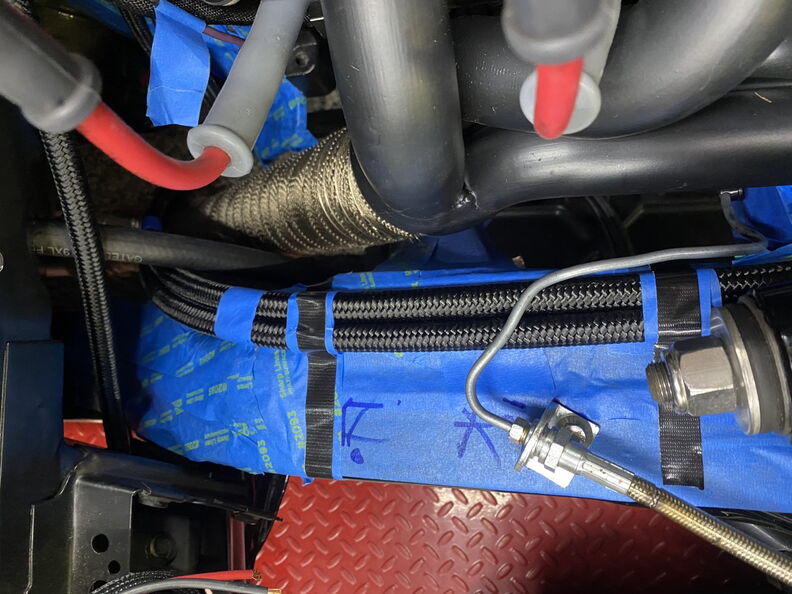

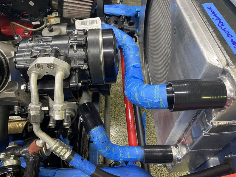

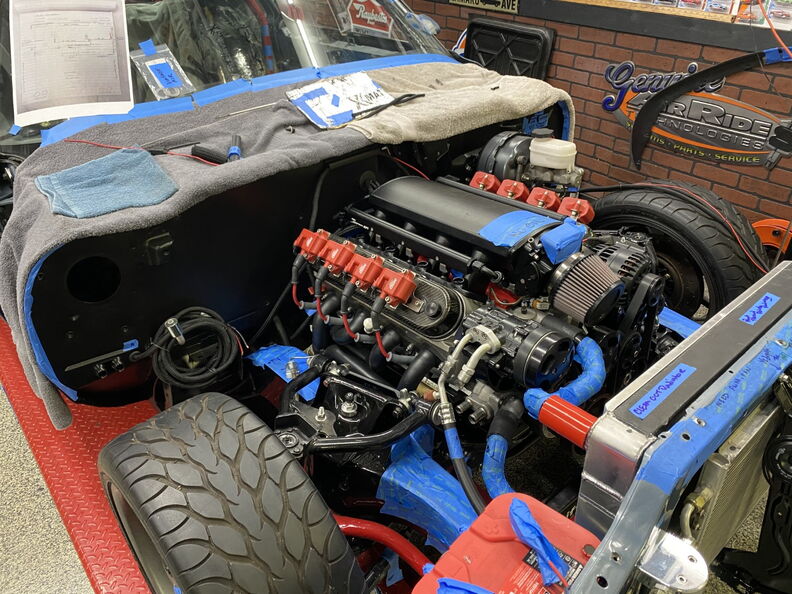

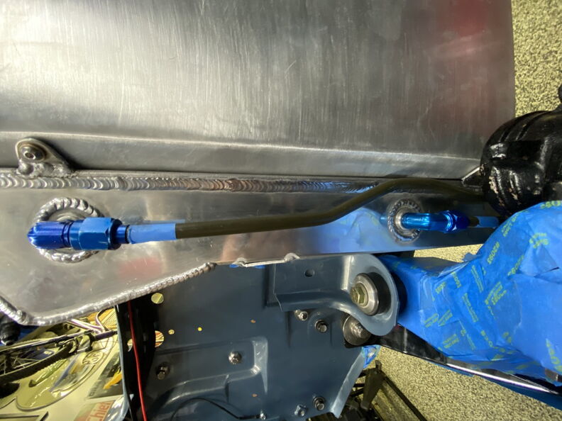

Trans Coolant Lines (( 11-08-20 ))

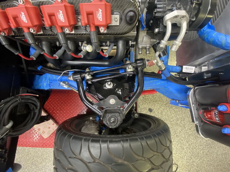

Today I am going to try to figure out a good way to run the transmission coolant lines. I started at the
radiator using the lines Kenny bent as they look great and work perfect. I will most likely change the blue fittings
to black so it blends in with the engine bay,
http://www.garagescene.net/_data/i/u...036b032-me.jpg
http://www.garagescene.net/_data/i/u...ce56c0c-me.jpg

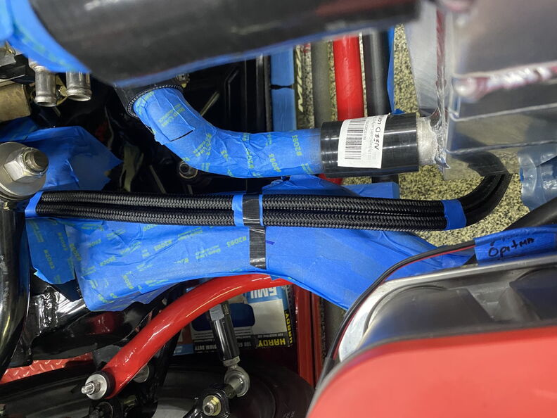

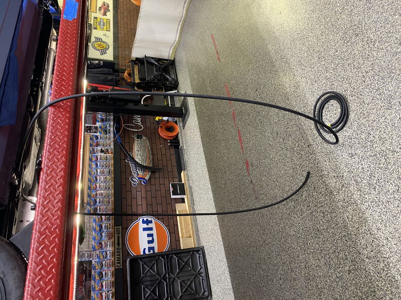

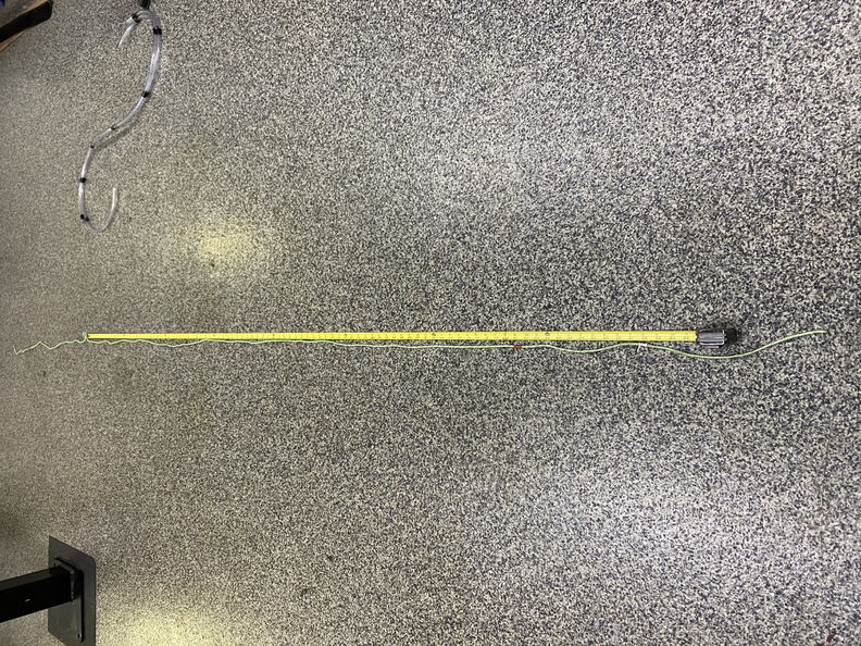

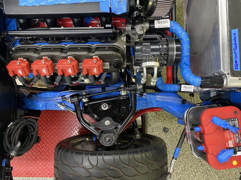

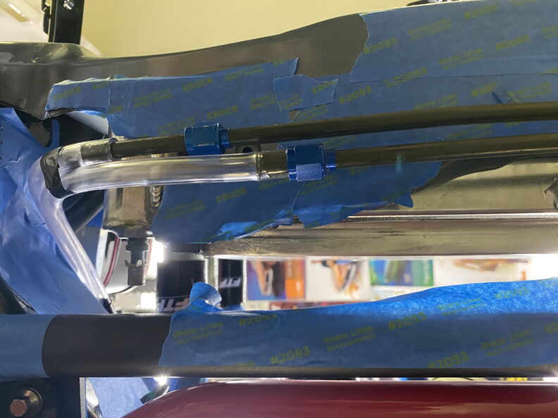

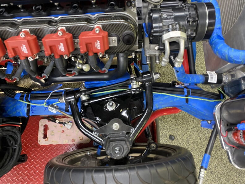

Once again I pulled out the clear tubbing and layed it out the way I suspect it will go.
http://www.garagescene.net/_data/i/u...a149b99-me.jpg
http://www.garagescene.net/_data/i/u...7b3e533-me.jpg
http://www.garagescene.net/_data/i/u...7ce236a-me.jpg
http://www.garagescene.net/_data/i/u...317a480-me.jpg

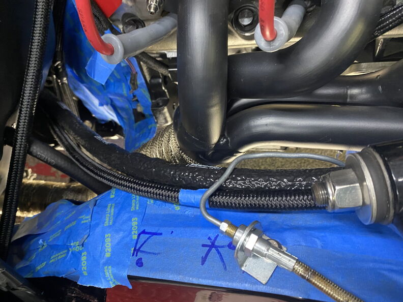

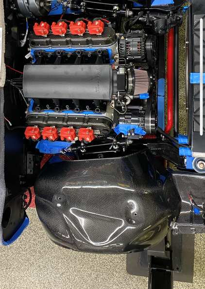

There is a lot going on here.
Fuel line, Vintage Air Drain & of course the Trans Coolant Lines which will have DEI heat wrap installed near the headers downpipe.
http://www.garagescene.net/_data/i/u...e3761f9-me.jpg
You can see the green rope as I use that to estimate the length of hose I will need.
http://www.garagescene.net/_data/i/u...e005905-me.jpg
http://www.garagescene.net/_data/i/u...e1711b2-me.jpg
http://www.garagescene.net/_data/i/u...15f0ae1-me.jpg
Once the inner fenders are installed the lines will not be visible.
http://www.garagescene.net/_data/i/u...88e72db-me.png

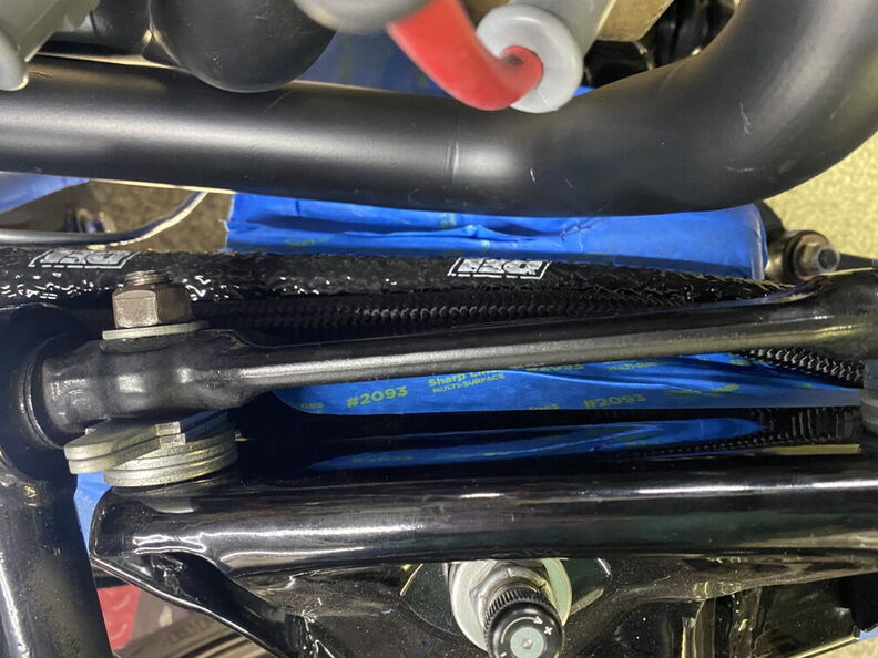

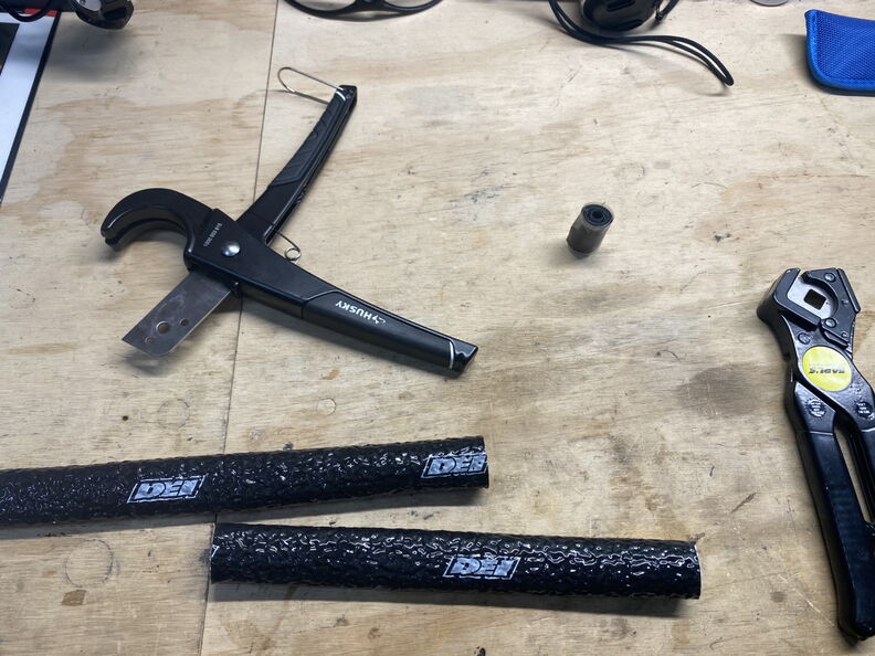

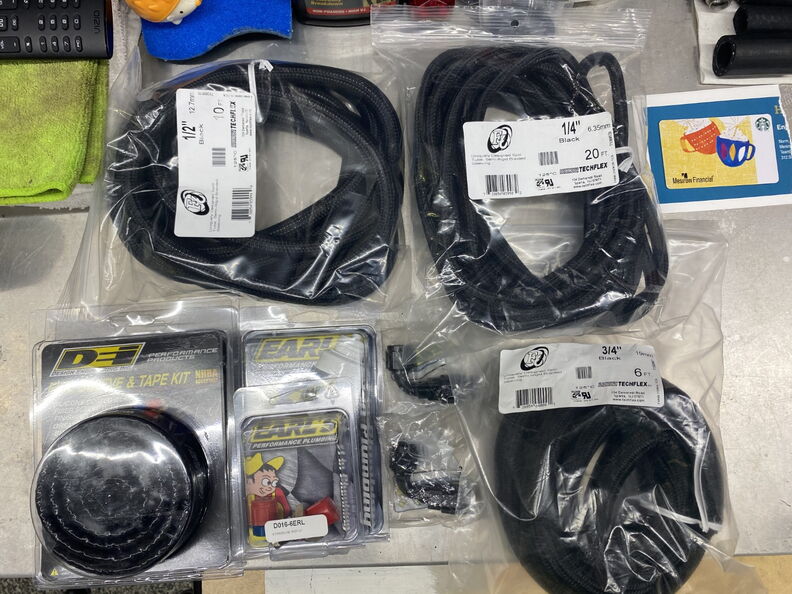

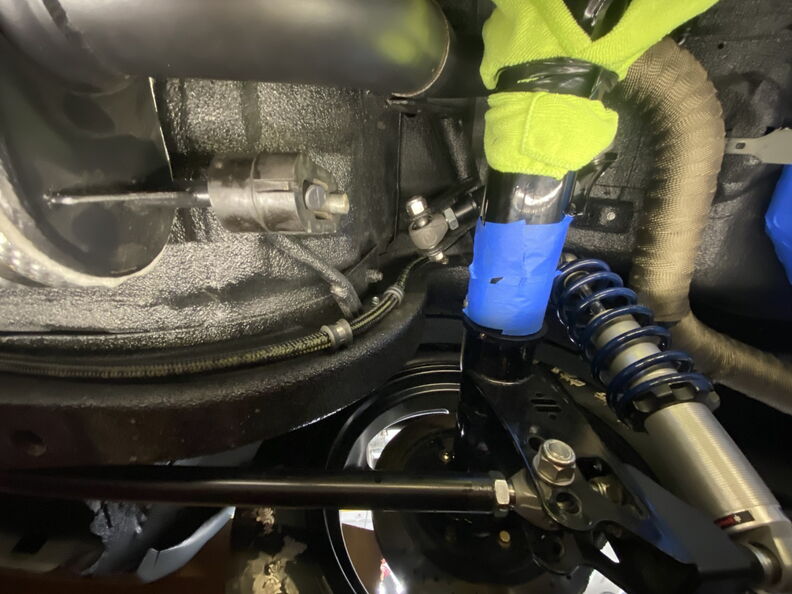

Playing with the DEI Heat Sleeve (( 11-11-20 ))

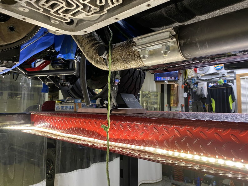

I picked up some DEI Heat Sleeve and I plan to install it on the fuel line near the tailpipes.
http://www.garagescene.net/_data/i/u...f43d08f-me.jpg
http://www.garagescene.net/_data/i/u...4702908-me.jpg

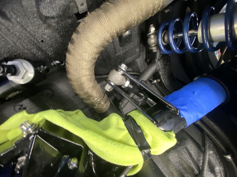

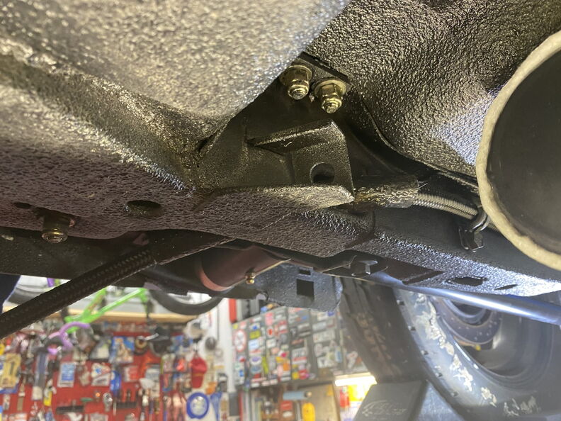

It was a while I am here moment I slid some over the fuel line where it goes through the frame rail.
http://www.garagescene.net/_data/i/u...b05c9f2-me.jpg
http://www.garagescene.net/_data/i/u...398de31-me.jpg

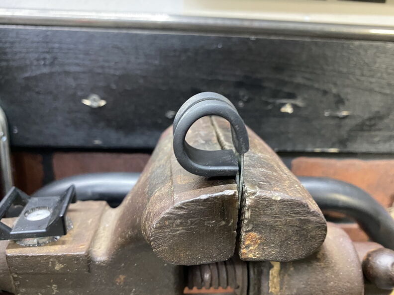

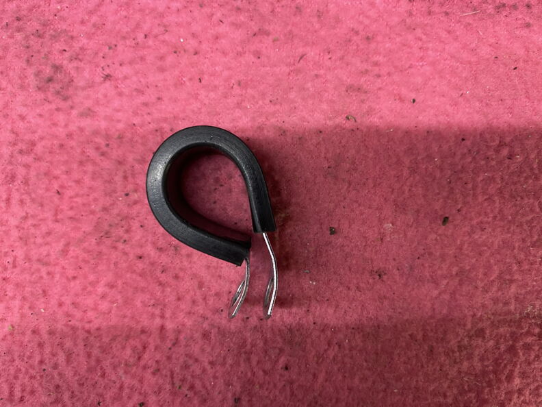

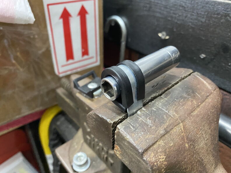

So years ago I learned this little trick to straighten out Adel Clamps.
http://www.garagescene.net/_data/i/u...65fabf3-me.jpg
Insert the appropriate socket.
http://www.garagescene.net/_data/i/u...53ca3c2-me.jpg
Gently tap the clamp and it will straighten right out.
http://www.garagescene.net/_data/i/u...811d605-me.jpg
Relocated the Vintage Air drain to a safe location.
http://www.garagescene.net/_data/i/u...89e3a44-me.jpg

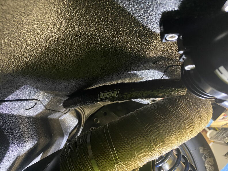

Installed the DEI Heat Wrap on one of the Transmission coolant lines.
http://www.garagescene.net/_data/i/u...f74b741-me.jpg
http://www.garagescene.net/_data/i/u...f5b37d6-me.jpg
