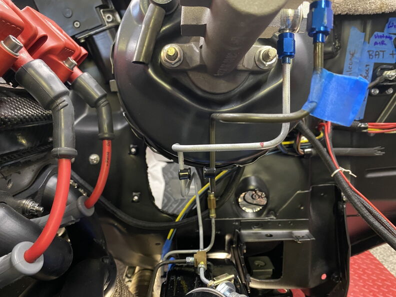

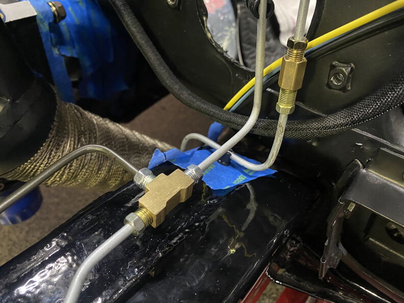

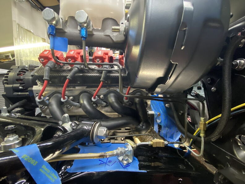

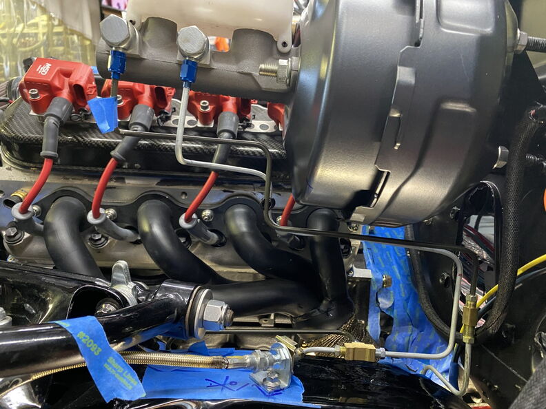

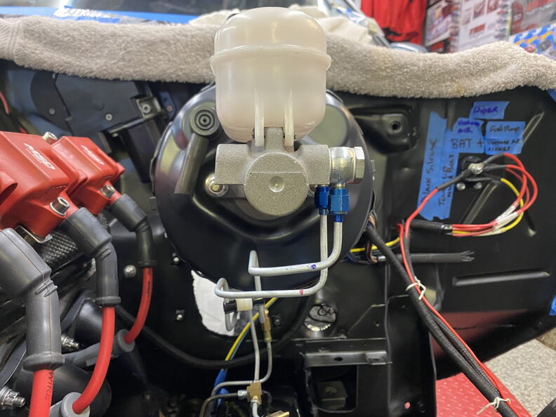

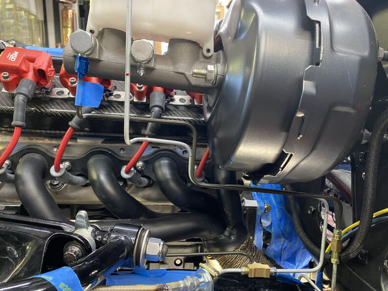

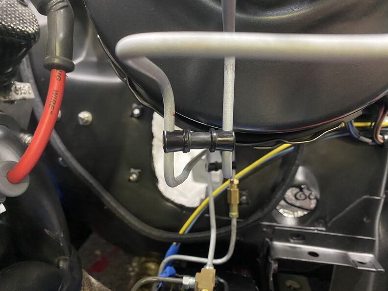

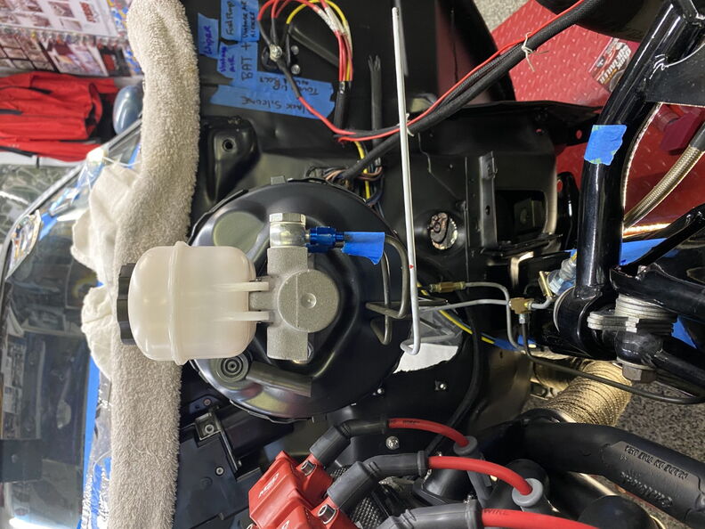

Picking up where I left off I need to connect both front calipers to the master and my goal was to keep is simple and fairly
easy build. I plan to install a Knotchead line clamp under it to support it.
http://www.garagescene.net/_data/i/u...d09f1c4-me.jpg
http://www.garagescene.net/_data/i/u...e777d45-me.jpg
http://www.garagescene.net/_data/i/u...af5e9c7-me.jpg

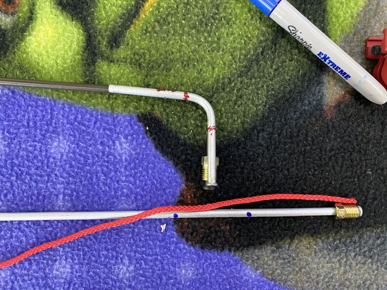

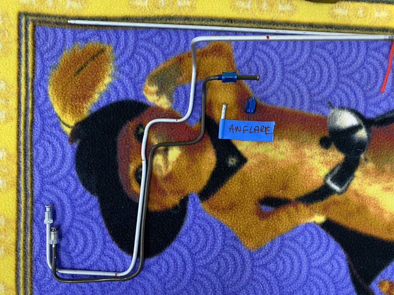

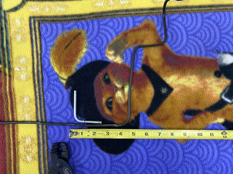

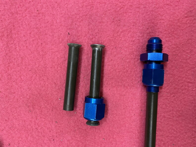

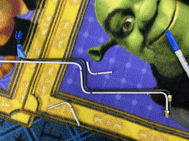

Time to make the final line.
Since I made reference marks on the practice line I used those to make the new line all in one piece and it turned out exactly how I wanted it.
http://www.garagescene.net/_data/i/u...df0b308-me.jpg
Yep, I kept practicing with the scrap pieces to help me learn where to line up the tools so I can get the desired bends.
http://www.garagescene.net/_data/i/u...e4b2047-me.jpg

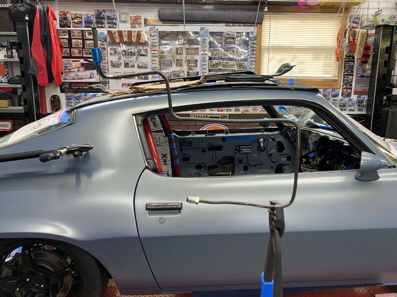

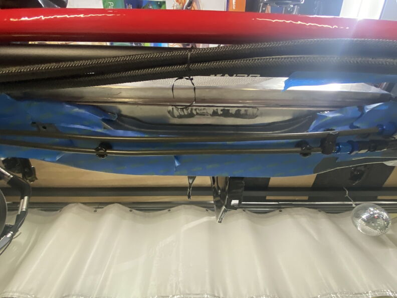

So I was feeling a little bit ambitious and I gave it another crack on the crossover line on the subframe.
http://www.garagescene.net/_data/i/u...54c9daa-me.jpg

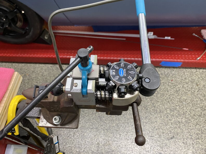

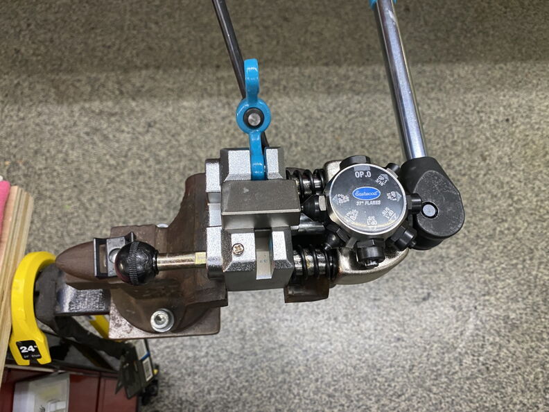

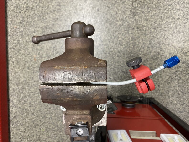

I needed an extra hand so I put the brake line bender in my Grandfathers Vice and wow was this a total game changer
it was like having Mike in the garage helping me.
http://www.garagescene.net/_data/i/u...80e7394-me.jpg
http://www.garagescene.net/_data/i/u...179c939-me.jpg

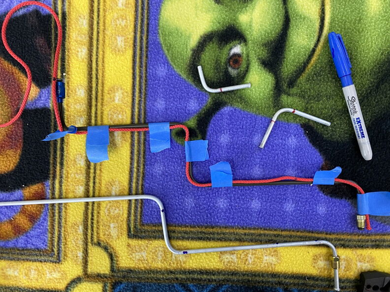

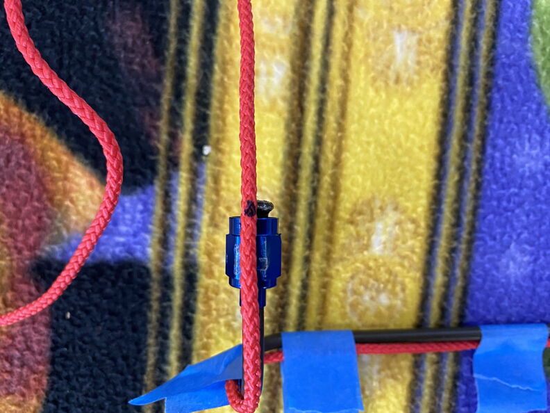

Using the reference marks I made allowed me to duplicate the final line all in one piece. I also traced out the line with string
so I new exactly how much line was necessary. It would have sucked if I had started with a 60" line as this line turned out to be 62" in length.
http://www.garagescene.net/_data/i/u...da81bf1-me.jpg
http://www.garagescene.net/_data/i/u...2f9d0d4-me.jpg

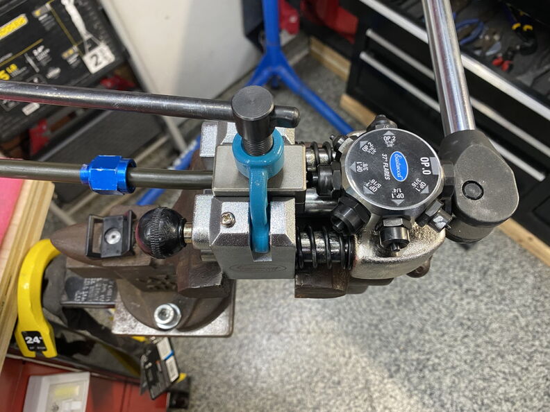

The final flare and yes the fitting is on !!!
http://www.garagescene.net/_data/i/u...5472f4e-me.jpg
http://www.garagescene.net/_data/i/u...1bc1f5b-me.jpg
The tape makes the line not look centered but it is actually almost perfect.
http://www.garagescene.net/_data/i/u...452887e-me.jpg

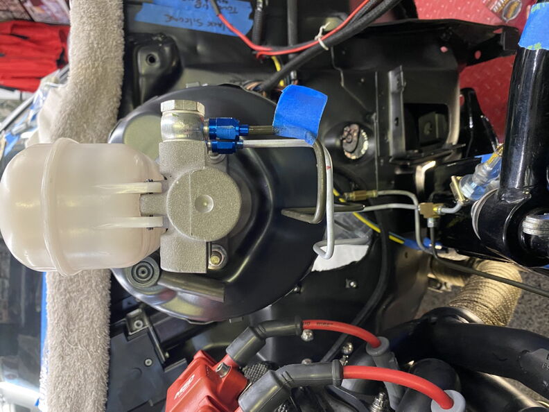

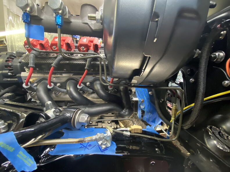

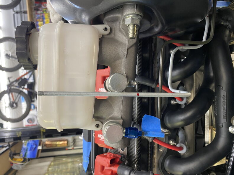

Not Going to lie bending these lines scares me (( 11-27-20 ))
As the title says I am a little bit nervous trying to remake these lines.
http://www.garagescene.net/_data/i/u...2cc673f-me.jpg
My plan is to take the existing line and straighten then bend it like it needs to be since I moved things around a little bit.
http://www.garagescene.net/_data/i/u...5f3e4e7-me.jpg
http://www.garagescene.net/_data/i/u...3fb35fb-me.jpg
http://www.garagescene.net/_data/i/u...739a76c-me.jpg
Okay it worked
http://www.garagescene.net/_data/i/u...cef9b59-me.jpg
Here we go
http://www.garagescene.net/_data/i/u...3dc0972-me.jpg
http://www.garagescene.net/_data/i/u...f86df1a-me.jpg
http://www.garagescene.net/_data/i/u...fc17b7e-me.jpg
I need this darn fitting !!
http://www.garagescene.net/_data/i/u...6dfdd58-me.jpg
http://www.garagescene.net/_data/i/u...7516aff-me.jpg
http://www.garagescene.net/_data/i/u...99795cc-me.jpg
I am very happy for the outcome of line # 1
http://www.garagescene.net/_data/i/u...24875d0-me.jpg

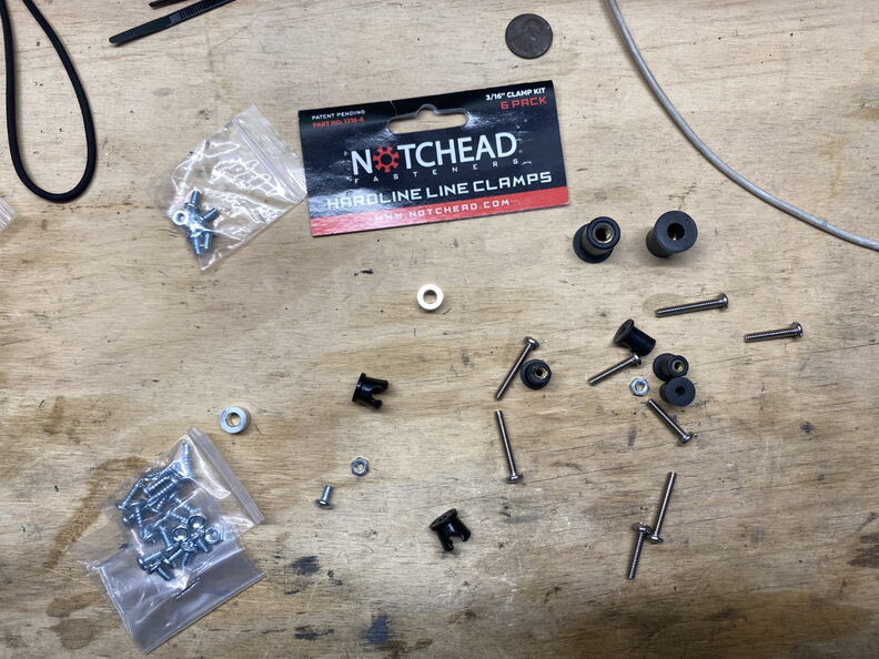

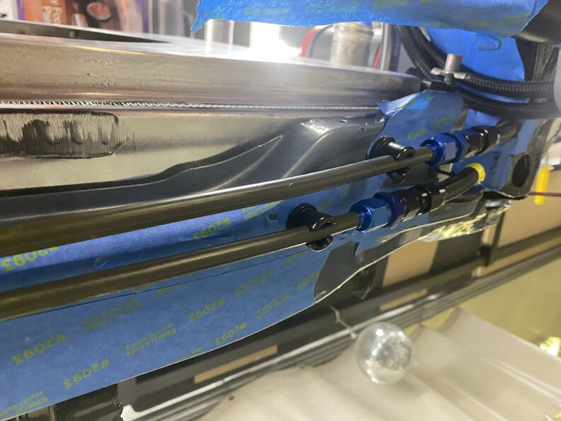

To keep it clean I am going to use the Knotchead line clamps to secure the lines together.
http://www.garagescene.net/_data/i/u...52df90c-me.jpg
http://www.garagescene.net/_data/i/u...07f023f-me.jpg
More to come later as I want to get home so I can work on the car tonight.

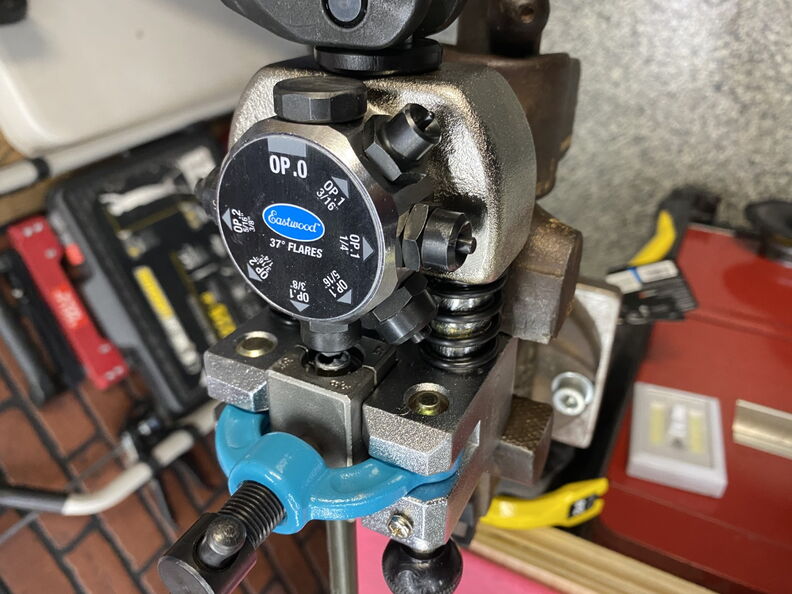

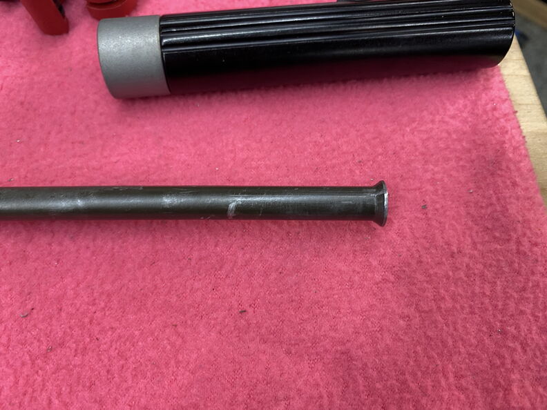

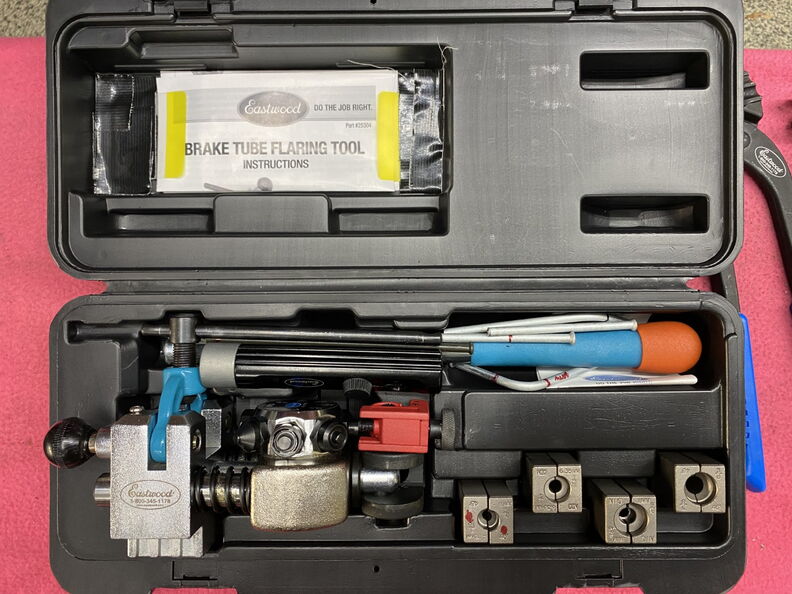

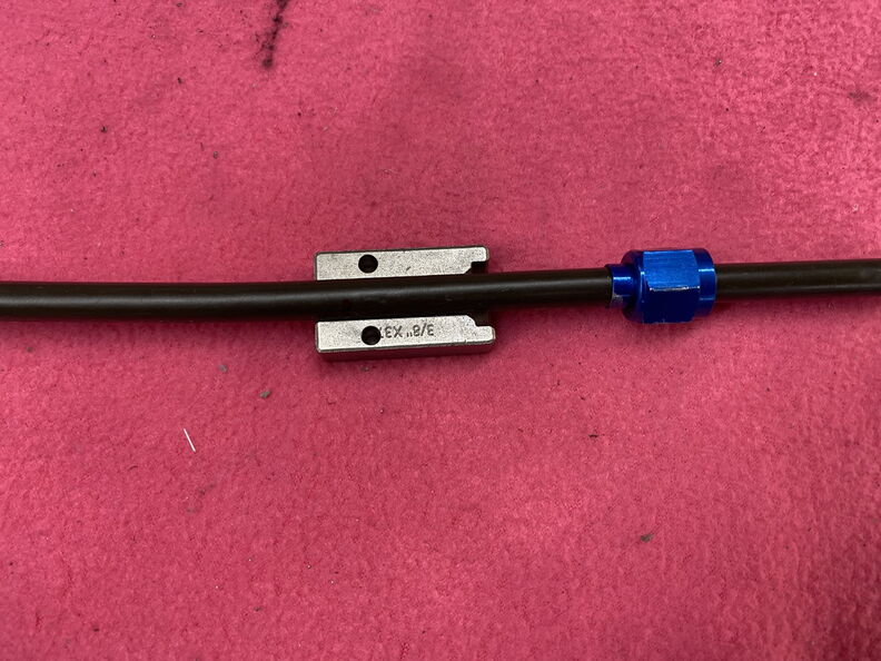

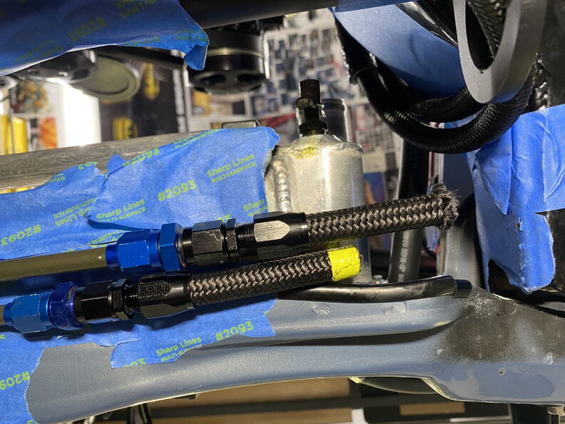

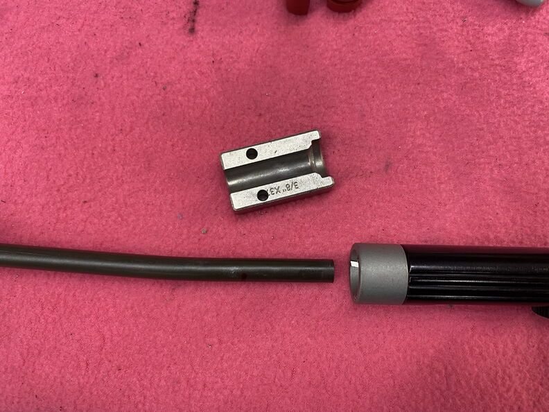

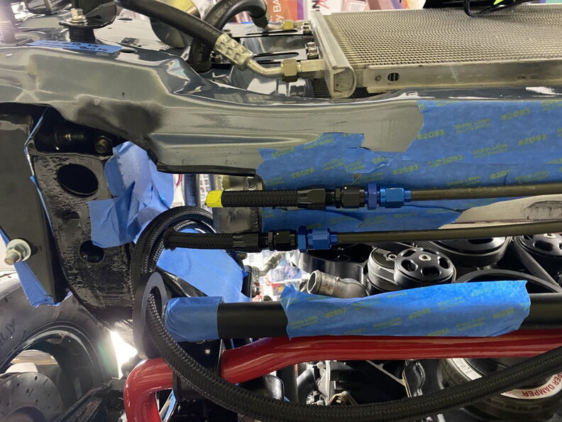

Practicing flaring some 3/8" line with the new tool (( 11-27-20 ))
http://www.garagescene.net/_data/i/u...d59fbbd-me.jpg
Time to flare some 3/8 line
http://www.garagescene.net/_data/i/u...37497f0-me.jpg
http://www.garagescene.net/_data/i/u...a4e2854-me.jpg

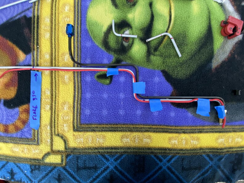

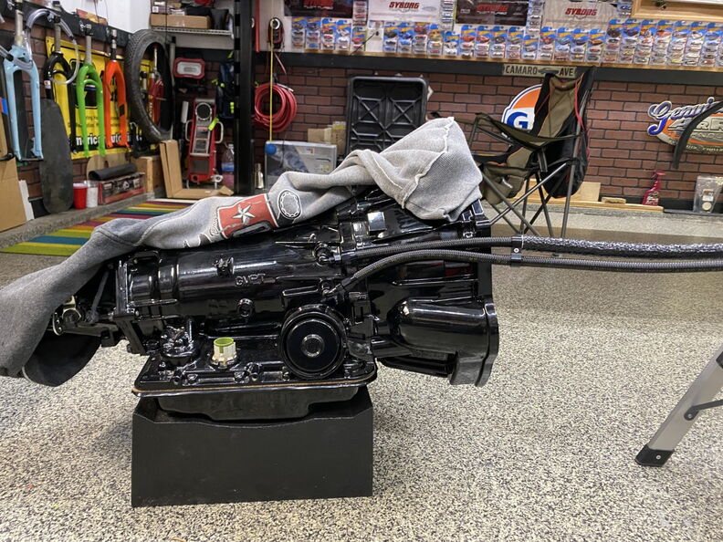

Back to mocking up the trans lines.
http://www.garagescene.net/_data/i/u...10ffe56-me.jpg
http://www.garagescene.net/_data/i/u...691830c-me.jpg
http://www.garagescene.net/_data/i/u...64c4783-me.jpg
http://www.garagescene.net/_data/i/u...ae32312-me.jpg
http://www.garagescene.net/_data/i/u...075a0bc-me.jpg

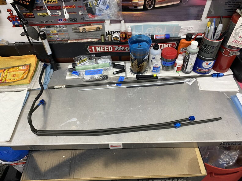

Since the rear line didn't match I remade it so it would. (( 11-28-20 ))
Using some the bend templates that I made helped to make this a much easier project.
http://www.garagescene.net/_data/i/u...ff5d0ed-me.jpg
http://www.garagescene.net/_data/i/u...285c686-me.jpg
http://www.garagescene.net/_data/i/u...6960afe-me.jpg
http://www.garagescene.net/_data/i/u...018f03d-me.jpg
http://www.garagescene.net/_data/i/u...1b32b92-me.jpg
The good news is I did it in one shot with what I have learned so far.
http://www.garagescene.net/_data/i/u...f3cb3ef-me.jpg
I wanted to link the lines together so I will be using the Knotchead line clamps. A quick trip to the local Ace Hardware to pick up
some hardware and while I was there I scored a couple Hot Wheels Syclones. I also stopped a Dairy Queen for a Blizzard.
http://www.garagescene.net/_data/i/u...079920f-me.jpg
http://www.garagescene.net/_data/i/u...c4580a3-me.jpg
http://www.garagescene.net/_data/i/u...0b015f1-me.jpg
http://www.garagescene.net/_data/i/u...52bc52b-me.jpg
http://www.garagescene.net/_data/i/u...7157f01-me.jpg
http://www.garagescene.net/_data/i/u...c285edc-me.jpg

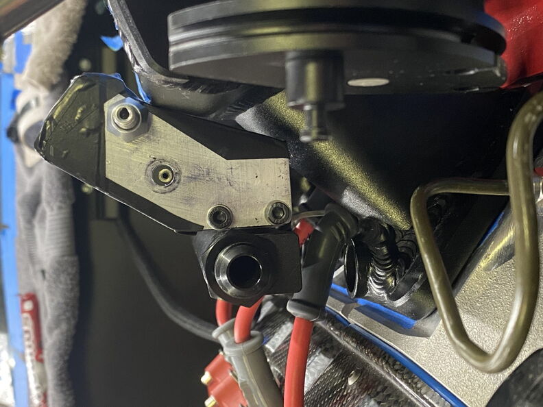

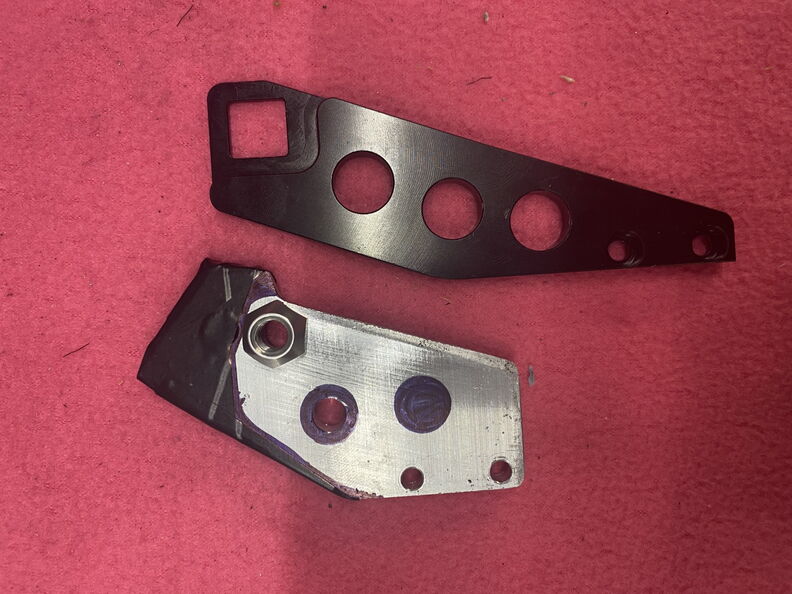

Throttle Bracket - Still playing around a ((11-28-20))
Trying to make this bracket a little leaner.
http://www.garagescene.net/_data/i/u...0153920-me.jpg
I think if I trim it down to something like this and get it anodized black it will blend right in. Before I trim it down I need to get a new Lokar throttle cable.
http://www.garagescene.net/_data/i/u...f7e5162-me.jpg
http://www.garagescene.net/_data/i/u...6f9bca4-me.jpg

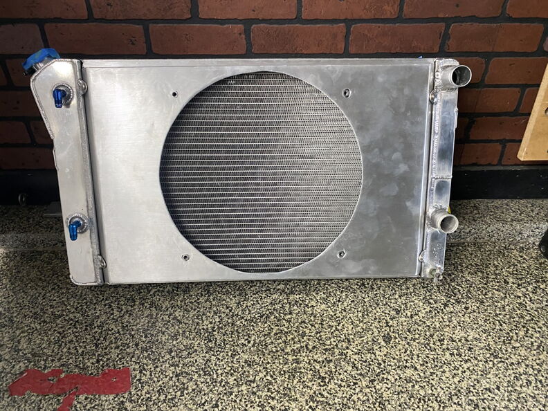

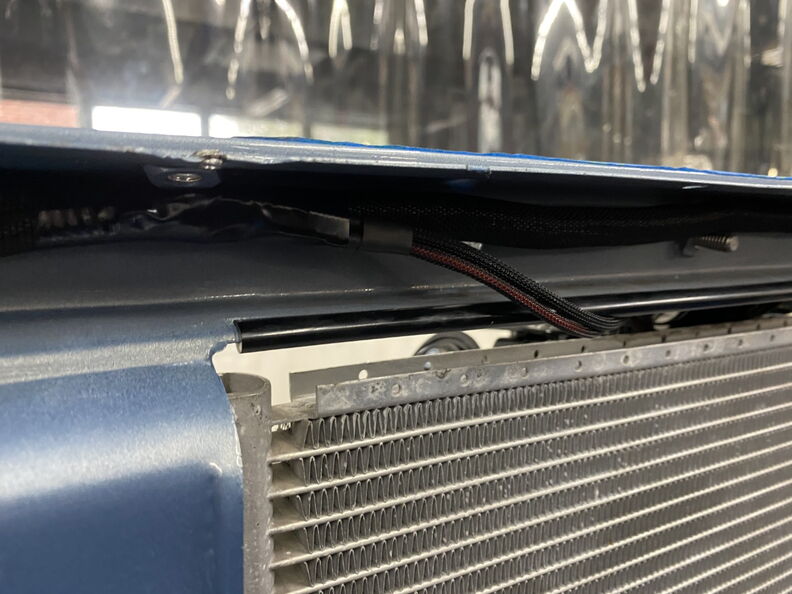

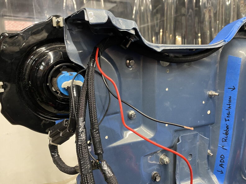

Radiator ((11-29-20))
http://www.garagescene.net/_data/i/u...948692e-me.jpg

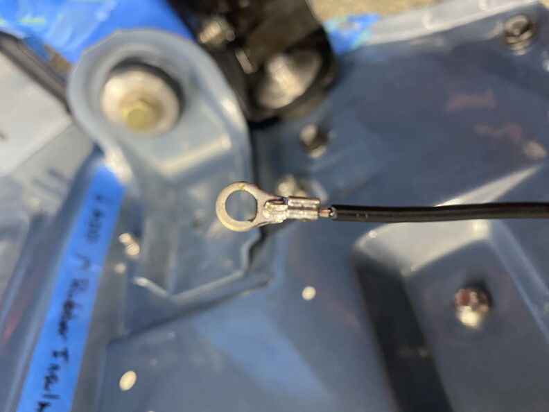

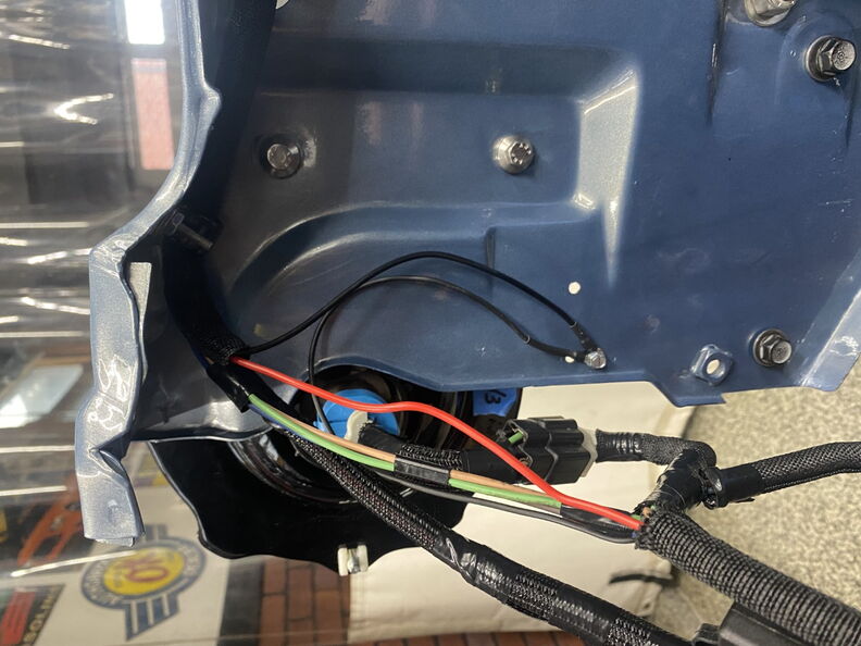

I want to hide as many wires as possible so the horn wire will sneak behind the core support. I used a piece of door edge guard to protect the wires.
http://www.garagescene.net/_data/i/u...7b352ba-me.jpg
http://www.garagescene.net/_data/i/u...ddf299f-me.jpg
little bit of an overkill to crimp and solder but what the heck why not.
http://www.garagescene.net/_data/i/u...7c94750-me.jpg
http://www.garagescene.net/_data/i/u...4ad2b4a-me.jpg

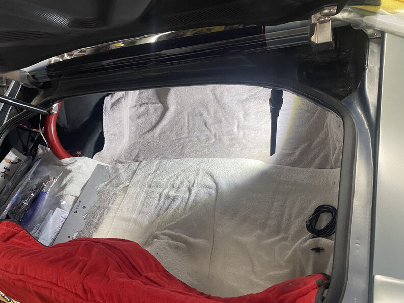

Moving on to the Kicker Bluetooth Stereo
http://www.garagescene.net/_data/i/u...430a983-me.jpg
I tried to make the trunk a little more comfortable for me back.
http://www.garagescene.net/_data/i/u...1aad6cb-me.jpg

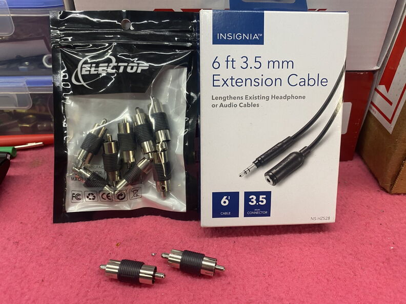

I need to run a 3.5mm extension up to the center console and the cable for the controller which will be mounted in the lower dash or center console. I won't decide that till I figure where the cup holders are going to go.

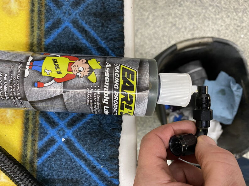

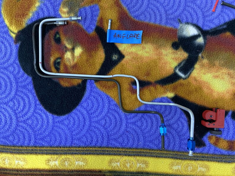

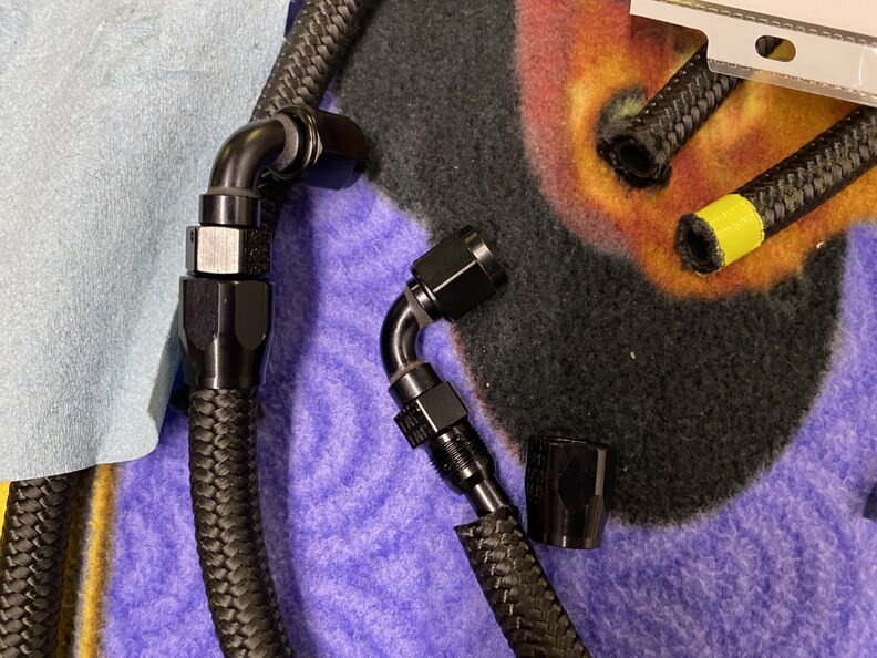

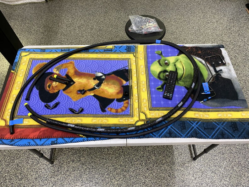

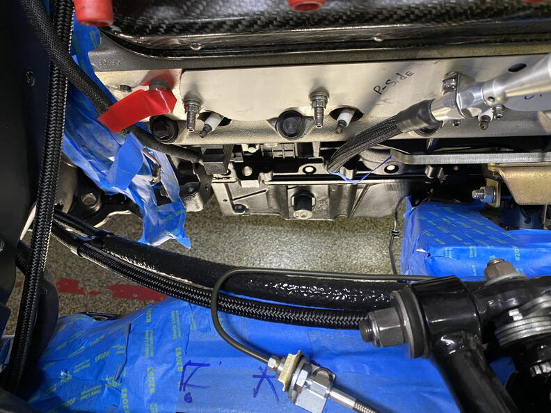

Trans Coolant Lines & Finally some Holley Fittings
Since Kenny did such a great job bending these line I am going to use them. ((11-29-20))

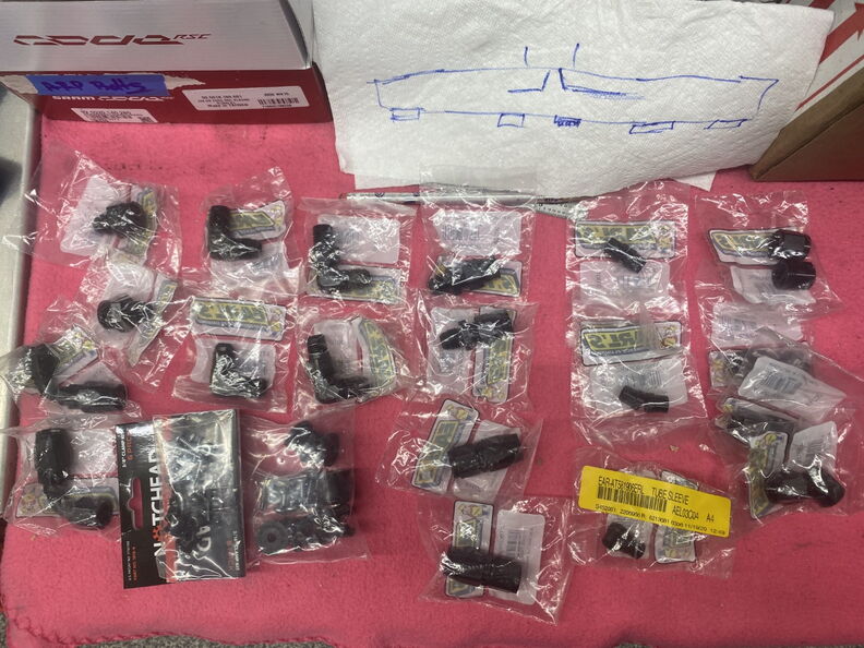

Holley Fitting arrived ((12-01-20))
http://www.garagescene.net/_data/i/u...728004f-me.jpg

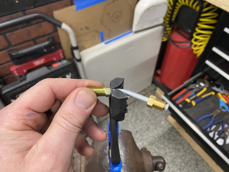

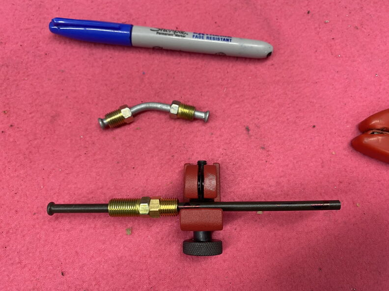

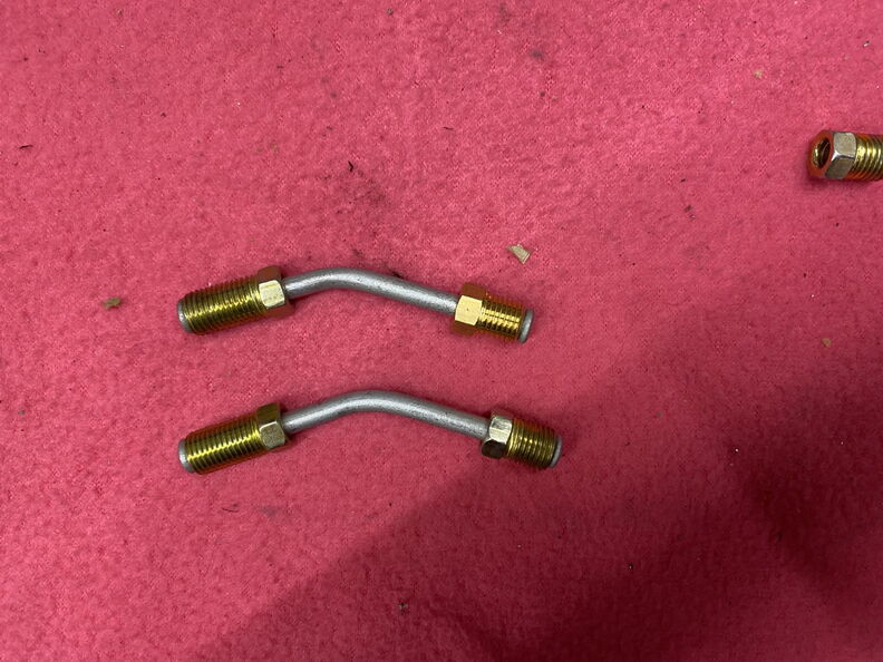

The final brake line ((12-03-20))

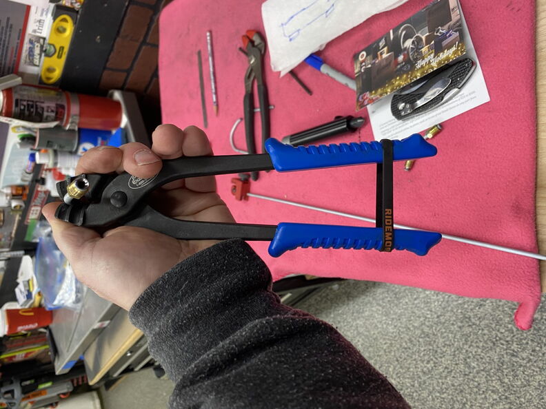

I am finally getting around to make the final brake line and it's tiny.
http://www.garagescene.net/_data/i/u...feac9cb-me.jpg
http://www.garagescene.net/_data/i/u...b0f0d76-me.jpg
The best tip ever is to secure a rubber band around the grips so you don't have to worry about holding them closed.
http://www.garagescene.net/_data/i/u...b112a20-me.jpg
Just a tiny bit longer and it works perfect.
http://www.garagescene.net/_data/i/u...764ca2c-me.jpg
