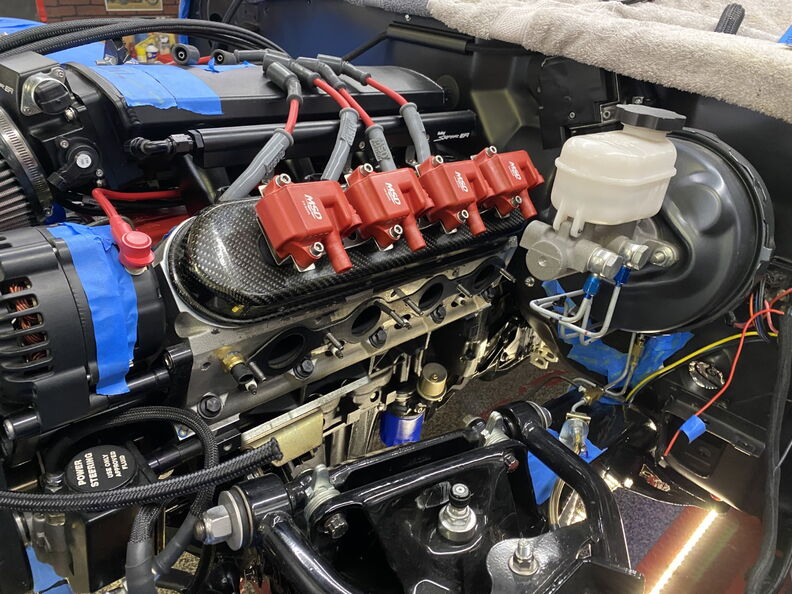

Originally Posted by ADY (Post 712997)
Marty,
I've been thinking I need to improve my grounding and possibly increase the gauge of the positive (currently 2 gauge) since I have my battery in the trunk and the voltage drops to 10.8v during start up. I currently only have a short ground wire from the battery to the subframe, and then a ground from the frame to the block... from what you've researched should I run the ground straight to the block first?
Pass along any sites you found helpful.
thanks!
Boy that is a tuff call. Since I left my battery up front as I wanted the car to be simple and I didn't want to struggle to get the battery it made my decision pretty easy. From what I have read and learned along the way I choose to run the ground from the battery to the block and then a secondary ground from the block to the frame all of the side post battery terminal. Then coming off the top post terminal I am running a ground wire to both kick panels in the interior so the body has a good ground and I can ground the Vintage Air, Kicker sound system and the DSE wiper directly to the grounds on the drivers side. On the passenger side I am ground some of the Holley ECU wire and others will go all the way back to the battery.
It might be overkill but I would rather error on the overkill side. I am also going to look for the picture of the ground lug that Rad Rides & BBT Fab did on one of their cars as you might like what they did.
syborg tt 06-05-2021 07:28 AM
Here are the pictures
https://uploads.tapatalk-cdn.com/202...54cd06ede2.jpg
https://uploads.tapatalk-cdn.com/202...520421de4e.jpg
Musclerodz 06-05-2021 07:26 PM
Marty,
thanks!
I home run my ground cable. I run 2 gauge from the trunk to a bulkhead pass thru up near the firewall. From there I can tie directly to engine, and then add support grounds from body to sub. I can then tie all my other main electrical systems back to that pass thru. It creates a more stable ground path and less issues with electrical systems

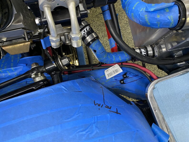

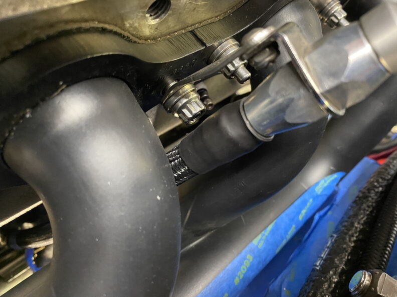

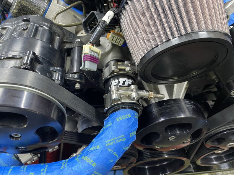

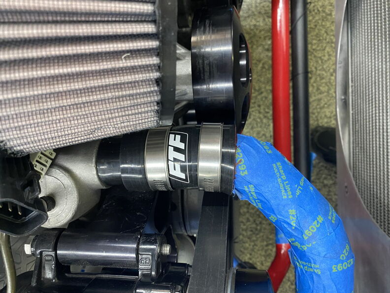

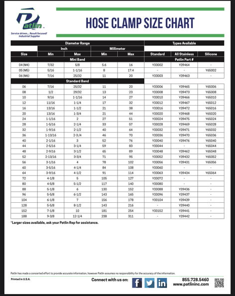

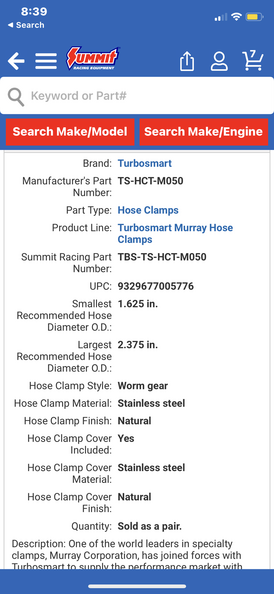

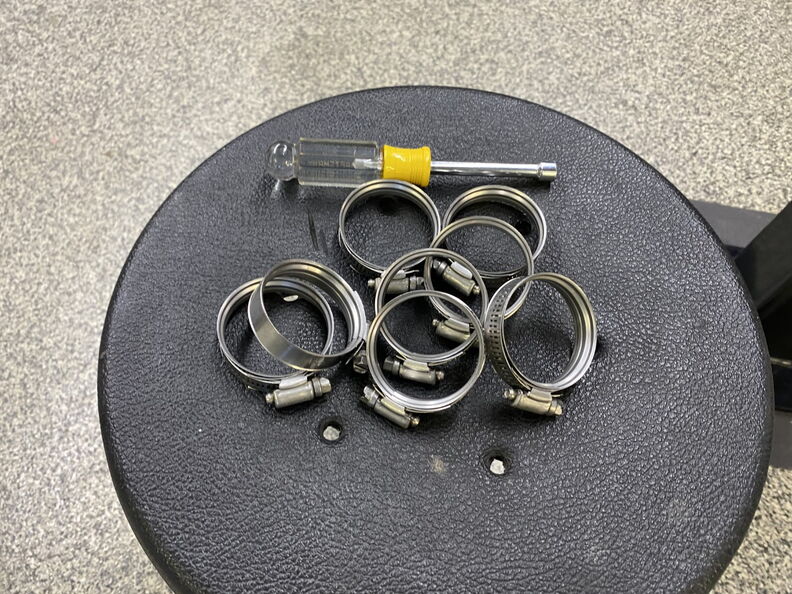

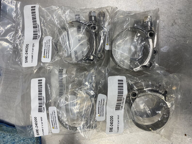

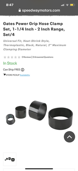

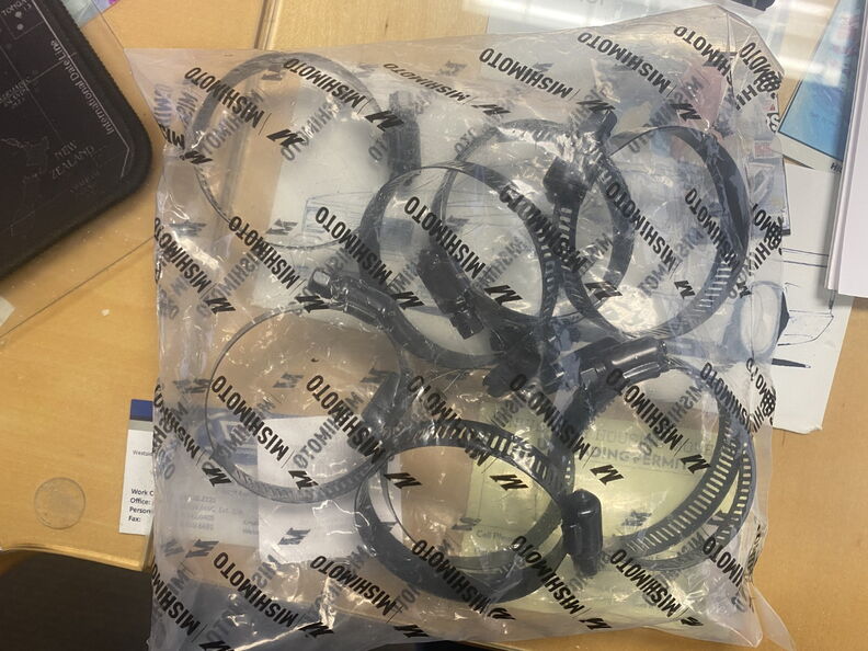

All about Hose Clamps

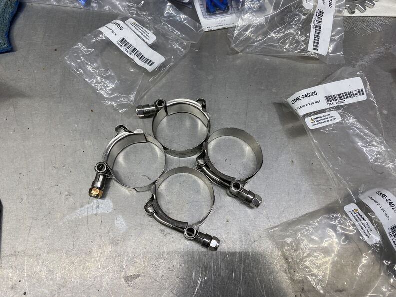

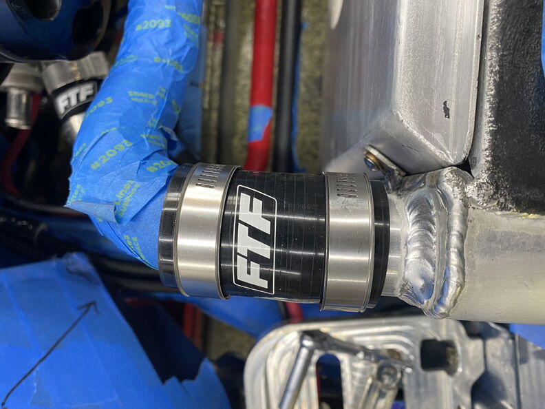

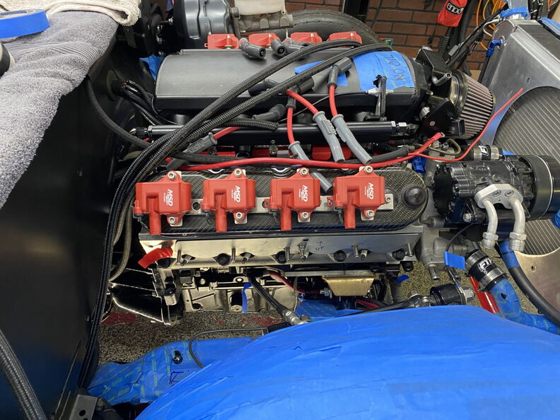

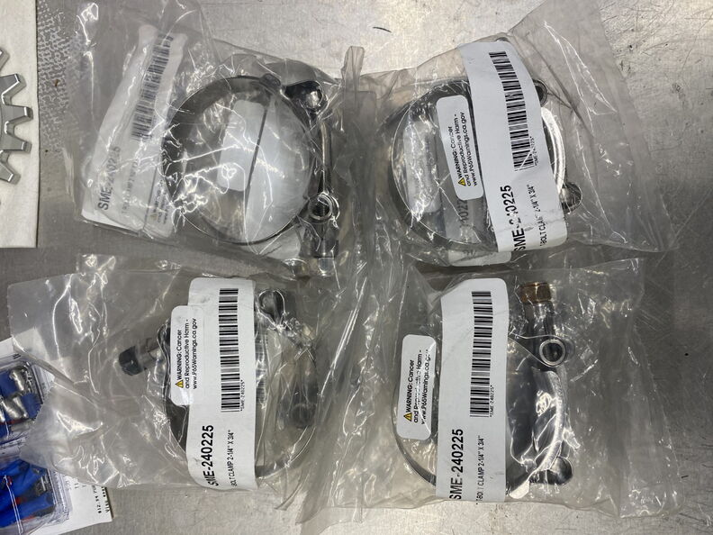

So, I have had a few questions about the hose clamps that I had mocked up on the car. I figure I would share all of the different options that I found and if you have anything that you want to share please feel free to share it.
http://www.garagescene.net/_data/i/u...498a0c5-me.jpg
http://www.garagescene.net/_data/i/u...a4dcd70-me.png
http://www.garagescene.net/_data/i/u...21074f2-me.png
http://www.garagescene.net/_data/i/u...7cdbbc9-me.png
http://www.garagescene.net/_data/i/u...e63cbea-me.png
http://www.garagescene.net/_data/i/u...8fa226a-me.png
http://www.garagescene.net/_data/i/u...2793503-me.png
http://www.garagescene.net/_data/i/u...770f23b-me.jpg
http://www.garagescene.net/_data/i/u...a6f23d1-me.jpg
http://www.garagescene.net/_data/i/u...0e1b02b-me.jpg
Too Big
http://www.garagescene.net/_data/i/u...79e3765-me.jpg
http://www.garagescene.net/_data/i/u...3b30104-me.jpg
Looks much better but you better be wearing steel gloves as these will slice your fingers.
http://www.garagescene.net/_data/i/u...8465d23-me.jpg
http://www.garagescene.net/_data/i/u...c2df2e3-me.jpg
http://www.garagescene.net/_data/i/u...e683bf5-me.png
http://www.garagescene.net/_data/i/u...b0497ac-me.png
http://www.garagescene.net/_data/i/u...255bd3f-me.jpg

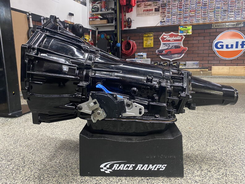

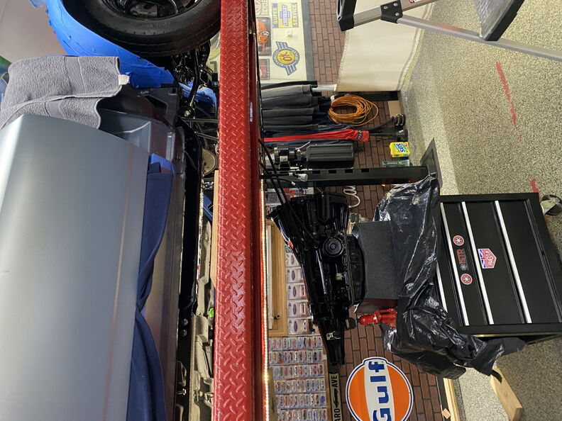

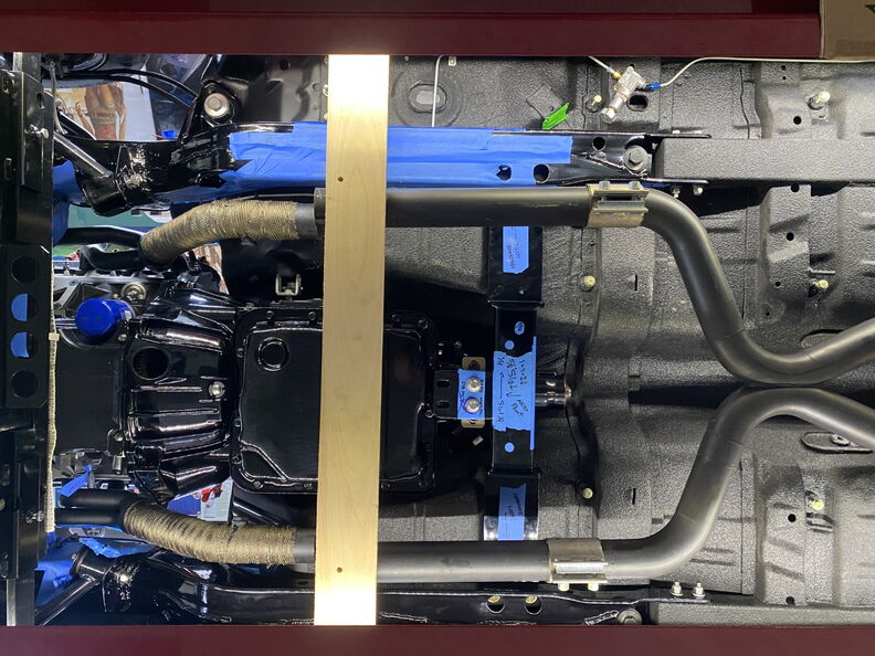

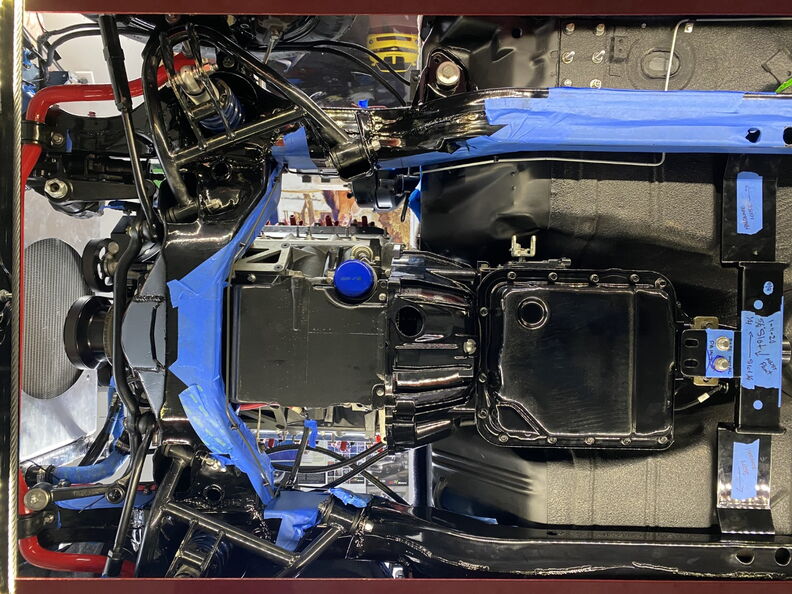

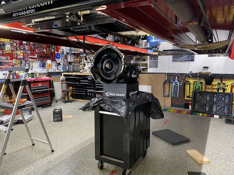

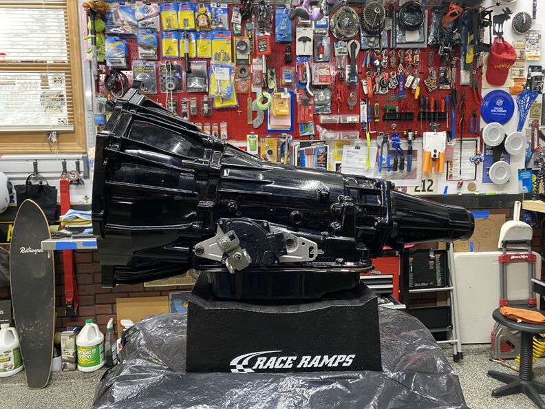

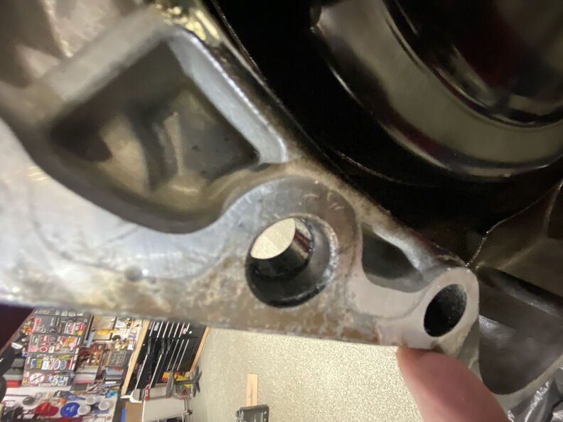

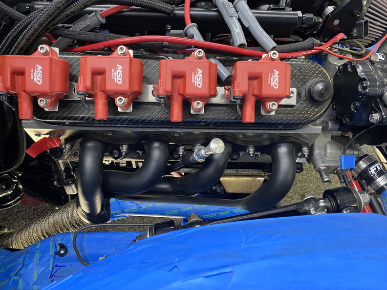

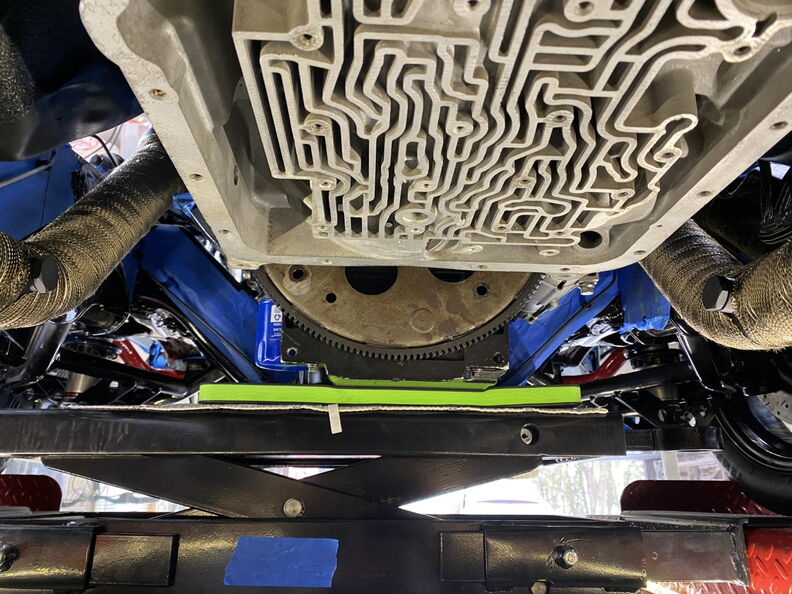

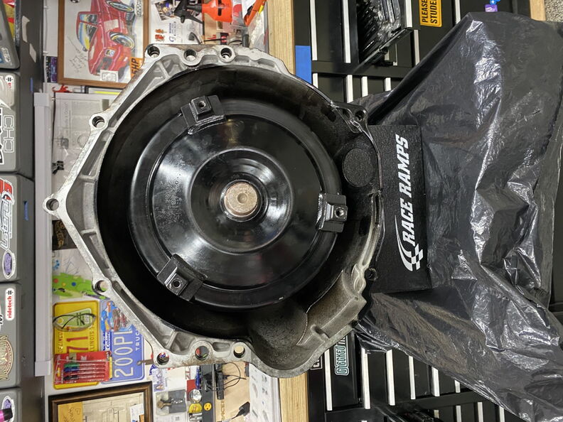

Atomic 4L60e Transmission Final Install (02-28-21)
Hopefully this will be the last time the Atomic Transmission gets installed.
http://www.garagescene.net/_data/i/u...476cd33-me.jpg
I used the lift on the jack to support the engine.
http://www.garagescene.net/_data/i/u...02fafcc-me.jpg

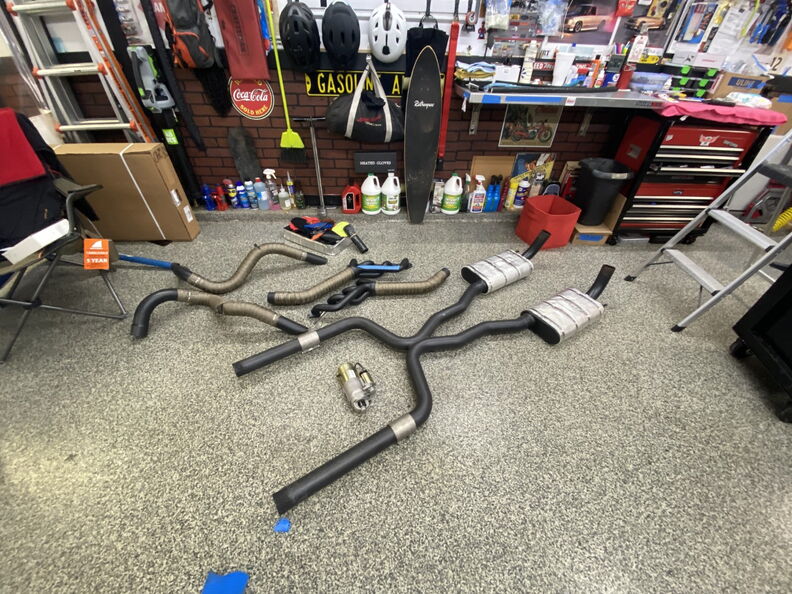

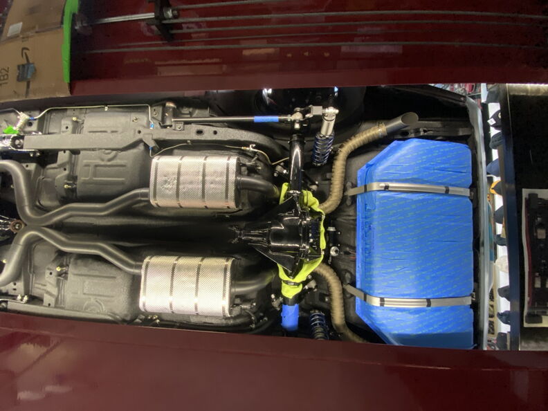

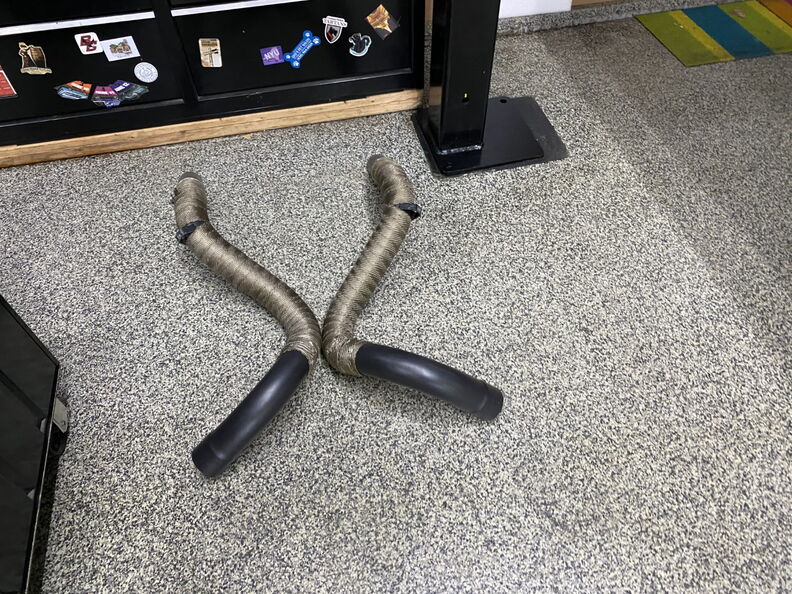

Originally I was going to try to install the transmission with the headers and exhaust installed. However I quickly decided that the 30 minutes it takes me t remove the entire exhaust system would be the way to go.
http://www.garagescene.net/_data/i/u...28a450f-me.jpg
http://www.garagescene.net/_data/i/u...ddd191d-me.jpg
http://www.garagescene.net/_data/i/u...1ea0ffa-me.jpg
http://www.garagescene.net/_data/i/u...d81604e-me.jpg
This is the only nut that is a pain in the ass to get to. Thankfully the motor has header studs.
http://www.garagescene.net/_data/i/u...ed722bc-me.jpg
http://www.garagescene.net/_data/i/u...73cc9ff-me.jpg
http://www.garagescene.net/_data/i/u...18ecd94-me.jpg

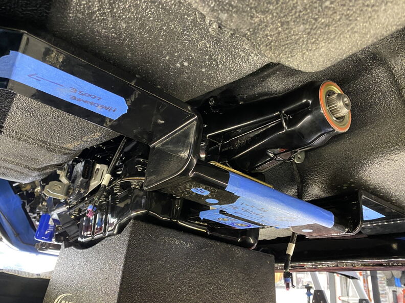

Yes this is the exact height I need to get the trans in the car while it is on the lift.
http://www.garagescene.net/_data/i/u...3b76f34-me.jpg
So the first attempt didn't go as planned. Apparently I forgot to remove the powder coating that was in the alignment hole.
http://www.garagescene.net/_data/i/u...6505ef5-me.jpg
http://www.garagescene.net/_data/i/u...1d1e919-me.jpg
Here we go again. (( Twice as it seems the torque converter moved out the 3rd time ))
http://www.garagescene.net/_data/i/u...a0687e0-me.jpg

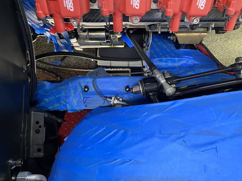

It's hard to see the soft lines I ran for the transmission.
http://www.garagescene.net/_data/i/u...54abc83-me.jpg
http://www.garagescene.net/_data/i/u...1ca181c-me.jpg
Yet to do is replace the trans pan and pan hardware.
http://www.garagescene.net/_data/i/u...f57abba-me.jpg
Time me
http://www.garagescene.net/_data/i/u...5db5b36-me.jpg
http://www.garagescene.net/_data/i/u...d2ee3b9-me.jpg
http://www.garagescene.net/_data/i/u...01c76a9-me.jpg
http://www.garagescene.net/_data/i/u...3df77c0-me.jpg
http://www.garagescene.net/_data/i/u...21d1df6-me.jpg
http://www.garagescene.net/_data/i/u...049af5b-me.jpg
http://www.garagescene.net/_data/i/u...9e870d9-me.jpg
Calling it a night.
http://www.garagescene.net/_data/i/u...66ebc1d-me.jpg

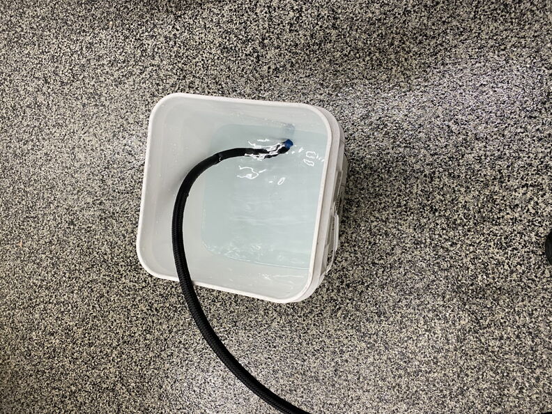

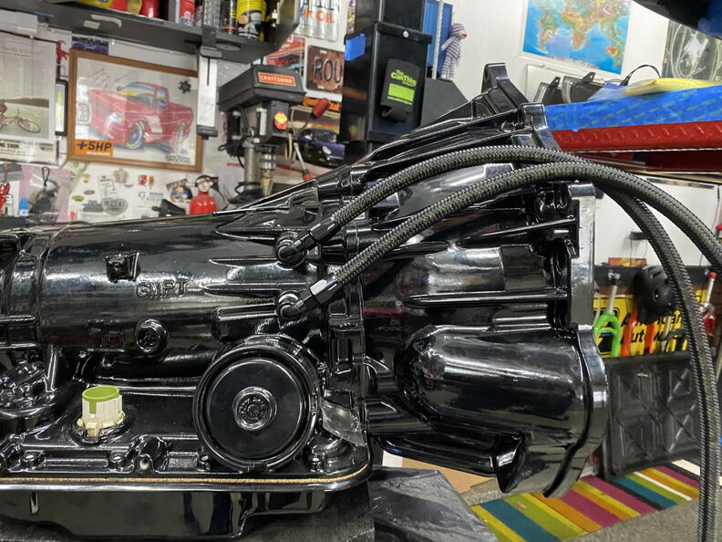

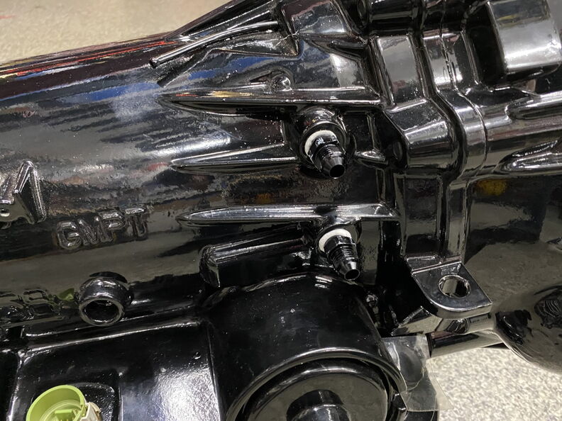

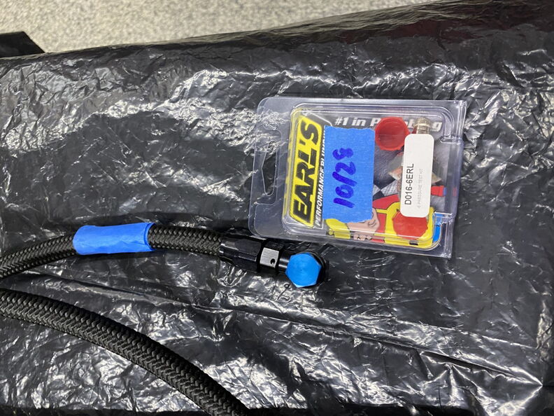

Testing the transmission soft lines ((02-28-21))

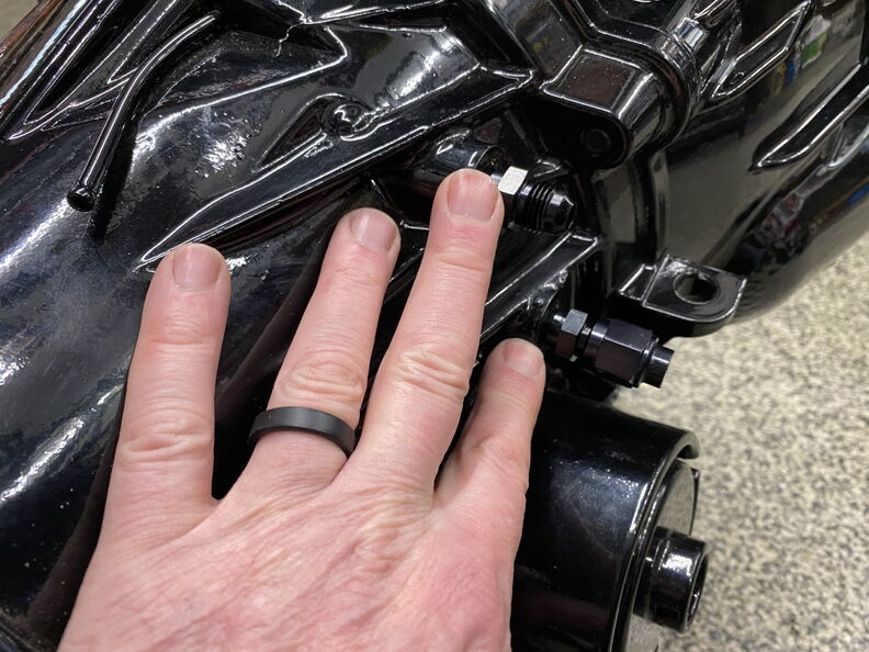

Before the Transmission lines went in I tested them to make sure the lines didn't leak.
http://www.garagescene.net/_data/i/u...fc439fa-me.jpg
No Leaks
http://www.garagescene.net/_data/i/u...57baddd-me.jpg
http://www.garagescene.net/_data/i/u...4326fe6-me.jpg
http://www.garagescene.net/_data/i/u...f526faf-me.jpg
http://www.garagescene.net/_data/i/u...7f9d651-me.jpg
http://www.garagescene.net/_data/i/u...f521eb7-me.jpg
http://www.garagescene.net/_data/i/u...eb1c654-me.jpg
I also installed the knotchead line clamps for the final time.
http://www.garagescene.net/_data/i/u...cbfc963-me.jpg
http://www.garagescene.net/_data/i/u...08933ef-me.jpg

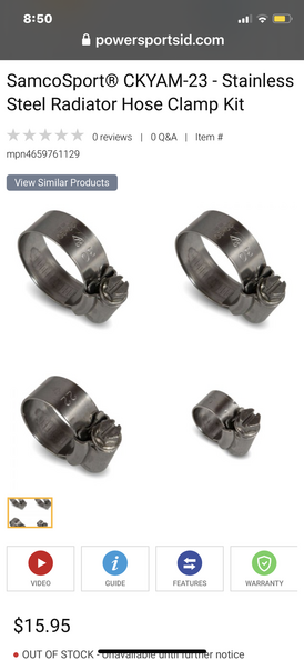

cjfirstgen 06-11-2021 09:25 AM
Another option on hose clamps....you do have to be precise on your measurements for proper sizing. Very clean and finished look for where they are most visible. I could not use them on the interior clamp at the throttle body because of clearance issues.
https://www.phase2motortrend.com/category-s/205.htm
You can see them on the CAI.
https://i.postimg.cc/k4ny6800/DSC-3304.jpg
https://i.postimg.cc/Gh7923Dj/4-DC1-...1-BDD91657.jpg
https://i.postimg.cc/wTT7gR1v/923327...6-BDD5-C62.jpg
syborg tt 06-11-2021 09:18 PM
Originally Posted by Jimbo1367 (Post 713211)
Cyborg TT,
What brand truck bed liner did you use? It looks amazing.
thanks,
Jim
Oddly enough it is just Line-X
Well dang it looks like I will be buying some of these as they are bad ass.
