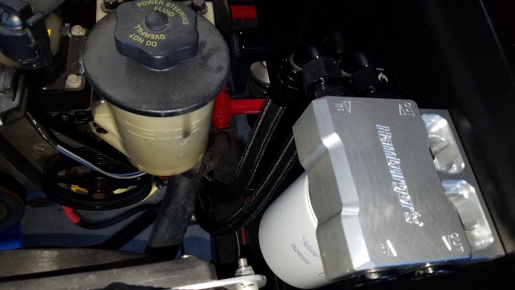

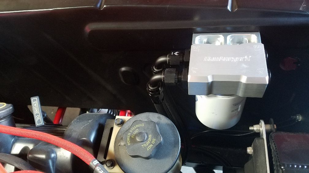

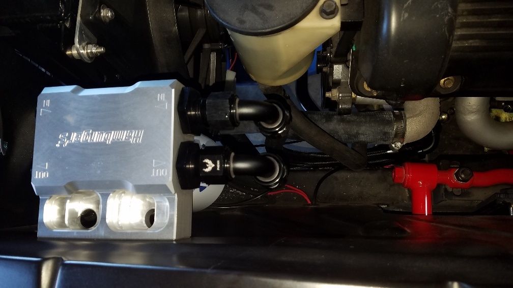

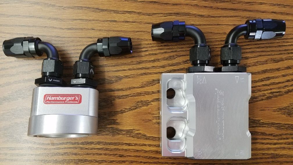

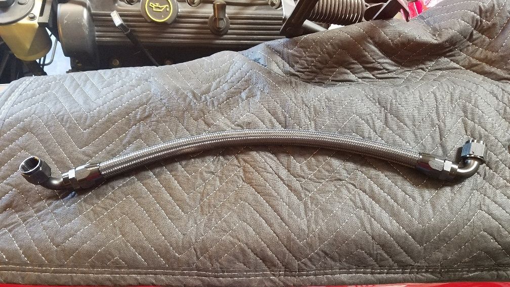

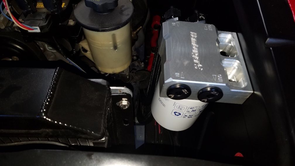

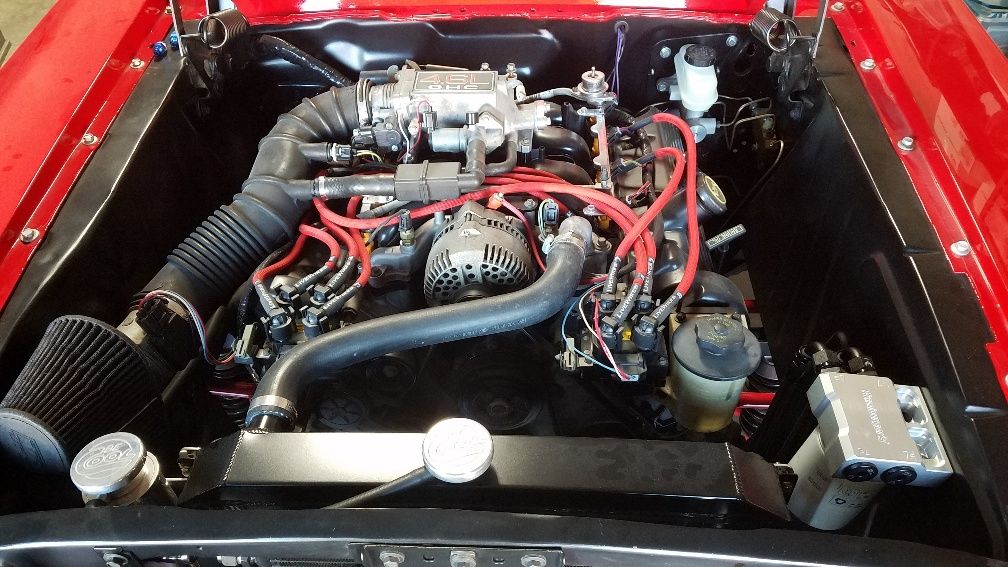

I ordered a remote oil filter kit and when it came in it had large 12 straight o ring fittings with a barbed end the wouldn't clear the frame rail after a long search I found what I needed at Phenix Industries and ordered an adapter that reduced the hose to 10AN with 90 fittings. I was impressed with their products and decided to be a dealer. Nick made the new oil line and mounted the filter on the fender apron.
