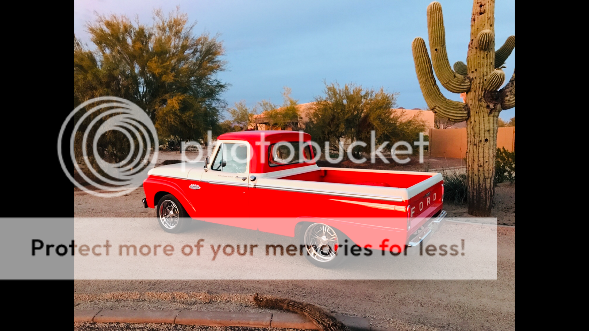

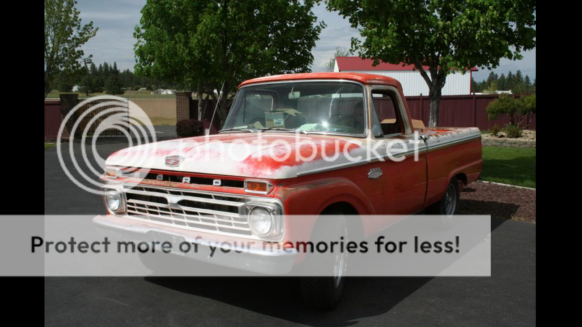

The '18 That I fixed/repaired

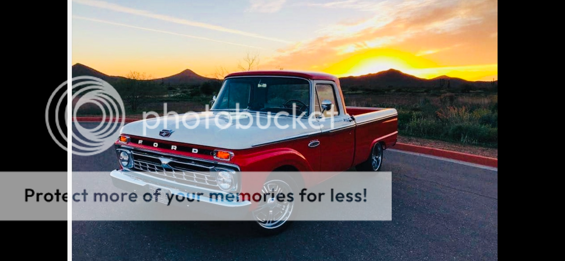

Only allowing one pic at a time. Bought this truck for the Engine and Transmission but was just too nice to part out.

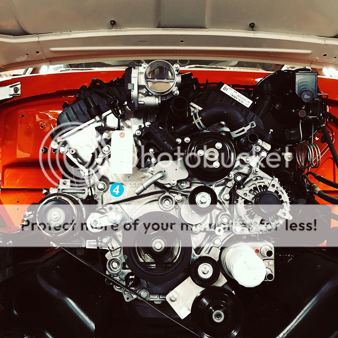

The 1500HP daily driver truck is very slow progress but at least engine is mounted. Hoping tomorrow to start on the custom headers.

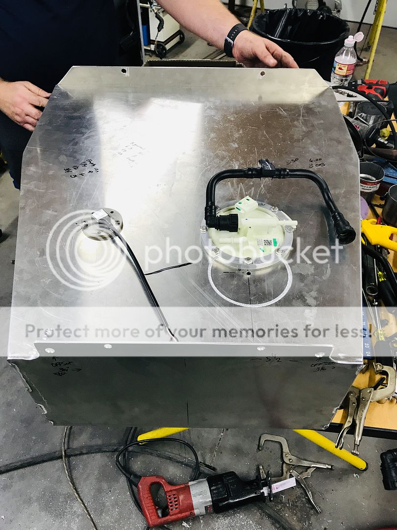

Quickie update on the '66 F100 Raptor
engine, transmission, exhaust, new 27 gallon fuel tank all in. Will have 46 gallon fuel capacity for those long hauls. Shooting for 900 mi per fill at a minimum. Now working on getting all the Raptor components to fit underhood. Lots of plumbing with twin turbo's. Added a 83% larger Garrett cooler. Hoping to have first test drive within 30days.

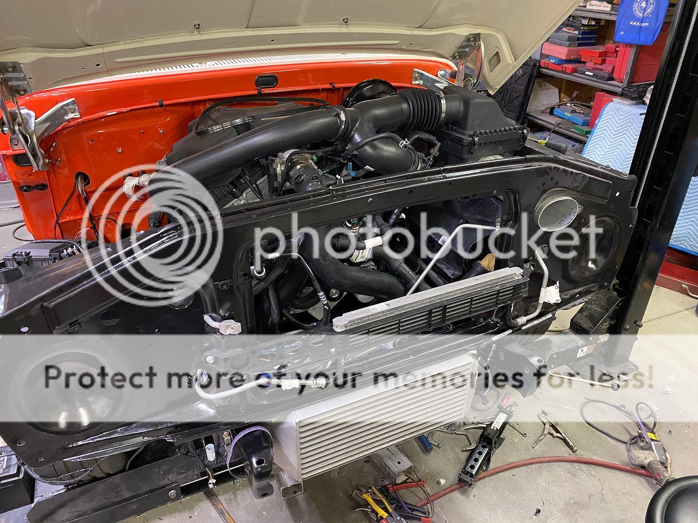

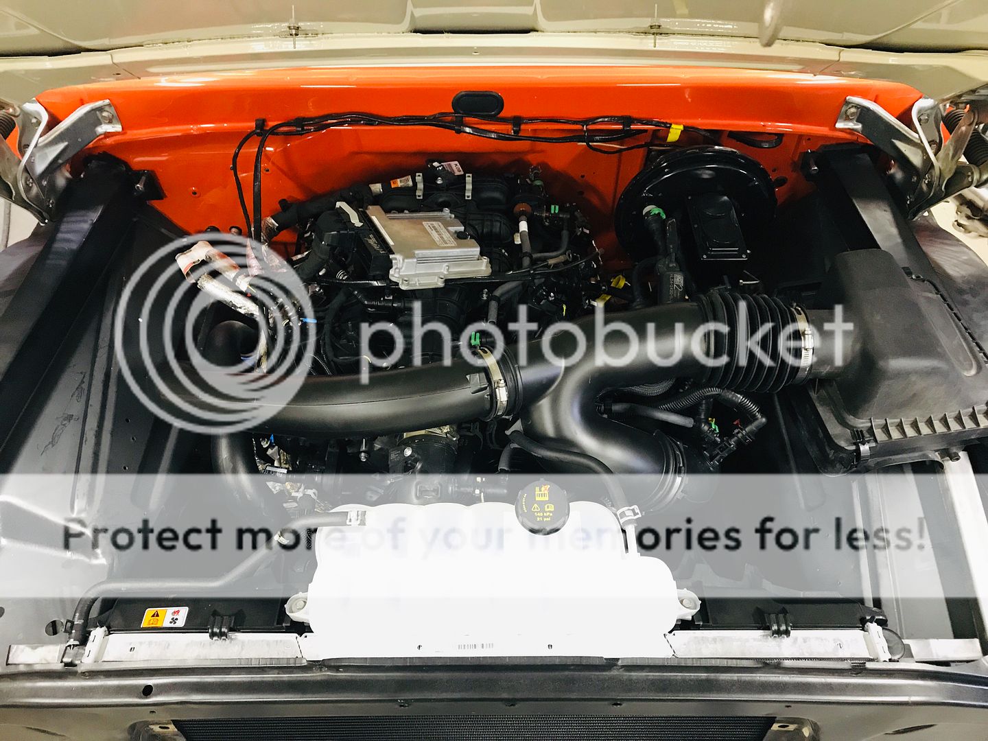

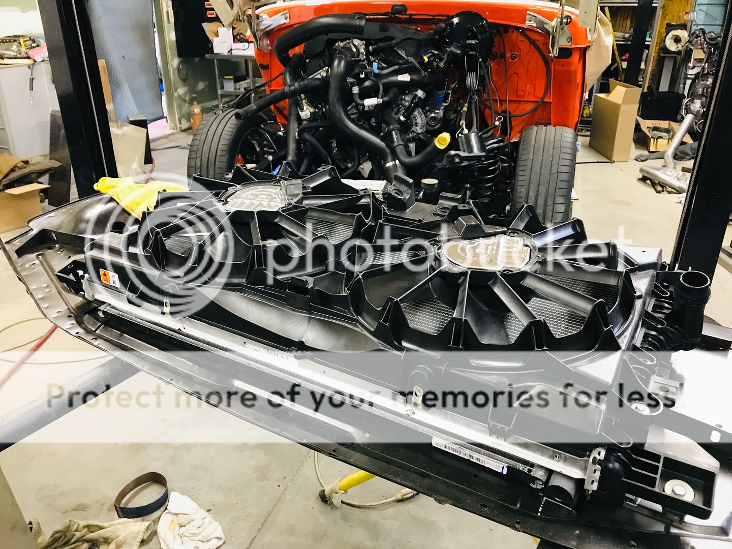

Mostly have all core support, inner fenders fitted. Not much room underhood as engine is very tall because of all the turbo plumbing.

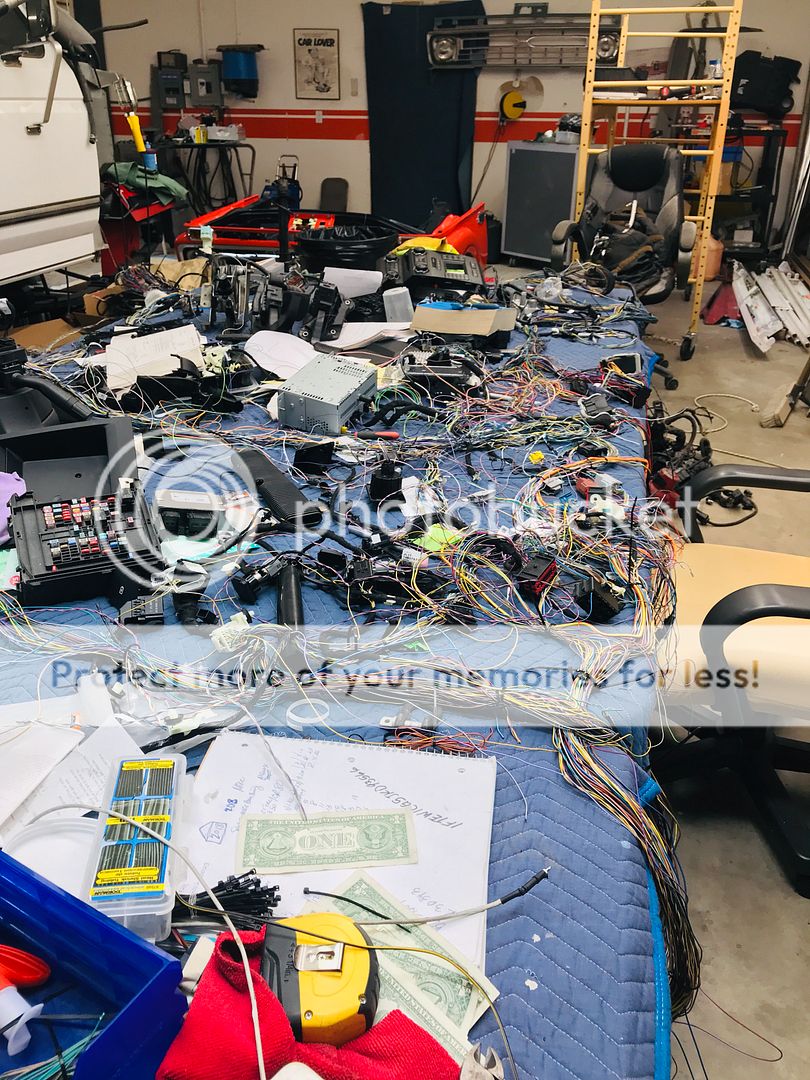

Also had to rotate battery 90 deg to clear radiator. Not a lot of room to fit Battery Junction Box, Pcm and all the wiring. Already had to make harness out of OEM 2018-20 F150 and too much work to try to make each wire perfect length and to put components in different location. Installing those components where wire length will allow. That’s stock F150 location.
No kits avail for the dual fuel system 3.5 EcoBoost.
Now it will take a lot of metal finish work to pretty up the sheet metal.

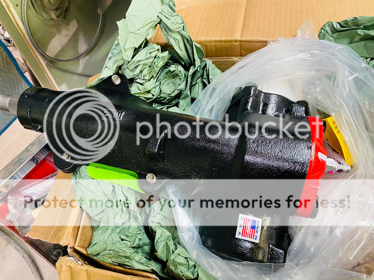

As in photo I added a 16:1 Redhead steering box.
