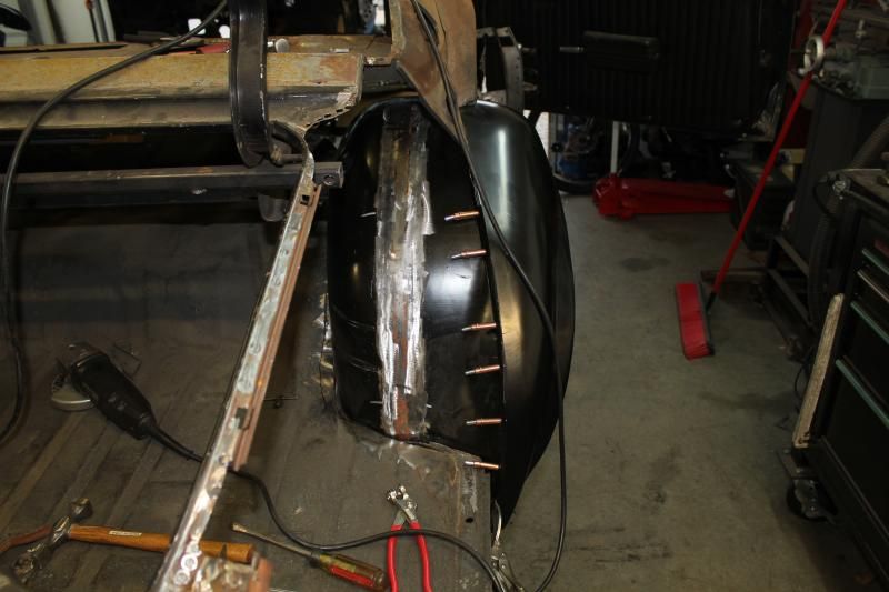

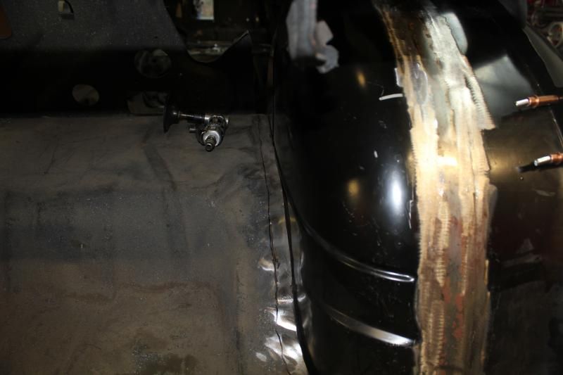

Ok, so here is the update for what I have so far.
http://i115.photobucket.com/albums/n...psf284c2f0.jpg
http://i115.photobucket.com/albums/n...ps9c700cd0.jpg
http://i115.photobucket.com/albums/n...ps546e59c1.jpg
http://i115.photobucket.com/albums/n...ps5d9202ee.jpg
http://i115.photobucket.com/albums/n...ps69f689c8.jpg
http://i115.photobucket.com/albums/n...ps10f34d05.jpg
Che70velle 01-03-2015 05:28 PM
Bill, it looks like your doing a great job. How far did you stretch the inner? How much room do you have, from the lip of the outer, to your inner wall at frame? You'll have your quarter back on before you know it.
HEEP 01-03-2015 07:15 PM
Hey Scott, I have not taken any measurements just yet. I will get some of those tomorrow. I'm hoping for at least 315's or better. I lost count of how many times I took the wells out an in. I talked to RickD today, and he gave me a lot of insight on some things I need to do. I've got a lot of cleko's to put in and probably a couple of pounds of sheet metal screws to get everything set up before welding it all in.
I guess, I can say I am on the downhill side of this at this point. I'll have to say a little prayer that everything else fits up properly.

Scott, I'm measuring 14.5" from the frame to the inner lip of the wheel well. Not sure what that gives me. I'll have to ask the experts or look up some sizes to know for sure.
