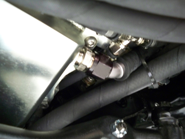

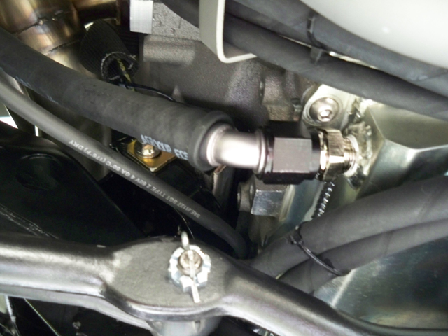

Originally Posted by 4cefed (Post 150557)
post a pic of your return at the pan so i can see it. Ive ran into this problem before and i may have the answer.
here's the drivers side, which is having the problem. #10 pushlock (5/8" i.d.) with a mandrel 90 hose end off the turbo and a 45 degree mandrel hose end at the pan. The passenger side is identical and has no smoke.
http://www.camcojb.com/temp/100_0142.jpg
Here's the passenger side.
http://www.camcojb.com/temp/100_0143.jpg
If I disconnect the drivers fitting at the pan and let the oil drain into a pan it pretty much doesn't smoke; a little, but I'm thinking that's oil in the downpipe. I can't leave it running more than a minute or so as it drains the engine oil pretty fast. As soon as I hook the fitting back up it smokes quite a bit more, but then again, I can also let it run longer, exhaust gets hotter, etc.
