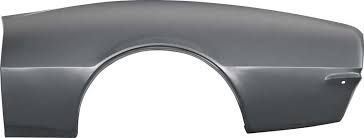

A good start to the changes you want on the rear quarters might be a 68 Camaro panel?http://i1223.photobucket.com/albums/...s71807d4b.jpeg
57hemicuda 06-06-2014 12:27 PM
Funny how all our minds work the same, with the original design, the 67 Camaro quarter was my first thought. I'm pretty sure Torque had the same idea and used it to aid in his photoshop morphing. I immediately saw it, and apparently you did too.
Unfortunately the new design won't allow anything that easy, the bulges I'm now looking for this are more like a 69 Chevelle quarter. In the end I will probably use the eyebrows I cut off a 71 Javelin, and fabricate the rest.
The cool part is, I'm having molds made of the fenders, nose and quarters, so I could mass produce these cars.

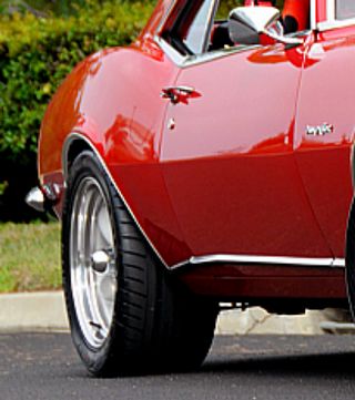

All the morphing I did was with the quarter from a '71 to '74 humpster AMX using it's eyebrow.
Below you can see how much that quarter is flared out comparing it to Carl's Camaro.
’73 AMX quarter
http://i1369.photobucket.com/albums/...ps3e59d965.jpg
Carl’s Camaro quarter
http://i1369.photobucket.com/albums/...ps2986f788.jpg
