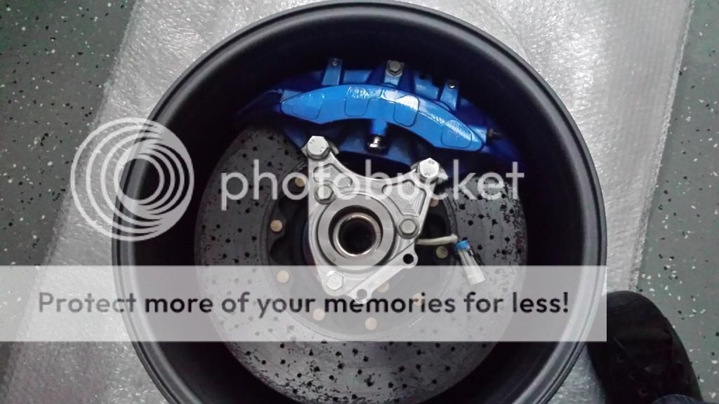

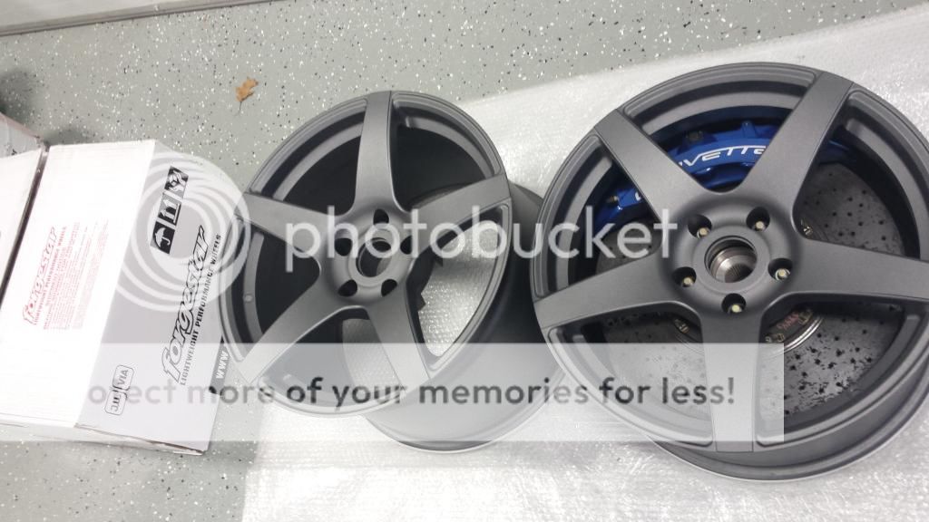

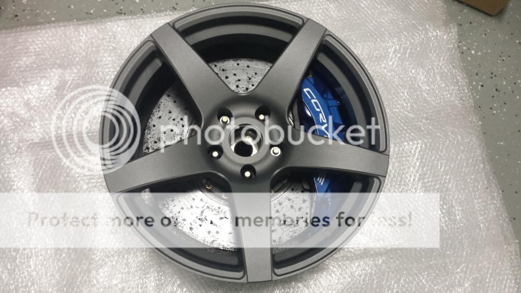

I got some new wheels for the JA2.0 project.
These are 18 X 10 mono block wheels that fit over the 394 mm ZR-1 rotors.
http://i439.photobucket.com/albums/q...psrpr4vqeo.jpg
http://i439.photobucket.com/albums/q...psmxe4iji0.jpg
With the DSE front clip the ZR-1 wheels don't fit anymore.
Mark
andrewb70 01-25-2015 01:43 PM
Those look nice Mark. Who makes them?
Andrew
Stielow 01-25-2015 02:00 PM
Andrew
Forgestar - I got a Black Friday special of $1100 for a set of 18 X 10 fronts and 18 X 12 rears. 7 week lead time. Very nice for the price. If they break I'll be the first to know then the guardrail will be the 2nd to know.
I need a one piece wheel to clear the 15 inch rotors and these do.
The Finspeeds have a better looking rear wheel with a deeper concave. These are still cool for the price.
http://i439.photobucket.com/albums/q...pss8otavys.jpg
Mark
BigJoe 01-25-2015 03:23 PM
bro its function over form, i think they look great. We would all want more lip but for the price that are bad ass.
Vince@Meanstreets 01-25-2015 03:26 PM
Wow, nice price and do they fit the front without spacers?
Stielow 01-25-2015 04:02 PM
The front are 18 X 10 with 6.125 backspacing so they do not need spacers.
The rears are 36 mm offset so I'll set axle width so no spacers.
Mark

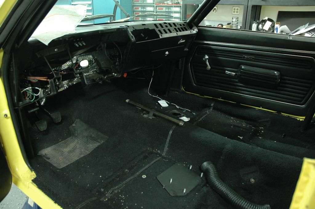

As part of the rebuild, JA is getting all new wiring. Ryan started making the new engine/trans harness.
http://i1158.photobucket.com/albums/...2/DSC_3216.jpg
The interior will also be refurbished. The steel pipe on top of the trans tunnel is holding up the trans through the shifter opening using a nylon rachet strap.
The original trans crossmember was removed with the old subframe. A new crossmember (built into the floor) will be fabricated like was used on Hellfire.

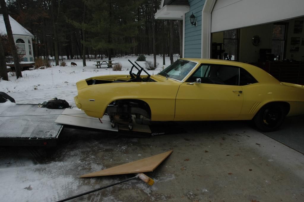

formula88 01-25-2015 06:18 PM
I think I saw this trailer loading method before on History Channel Egyptian pyramid building episode.
http://i1158.photobucket.com/albums/...2/DSC_3233.jpg

Che70velle 01-25-2015 07:03 PM
Is that a creeper underneath the front crossmember?
Whatever it is, that's a brave move.
Sieg 01-25-2015 07:14 PM
Nices stoppers and score on the wheels!
The wheel dollies and ramp set up is......uh......functional. :)

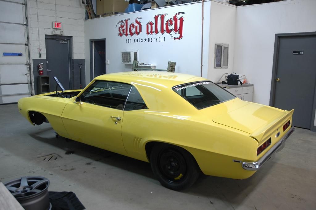

The plan is coming togther. Matt at Sled Alley is working on JA and Thomson Auto has the short block just about done.

wiedemab 01-28-2015 08:03 AM
Prepping it for a vinyl top? ;)

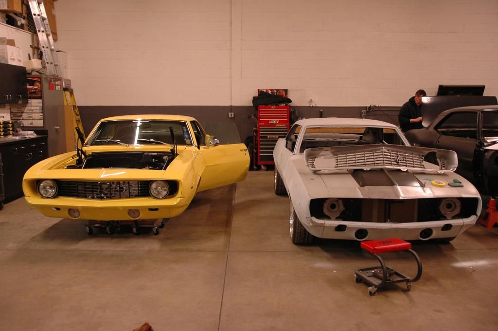

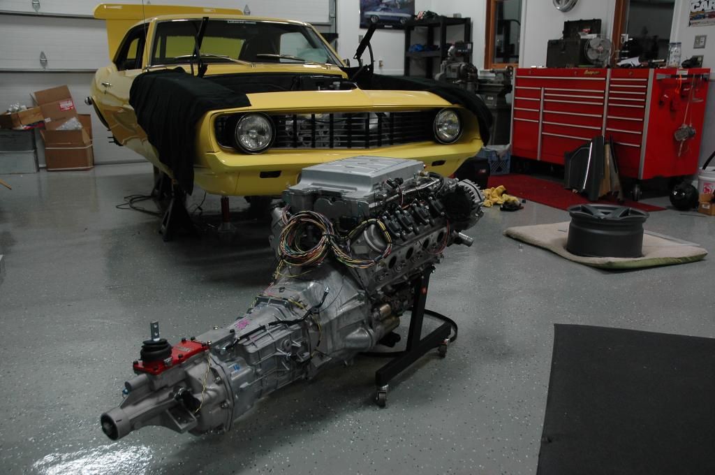

Stielow 02-01-2015 10:04 AM
Things are moving forward.
Thomson finished the short block so we will swap of the top end and the engine will be ready. Bran has the same engine in his Vett and on E-85 it cleared over 1000 HP.
http://i439.photobucket.com/albums/q...pstddagpuv.jpg
Across town Sled Alley has a good start on the vehicle modifications. Matt and I really like the way the under hood looked and worked on Hellfire so we are sinking the dry sump tank in the cowl again. We added a little more oil volume this time. The system should be 16 quarts when we are done. We are going to make an access in the inner fender so we can service it this time.
We are filling all the odd holes in the firewall and welding up the bars that pass through the fire wall. They always rattled.
Matt should have the transmission cross member done this week.
http://i439.photobucket.com/albums/q...psardxzwob.jpg
http://i439.photobucket.com/albums/q...pswgeegut5.jpg
http://i439.photobucket.com/albums/q...ps9hkb5mjd.jpg
http://i439.photobucket.com/albums/q...psdky6tugk.jpg
We should have the new radiator from C&R in 2 weeks. Once we get that we can finish the engine bay.

• Repaint outside mirrors
• Repaint front bumper
• Touch up roll bar
Car back to my house to plumb it and wire it.
Stage 4
• New carpet
• New recovered back shelf
Stielow
