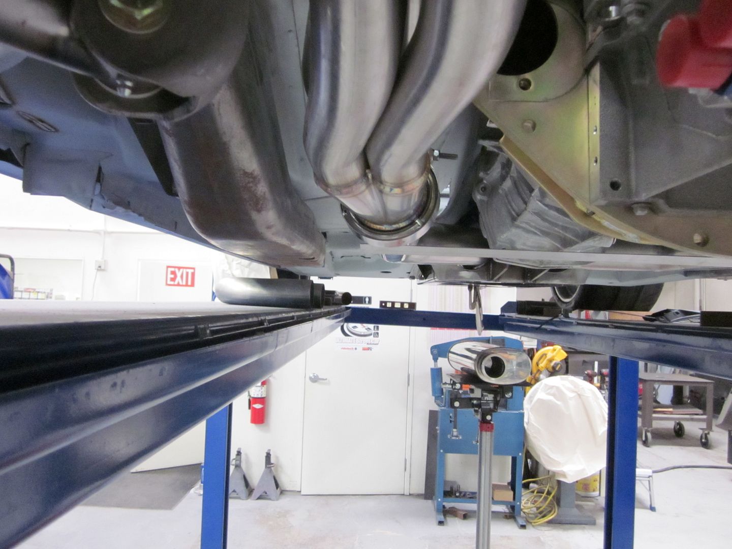

Randy, Great Build! I have the same project going on. Can you tell me more about the header fitment? I have the DSE front subframe, the DSE engine mounts to locate in the stock position. Did you have to modify anything to get those headers to fit? Until I saw your build I didn't find any headers that worked for this combo. Which mounts did you use? Thanks for the help.
John
randy 09-29-2013 06:35 PM
John
let me pull out my ticket for the headers so i have all the part numbers. Nothing had to be modified. They fit great. I think they are the best headers for the money. I would have liked to have the dse ones because they are meant for the car and fit the best buy couldnt justify the cost right now. Headers hang maybe a inch below the subframe.
DSE header fitment ( not my car )
http://i1015.photobucket.com/albums/...n/IMG_0664.jpg
http://i1015.photobucket.com/albums/...n/IMG_0665.jpg

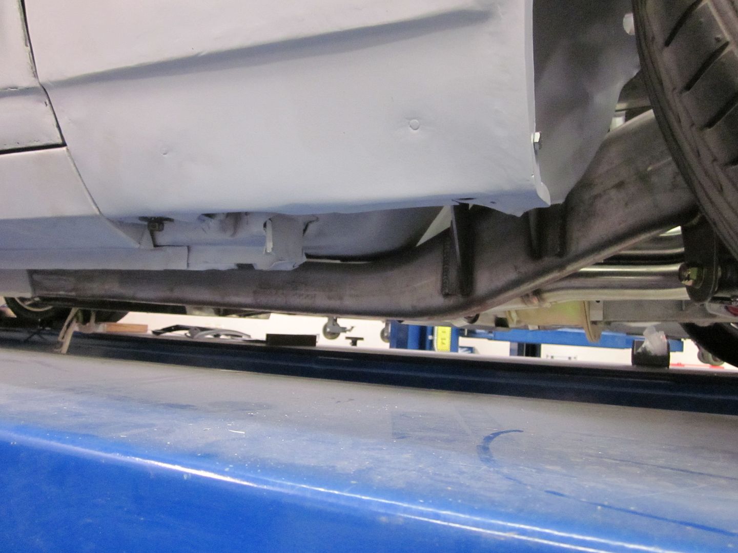

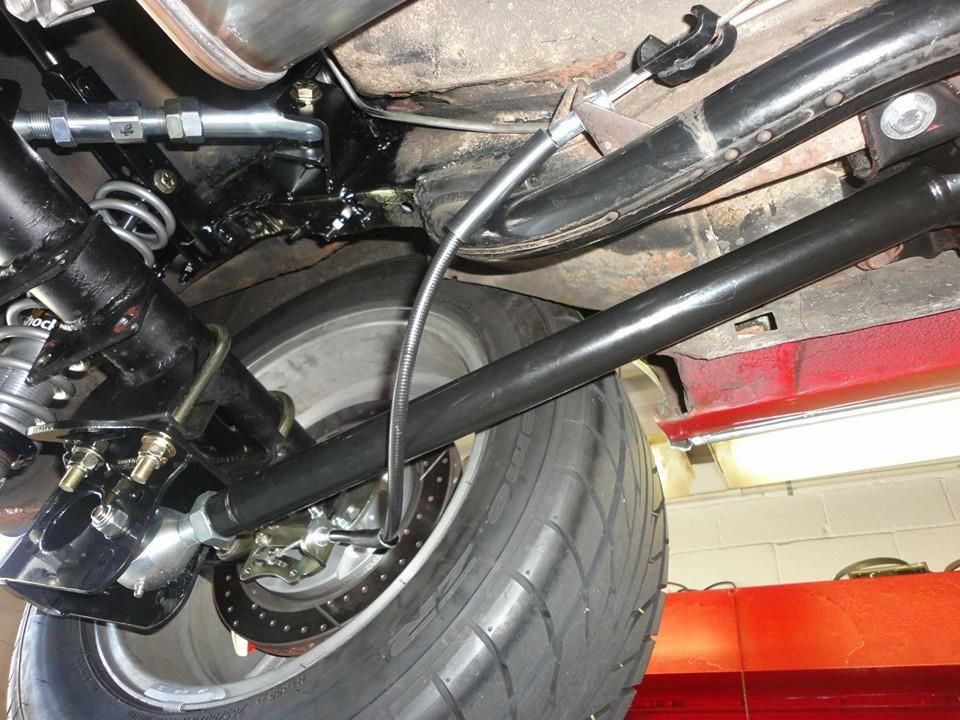

Parking brake assembly is installed. I wanted to use the most factory parts that i could so i bought a stock parking brake cable kit to use with my c6 brakes. The two rear cables would have been a pain to attach plus they were little long. I managed to open up the hole on the rear brake cable mount to 9/16 and i ordered 1988-1996 corvette rear ebrake cables from oriellys for $20 each using ac delco part number 19143753. These cables are much shorter and fit perfect with my brake kit and quadra link. I will attach pictures but they are not of my car since the car isn't high enough to get pictures. I then used the front cable of my kit and hooked it up to the brake and ran the line thru the subframe. Now here is where i had another problem. The intermediate cable was too short. The correct non big block cable that comes with my car from the factory is 79" long. i need about 3 more inches. Luckily firewheel classics also makes another cable part number pbk-11r for the big block camaro that is 82" long. This will work perfect.. Long store short you want the following :
1988-1995 corvette rear ebrake cables ac delco part number 19143763
67 camaro big block intermediate cable pbk-11r
front cable pbk-10a
Drill out the kore 3 bracket to 9/16"
http://i30.photobucket.com/albums/c3...earebrake3.jpg
http://i30.photobucket.com/albums/c3...earebrake2.jpg
http://i30.photobucket.com/albums/c3...15633014_n.jpg
http://i30.photobucket.com/albums/c3...14268194_n.jpg
http://i30.photobucket.com/albums/c3...92039921_n.jpg
randy 12-17-2014 07:16 PM
new softseal door weather stripping is done, rear brake assembly done, rear calipers and pads done, parking brake cables done, parking brake installed, wiper transmission installed and centered, cowl hood installed, gaps are where i want them to be, car is dynolined, panels are dynamated, windows are aligned, rear speakers installed, rear package tray,
Next up is probably doing some wiring. I have everything i need except exhaust, engines/ trans, vintage air, fuel lines, and front seats. Everything else is waiting to be installed
