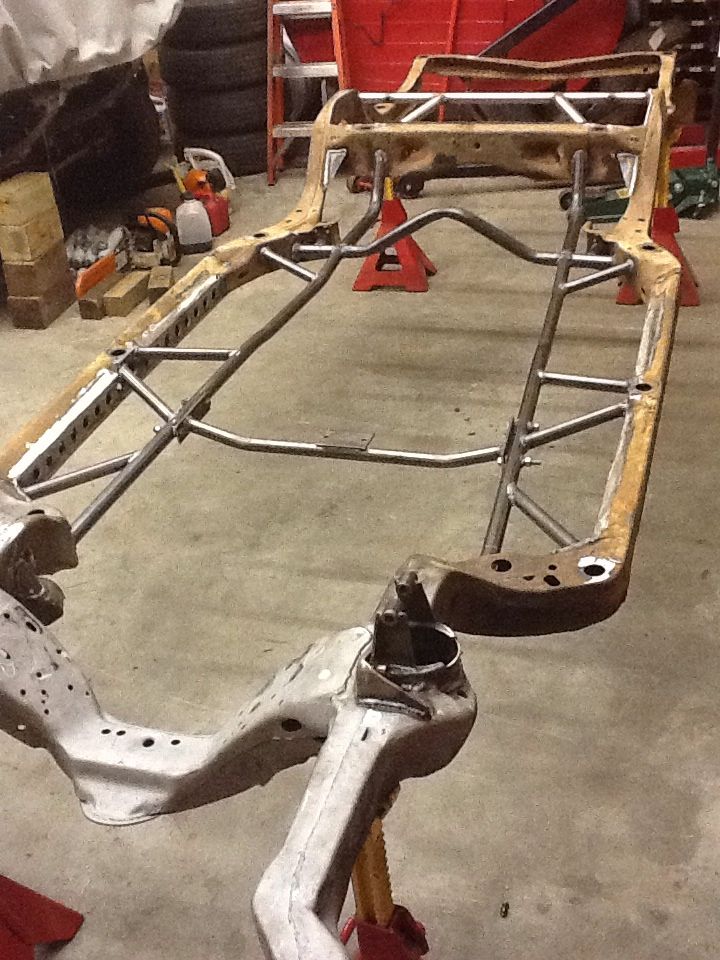

Hey Scott. Your build is awesome and a great inspiration. I have a 69 Chevelle and wanted to do the same type of thing you did to your frame. Did you self bend all the tubing or do you know of a kit i could get. Again, the build looks wicked. Keep up the great work. :thumbsup:
-Andy
I don't post links in other peoples threads unless the OP asks, but lookup HPI-Customs. They have a kit similar to what Scott put together.
Che70velle 07-08-2014 08:15 PM
Chris, I'm running a Tanks Inc. New style tank with baffling, and a Walbro 255 internal pump with Vette regulator.
The above mentioned HPI frame bracing kit is a nice piece, but doesn't add a crossmember, which I felt like was needed to make the frame more rigid.
GregWeld 07-12-2014 02:31 PM
A lot of work in this chassis! Nice welding by the way! That's getting it done.

Che70velle 07-13-2014 11:35 AM
Greg, I do like that website! Thanks for the linky. Unfortunately for me, I do everything the old school way, including my notches. I simply don't do enough tube notching to warrant me spending the coin, if you know what I mean, so I use a scribe to locate my pilot hole, then use a holesaw. It's a lot of wrist-breaking work, but it works for me.
