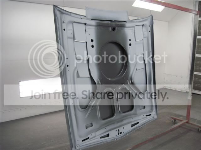

Matt@BOS 10-18-2010 08:06 PM

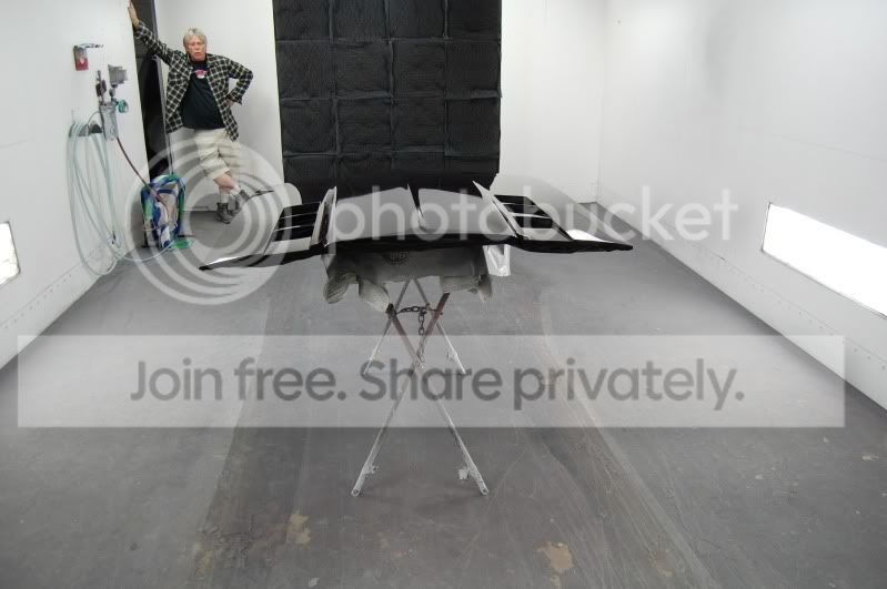

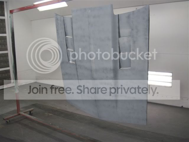

Pictures for today:
Jon and Jesus are just about done with color sanding the car to 3500 grit and will begin buffing tomorrow.
http://i366.photobucket.com/albums/o...SA/shop131.jpg
http://i366.photobucket.com/albums/o...SA/shop130.jpg
http://i366.photobucket.com/albums/o...SA/shop134.jpg
http://i366.photobucket.com/albums/o...SA/shop132.jpg

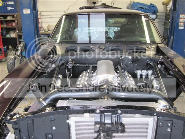

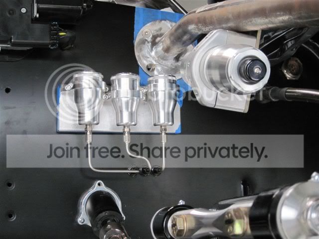

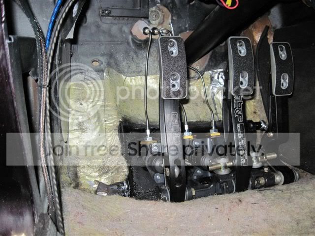

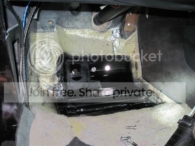

Headers were the least of our worries. The biggest headache was related to fitting everything around the DSE frame, which unlike other aftermarket frames has hydroformed rails which hug the contour of the floor really closely. This little issue required us to punch a hole and do a little trimming on the sides of the bushing mount. The whole process would have been a bit easier on a car with a Morrison, Speedtech or 21st Century frame
http://i366.photobucket.com/albums/o...SA/shop121.jpg
http://i366.photobucket.com/albums/o...SA/shop129.jpg
http://i366.photobucket.com/albums/o...SA/shop128.jpg
http://i366.photobucket.com/albums/o...SA/shop126.jpg
I dropped the floater off at Speedway this morning after getting stuck in bumper to bumper traffic at 5 a.m. - I hate L.A. - so hopefully I can pick it up Friday. It'll get powder coated next Monday, and likely be under the car Thursday. If everything goes well we'll be driving it next Friday/Saturday, maybe...
Matt

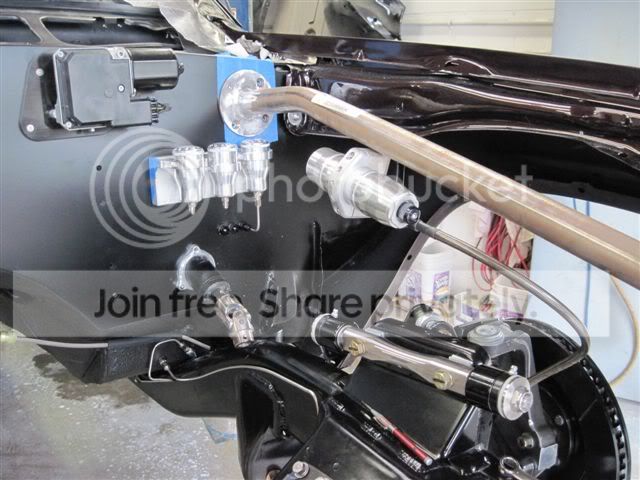

Ron in SoCal 10-20-2010 10:24 AM
Great update Matt. I figured the hydro formed sub was the issue. Questions for you -
Did you have to fab the floor due to ergonmics (fwd or back) or just to make room to mount the pedals?
Those masters are beautiful! Whose are they?
How/where do you adjust the balance bar in this set up?
I take it these pedals don't work w DBW? If not and I needed to use a GM pedal/double Tiltion, do you think the heel toe action would be as natural?
Sorry for the barrage, but I love the thinking that went into this. I actually brought up floor mounted pedals question to Chris in a thread when he rolled out his beautful billett pedal arms. Thanks to you and Dick for blazing the trail here...:hail:
tones2SS 10-20-2010 11:28 AM
Very nice Matt. Nice upgrades. Might as well while you have her torn apart, right?:unibrow:
I can't wait to see the hood all painted on the car. I bet it's going to look bad ass.:bow: :cheers:
Matt@BOS 10-20-2010 12:11 PM
Ok, let me do my best to answer these questions without forgetting anything,
the floor had to be modified for a couple reasons:
1. the pedal box with the M/Cs installed is pretty deep, and sits at least 4" closer to the driver than the stock hanging pedals. For any normal person to operate the pedals comfortably they'd have to be in the back seat.
2. angle of the pedals: without modification, the pedals would stick straight up and down, perfectly perpendicular to the floor at 90 degrees. Angling the pedals back was predominantly based on ergonomics, but also done to give space because the top of the pedals that the driver's foot rests on is now farther back.
Are you talking about the actual master cylinders, or the reservoirs? the masters are from Tilton, and the reservoirs are three of the Ring Brothers clutch reservoirs.
The balance bar is adjusted at the base of the brake pedal. You just loosen the nut and move it left or right depending on whether you want more front or rear bias.
As far as I know the Tilton three pedal assembly is limited to a mechanical throttle cable. If you used the two pedal assembly and the GM drive by wire gas pedal I imagine after a little planning everything could be made to fit "naturally." Personally, I would just use Tilton's hanging brake/clutch setup if I was running a drive by wire pedal - or just ditch drive by wire altogether.
Hope that answers some of your questions.
Matt

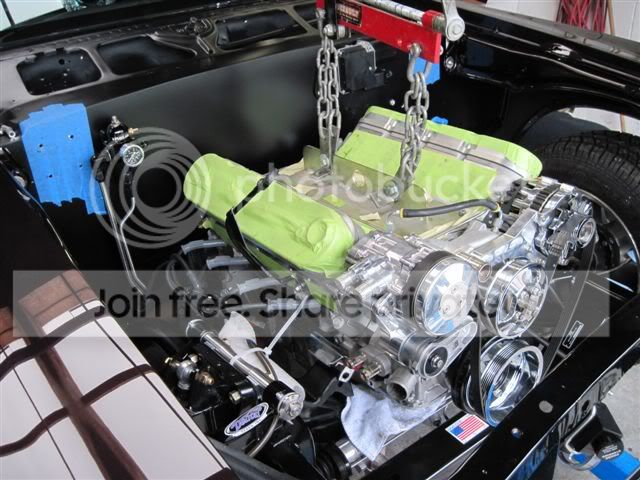

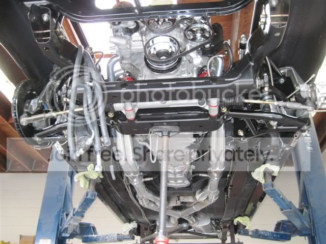

I know, Dick sent me some photographic proof. I think all of your engine swappage over the last year has really benefited me. This probably only took them 15 minutes today.
http://i366.photobucket.com/albums/o...SA/shop136.jpg
http://i366.photobucket.com/albums/o...SA/shop137.jpg
http://i366.photobucket.com/albums/o...SA/shop138.jpg
http://i366.photobucket.com/albums/o...SA/shop140.jpg
http://i366.photobucket.com/albums/o...SA/shop139.jpg
Matt

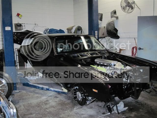

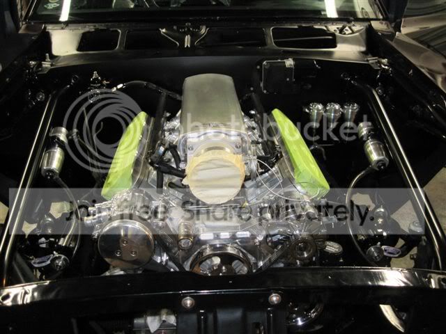

The guys took care of some more odds and ends, including putting the exhaust on and re-chromed and straightened rear bumper back on. The hood looks like it is ready for it's final prime. The engine bay is coming together nicely as well. Roughly 9 days left, and there might actually be a somewhat manageable amount of work. Well, at least compared to last year.
http://i366.photobucket.com/albums/o...SA/shop142.jpg
http://i366.photobucket.com/albums/o...SA/shop143.jpg
http://i366.photobucket.com/albums/o...SA/shop144.jpg
http://i366.photobucket.com/albums/o...SA/shop146.jpg
http://i366.photobucket.com/albums/o...SA/shop149.jpg
http://i366.photobucket.com/albums/o...SA/shop150.jpg
Matt

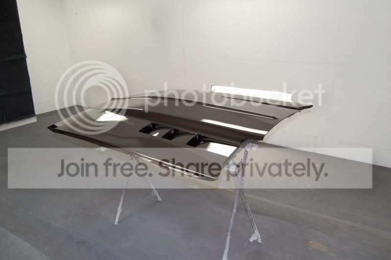

Well, the last couple days have been busy. We got the engine running again, but it needs to be tuned. Most of the interior went back in and other little things got assembled. Oh yeah, and the hood got painted!
http://i366.photobucket.com/albums/o...A/DSC_0739.jpg
http://i366.photobucket.com/albums/o...A/DSC_0740.jpg
http://i366.photobucket.com/albums/o...A/DSC_0742.jpg
http://i366.photobucket.com/albums/o...A/DSC_0741.jpg
Matt
