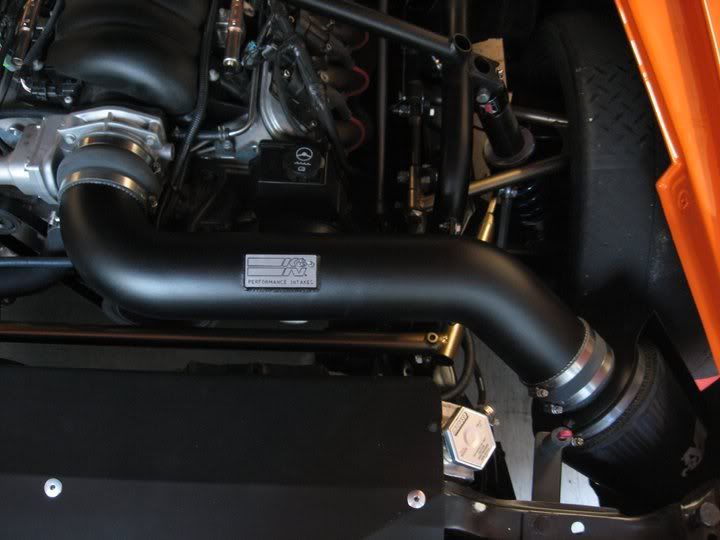

73CPCAMARO 07-26-2011 10:57 AM
I picked up the Camaro from K&N yesterday. They did a great job building a custom intake for my car. They got 16+ hp and 16+ ft lbs more than my previous setup.
http://i80.photobucket.com/albums/j1...b/KNintake.jpg
srh3trinity 07-26-2011 04:54 PM
That intake looks nice and sounds like it is functional to boot. This turned out to be my favorite second gen Camaro. Gives me something to shoot for with my Firebird.
