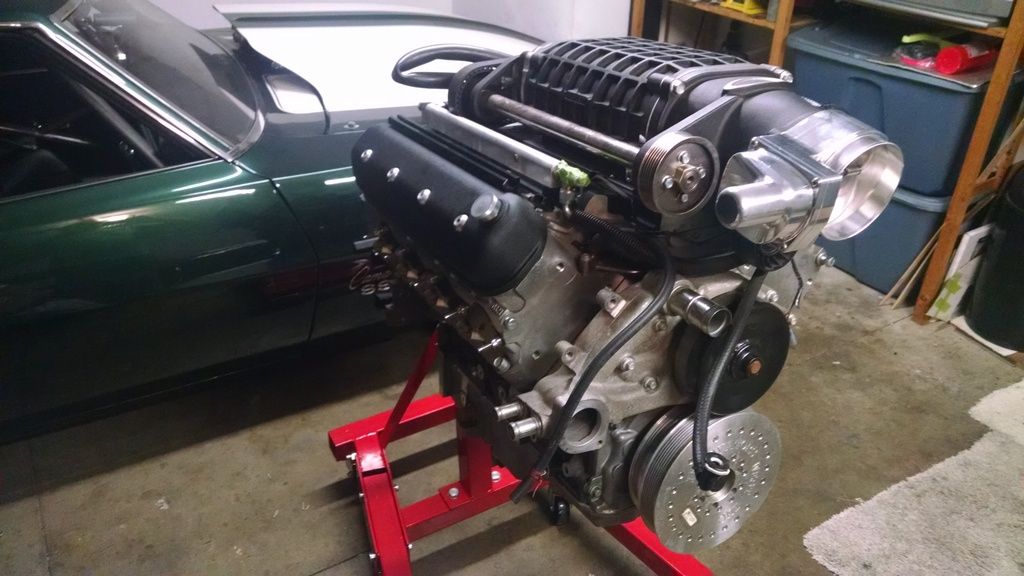

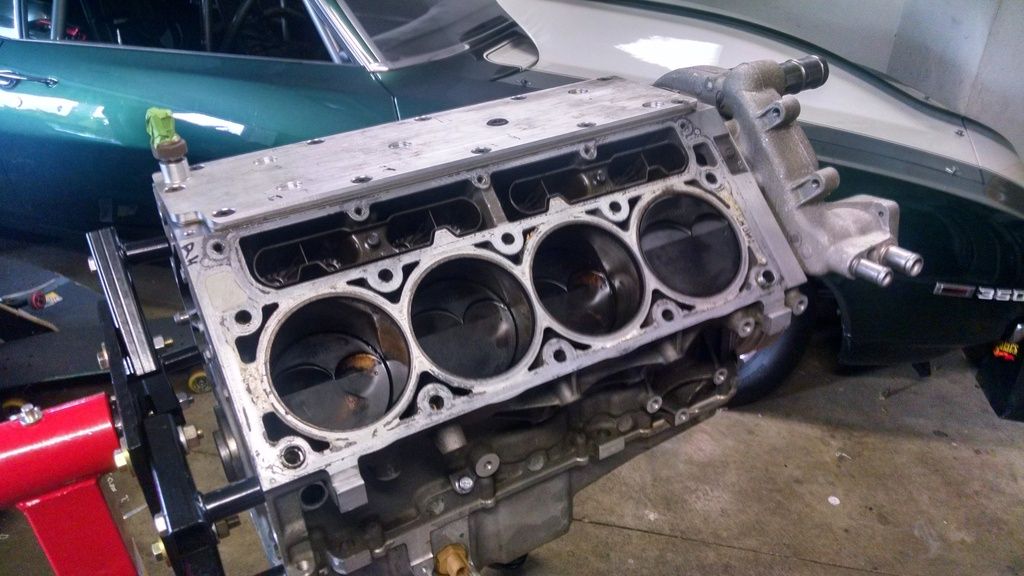

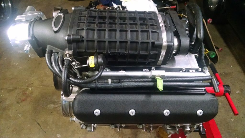

Posting an update to my dead thread, because I finally have a legitimate one.
I purchased a motor for the car from a member here, and in typical fashion for me, it was an unbelievable deal. I am still sticking with the one modification at a time plan, and putting the pieces together slowly over time to put in my DSE front subframe--but when I make this mod, I will rewire the car at that time along with a couple other things, including installing the latest acquisition.
http://i632.photobucket.com/albums/u..._201559033.jpg
http://i632.photobucket.com/albums/u..._201759248.jpg
http://i632.photobucket.com/albums/u..._201204895.jpg

Nice lookin' engine there Doug. The LS motor is going to look right at home in your engine compartment. I'm still diggin' you're one mod at a time philosophy, good stuff.

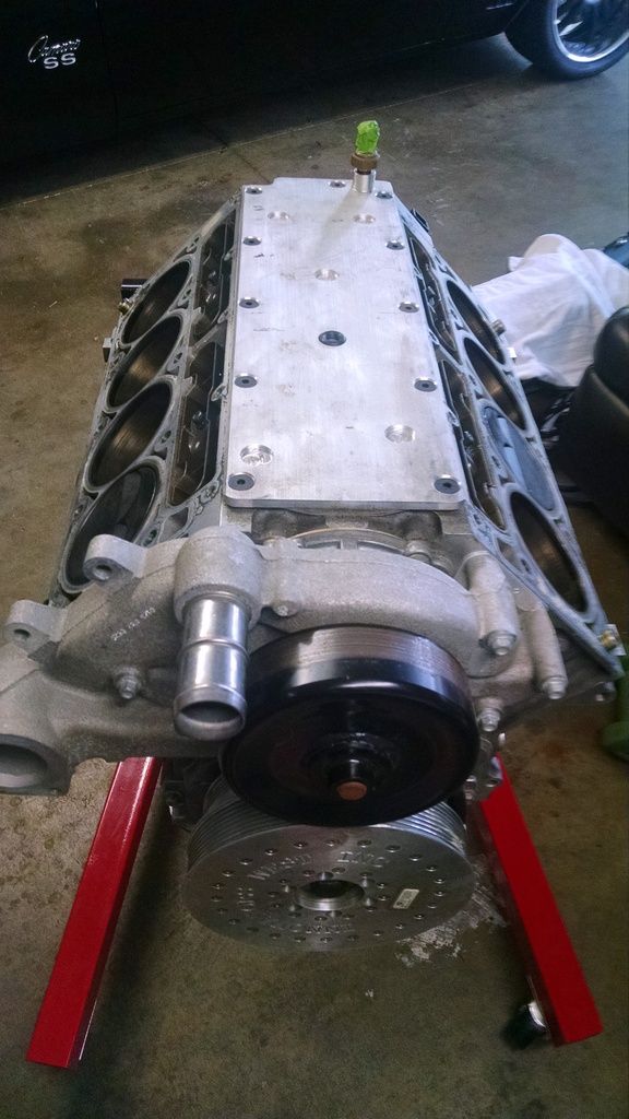

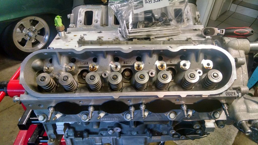

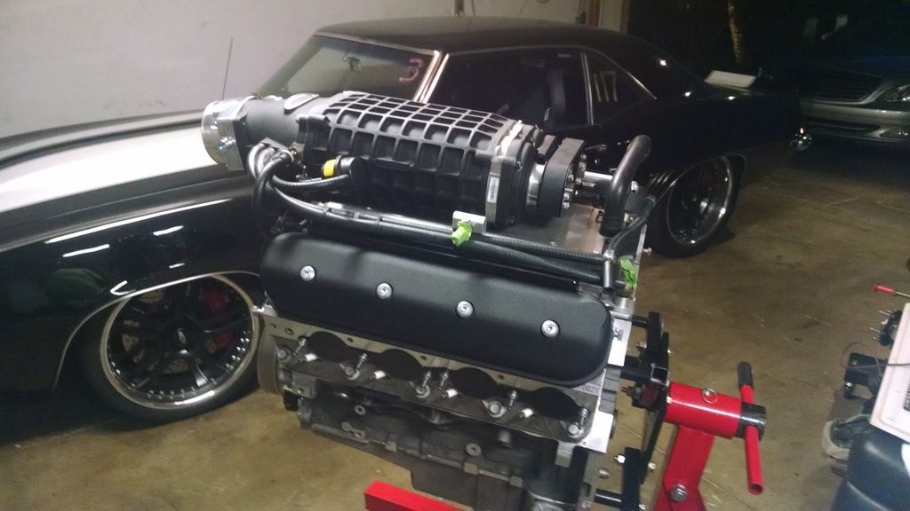

And, of course, if it's on an engine stand in the garage, why not pull it apart to check it out.
I wanted to verify parts from the list to ensure crank, cam, rods, pistons, etc all checked out to spec's. Thus far, all is very well internally with the motor--Pistons are Wiseco forged/coated blower specific, rods are legit, etc.. My plan now is to stud the heads and mains here at the house, and give the heads a once over since I may be pulley this motor for some additional boost. This motor had about 400 miles or so on it.
To that end, I pulled the heads and have them over at the FUEL GOD here in So Cal, Bob McCray. He is verifying the previous work done to them; double checking valves are what they are supposed to be from build sheet, porting and bowl work is legit, springs for height, valve job, etc., then do some flow checking for me.
Hopefully I can start putting this back together in the next week or so.
http://i632.photobucket.com/albums/u...250435_HDR.jpg
http://i632.photobucket.com/albums/u...616702_HDR.jpg
http://i632.photobucket.com/albums/u..._182717359.jpg
So far, the LS is pure joy to work with--except for all the metric crap. It's way easier than the SBC I was used to dealing with.

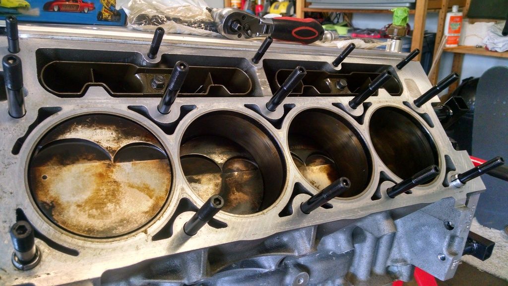

DFRESH 06-10-2015 08:32 PM
Time for me to post a few more legitimate updates on the progress of the new motor for the car.

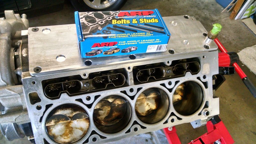

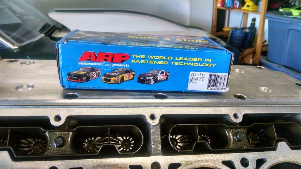

So, after I got the heads pulled off, there were several items I decided to upgrade.
Starting with putting in head studs.

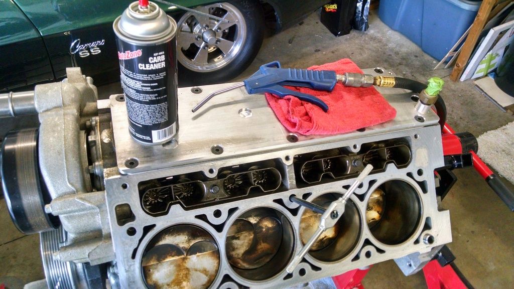

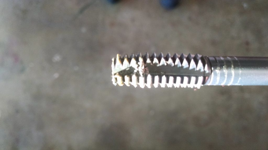

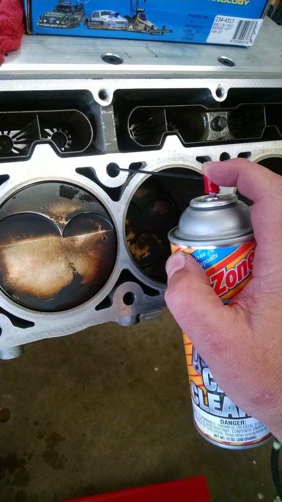

I purchased the ARP thread chaser and started in
http://i632.photobucket.com/albums/u...nstall/252.jpg
I followed the process of chasing the threads, pulled the chaser out, blew it off with compressed air, then chased the threads again. Upon the second chase, there was very little material showing up on the chaser. I would then use the compressed air to clean out the threads inside the block, followed by filling up that hole with carb cleaner, letting it sit while I chased the others, then blew it out upon completion, followed by one last chase and blow out. After inspecting each one, they were indeed free from any material.
http://i632.photobucket.com/albums/u...nstall/253.jpg

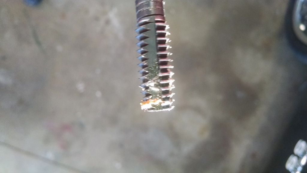

Below is what the chaser looked like after each first pass. There is some form of factory Loctite or sealer on the stock head bolts. It's crucial per ARP to ensure you have all of this cleaned out before installing the head studs.
http://i632.photobucket.com/albums/u...nstall/259.jpg
http://i632.photobucket.com/albums/u...nstall/258.jpg
http://i632.photobucket.com/albums/u...nstall/260.jpg

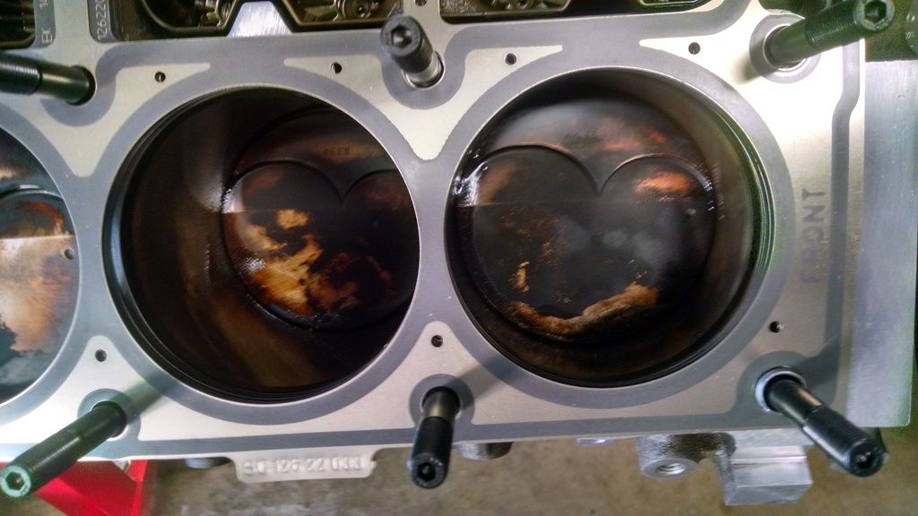

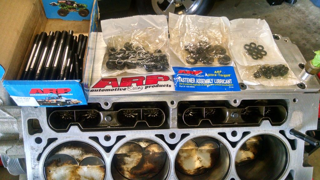

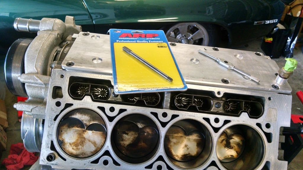

After ensuring all was clear, I went ahead and began the actual head stud install. I've got the Part Number here for anyone who decides to do the same.
http://i632.photobucket.com/albums/u...nstall/254.jpg
http://i632.photobucket.com/albums/u...nstall/255.jpg

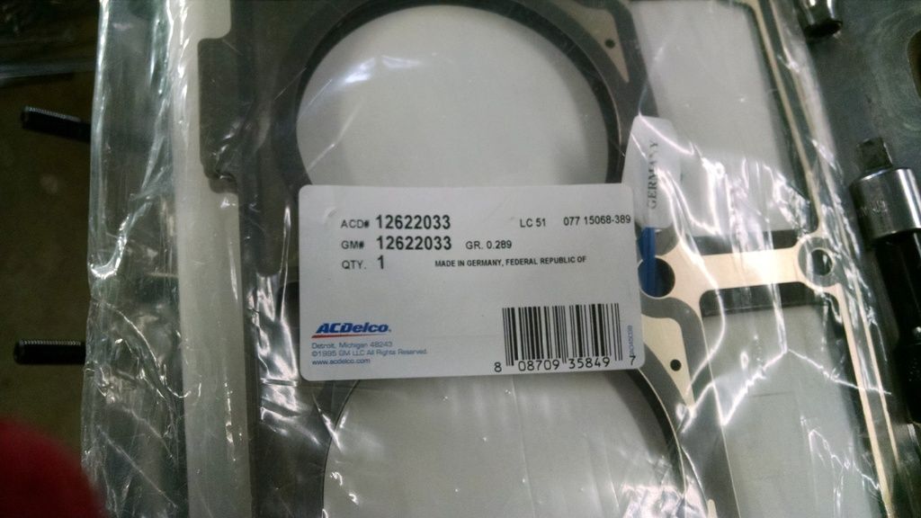

DFRESH 06-10-2015 08:46 PM
The kit includes both the small and large studs for each side along with their proprietary assembly lube.
http://i632.photobucket.com/albums/u...nstall/256.jpg
Per the instructions, and just like on the SBC in the race car, just put them in hand tight--but ensure they are run all the way down.
http://i632.photobucket.com/albums/u...nstall/257.jpg
I did a lot of asking, and after speaking with a couple of friends, in addition to several shops--the LS9 GM gaskets were the best choice for me. These are 9 layer MLS type gaskets, which two friends are running right now, respectively, in a 416 TT & and a 427 with a Pro Charger making well over 1200---for more than 2 years. Always nice when you can get real input from folks actually using the stuff you are considering. So, anyways, these went in place.
http://i632.photobucket.com/albums/u...nstall/261.jpg
These are clearly marked in terms of orientation.
http://i632.photobucket.com/albums/u...nstall/262.jpg
DFRESH 06-10-2015 08:59 PM

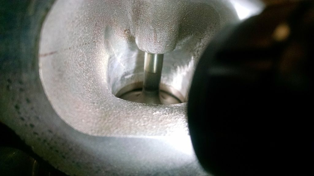

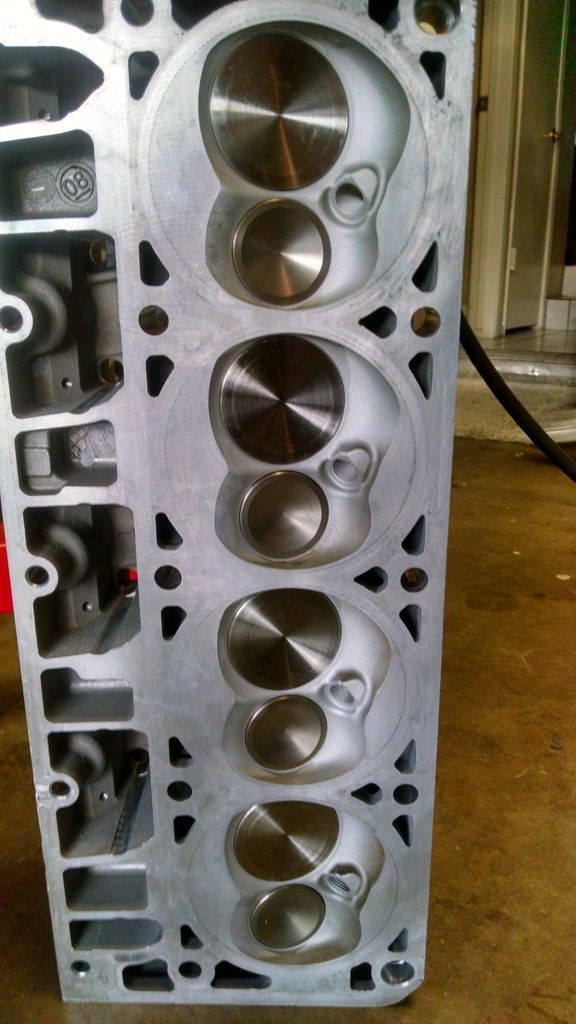

So, after inspection, the heads had not been touched in terms of porting, and had a poor valve job done to them.
The good news, they did have Inconel Exhaust Valves and a good set of Manley Valve Springs.
So, I went ahead and had them blown apart for inspection. We blended the bowls, new valve job, changed out the intake valves for some Manley's, and checked the spring heights. One intake was missing the shims under the spring--it's like the builder just forgot about it. Anyways, they are setup now as they should be in my opinion.
http://i632.photobucket.com/albums/u...nstall/263.jpg
Here are couple of shots to show the light bowl blending on both the intake and exhaust ports. These heads flow pretty impressive numbers right out of the gate. With the valve job and bowl blending, we picked up about 30 additional cfm.
http://i632.photobucket.com/albums/u...nstall/265.jpg
http://i632.photobucket.com/albums/u...nstall/264.jpg
