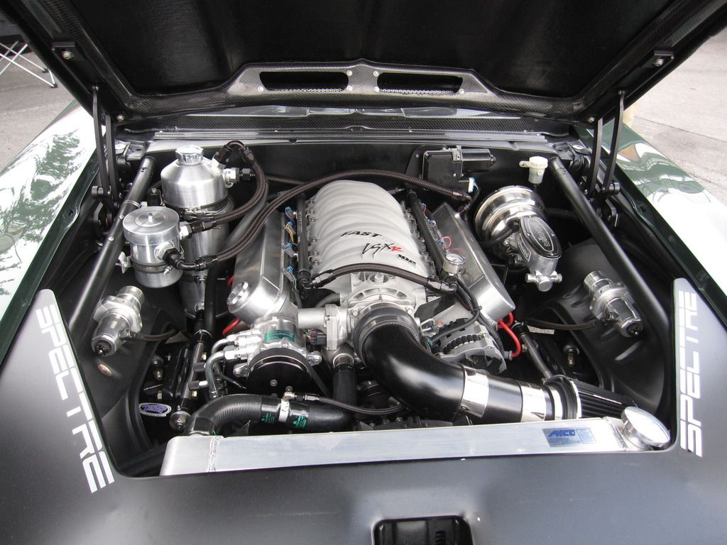

I'd love to see a picture of the firewall without the tank in place. That 2.5G tank is 24" tall. The mockup I made was the 2G tank, and it's 19.5" tall. There's no way I could put that height in that spot. As I type this, it's possible that may be a 7" diameter tank instead of the 6" I'm considering, but that wouldn't work either for me... :(
Their downbar is also further out than mine, giving more room between the bar and the engine/header.
Sure looks nice though. ;)

What's up Eric! That's another proven location for a tank. Stielow and others have placed it there AND thrashed on the cars successfully.

Yes it is - it was just for context. Here is Finch's 2nd gen (he built that green 69 pictured as well) with the tank in the same location.
http://i236.photobucket.com/albums/f...psrh5h8afo.jpg

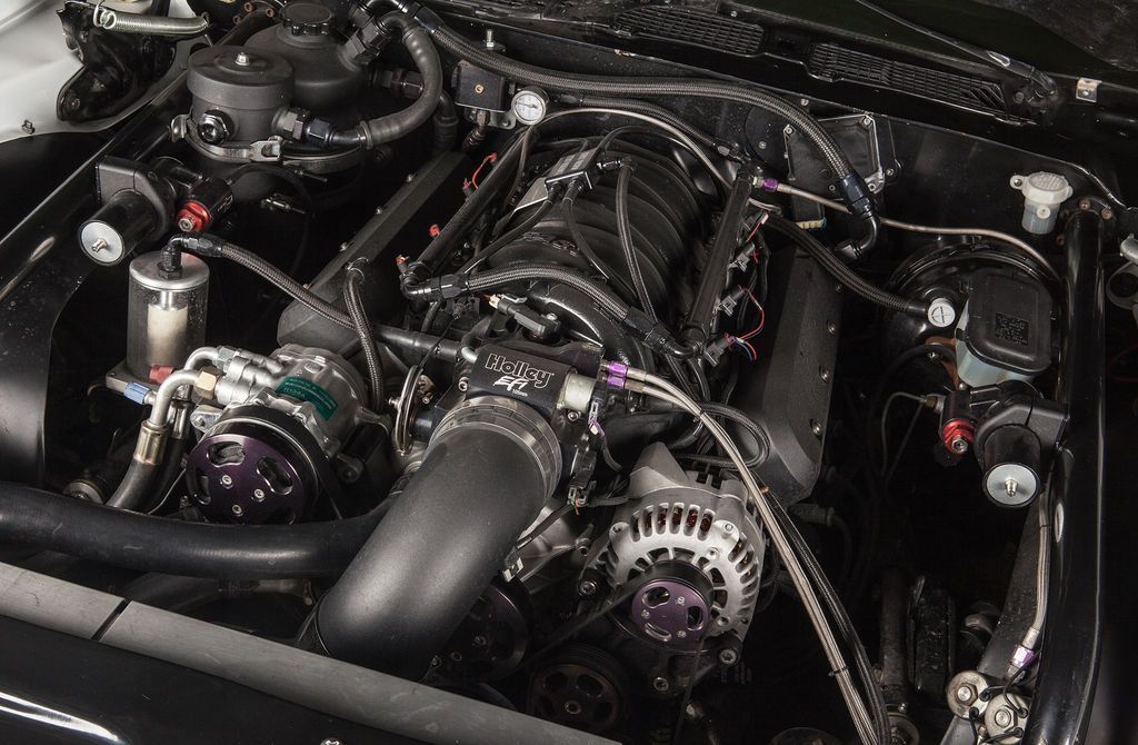

Even his own builder is posting dry sump tank locations... :idea:
DB Z28 04-14-2016 10:32 AM
I,m in the same boat also looking where to place the dry sump tank. Looked at the firewall area and it it seem to close to headers in fear of heating the oil up too much. Might putting put it in the front where the battery was it will hang down slightly in the front wheel well area but than weight on the front end, And thought about putting it in the trunk but don,t know if its too long of a run for stock LS-7 pump?
