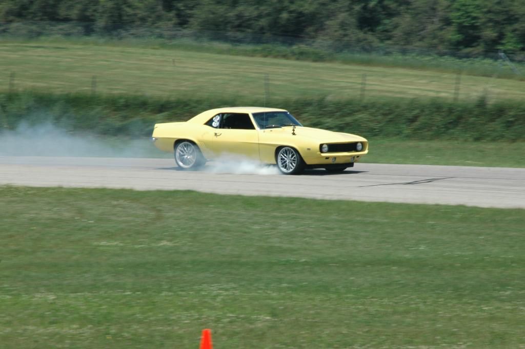

Adding Bosch ABS to the Brembo Carbon Ceramic brakes. The car is very hard to drive fast with the grabby Carbon brakes. I’m going to copy the ABS system off Hellfire.
Stielow
Mark, may I ask how the ABS system will help the brake feel? I'm using the ZR1 brakes on my build as well but wasn't aware they would be grabby, is that just the nature of carbon brakes?

They are fine without abs for street driving but on the track under hard braking the grip will really ramp up during a hard decel. At Motorstates challenge I locked them up and slid thru the grass. Same turn they started to lock up on Stielow but he was smart enough to take his foot off the pedal. For track use without abs I was going to swap in steel rotors so I wouldn't have the lockup issue.

formula88 02-04-2015 08:03 PM
Kinda like this???
http://i1158.photobucket.com/albums/...09GMSO_122.jpg
formula88 02-04-2015 08:07 PM
Originally Posted by GregWeld (Post 593213)
Did Charlie mention anything about the sharks at the beach to you and Gordon?? Just sayin'......
Sharks?? Nobody said anything about sharks!! :_paranoid
GregWeld 02-04-2015 08:25 PM
Great pic of the Jackass driving Jackass, Gordon!! I remember him telling us this story at a track event one weekend....
You guys will have a great time drinking Charley's beer. Post up pics of Liz on the beach... LOL

RussMurco 02-05-2015 10:14 PM
Originally Posted by formula88 (Post 593223)
Thanks for the info, Charlie, and thanks for the visual, Gordon!
Is it still on the original set of rotors and pads?
