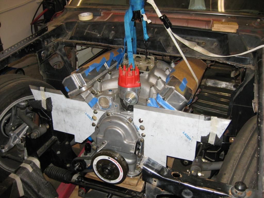

It will eventually be welded back in now that the motor and transmission has been moved back 7.5".:D
I have the stock tunnel cross brace I drilled the spot welds out of and removed if you want one of those.
Does it make more sense now, why, it temporarily came out?

FETorino 12-08-2013 11:08 AM
Originally Posted by INTMD8 (Post 521483)
How is engine placement in relation to front wheel centerline now?
This gives you a good idea. The balancer is behind the rack and the front of the block is at or just behind the front axle.:D
http://i291.photobucket.com/albums/l...pse8e162a2.jpg

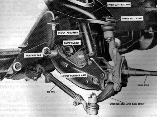

You can still find reference to portions of a spindle as an axle :lmao: :lol: :lmao:
http://i291.photobucket.com/albums/l...psd986f2d4.gif

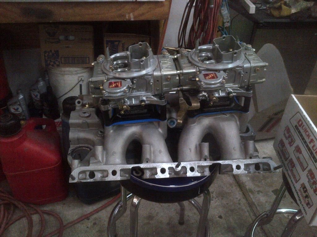

Originally Posted by intocarss (Post 521507)
I thought you were running dual quads??
JerDog. Eventually.
I ran both setups on the dyno. My 701hp on E85 was made with a single 4150.
Back to back on Gas the first weekend on the dyno we got close to 25hp more with the dual quad over a single Dominator and about 35hp more than the single 4150. I don't own, or have access to a pair to borrow, of properly set up dual E85 carbs so I don't know what the E85 single vs dual quad hp difference would be. I'm sure the duals would also make more hp on E85. The intake is just a better overall design.
One day when the bleeding of $$ slows I'll build a matched set of E85s for the dual quad and it will go on the car. Just for the cool factor if nothing else. For now I'm just running my single 4150.
:cheers:
http://i291.photobucket.com/albums/l...ps1ec06523.jpg
http://i291.photobucket.com/albums/l...ps7b22f07b.jpg
