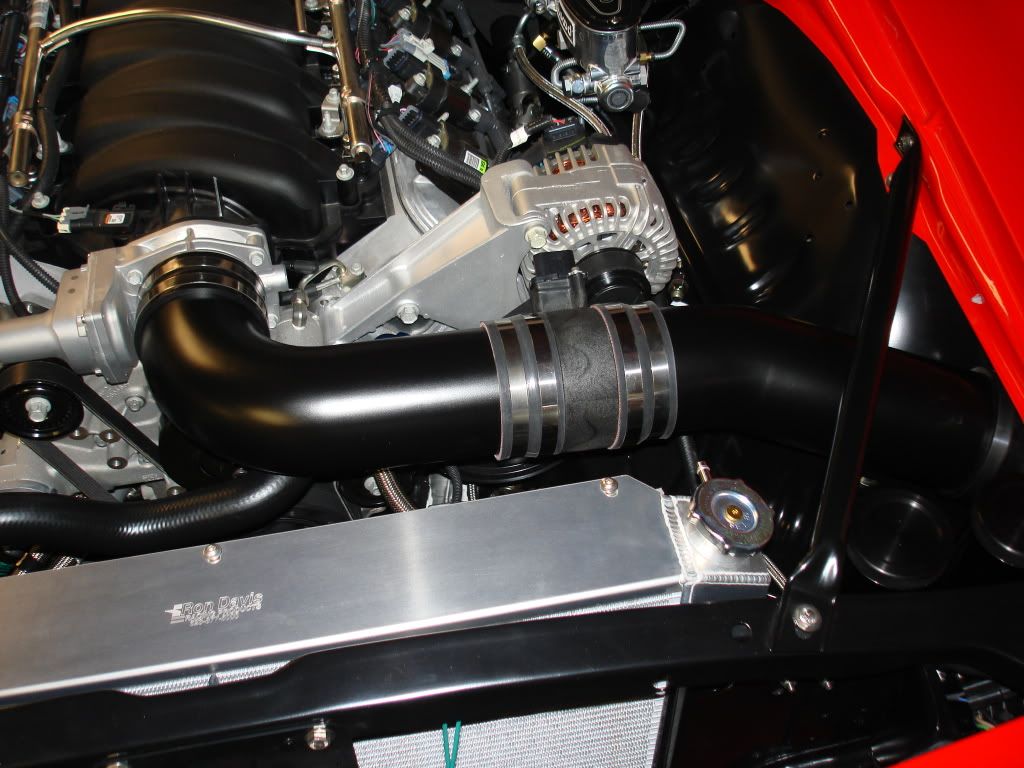

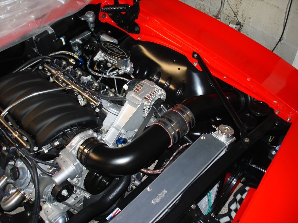

I made progress on the air intake and very happy with the way it came out. I purchased the alluminum tubing from spectre polished but ended up scuffing it real good with 600 then etch priming and painting. The MAF housing is from powrmax using the stock ls7 hitachi sensor. According to Scott that location for the air filter is real dirty so he suggested a pre-filter skirt that covers the air filter, got that on order(thanks for the heads up). All I need is a couple low/high note horns and Im ready to put the hood back on. Heres a few pics under the hood with the CAI.

Rich
CrossRamRich 12-19-2010 10:46 AM
"Drop dead gorgeous"!:unibrow:
