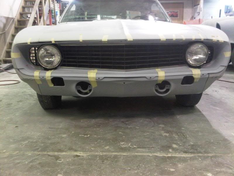

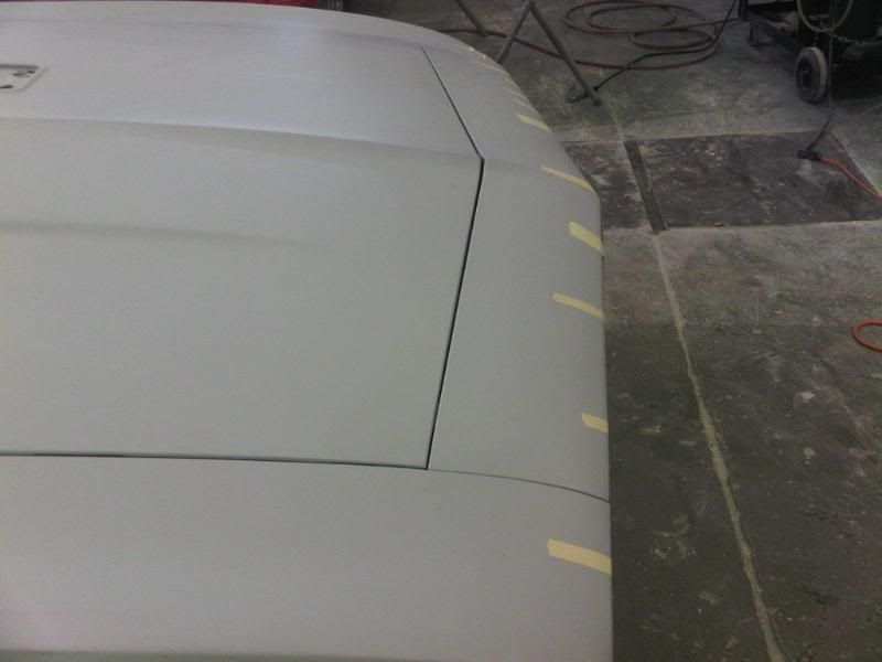

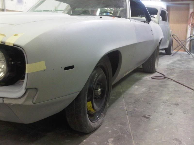

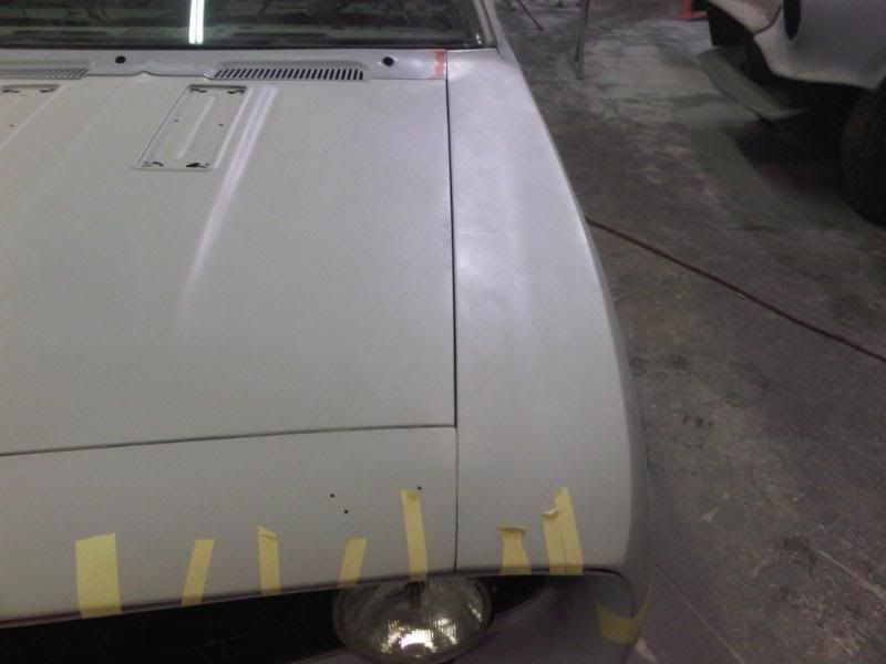

Final assembly today to set the gaps. A few last adjustments and the car gets blown apart for the final primer.

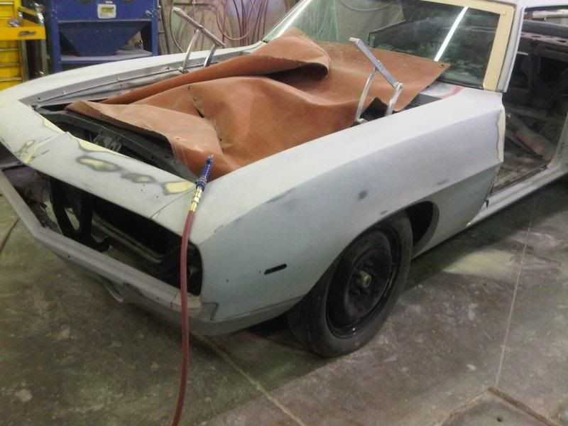

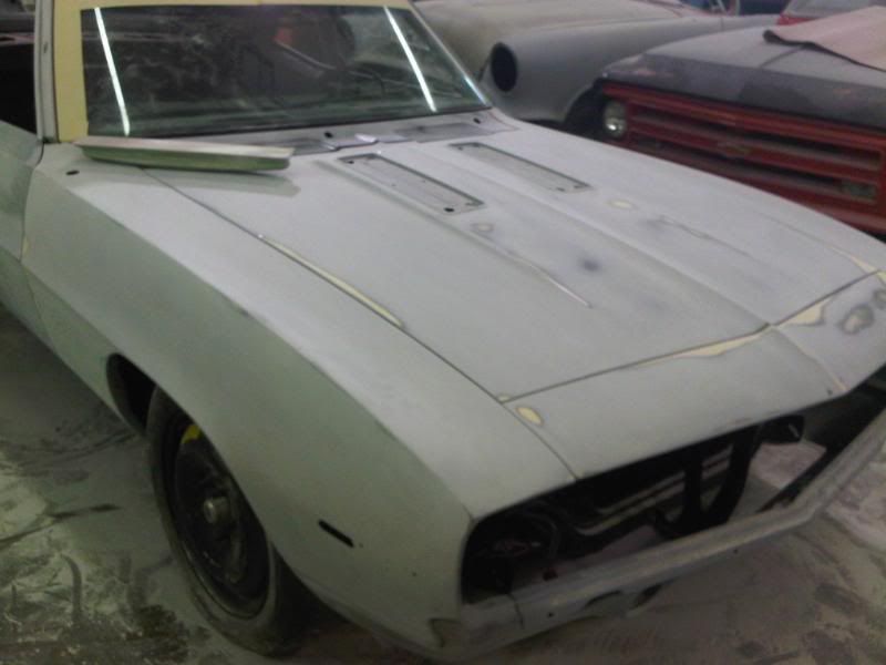

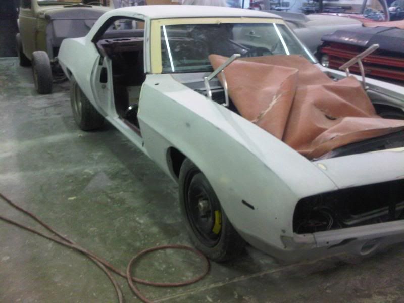

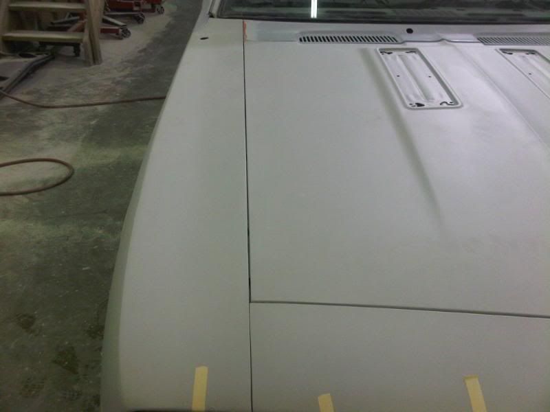

A little guide coat and the first round of boarding in progress.

Once they board out the whole car in the assembled stage, they blow it apart for final prime, board out everything again, and then to paint.

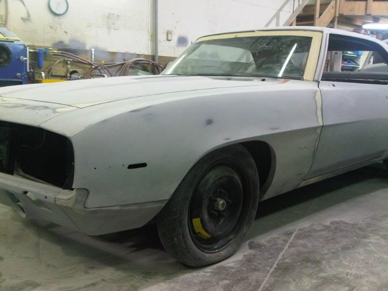

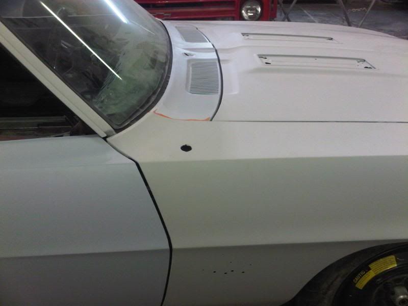

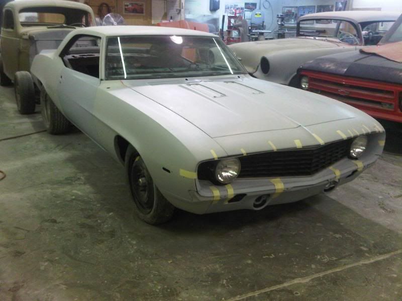

All the edges and pin holes have been taken care of. Car being blown apart today for final 3 primer coats tomorrow and then let it sit and dry over the weekend.
