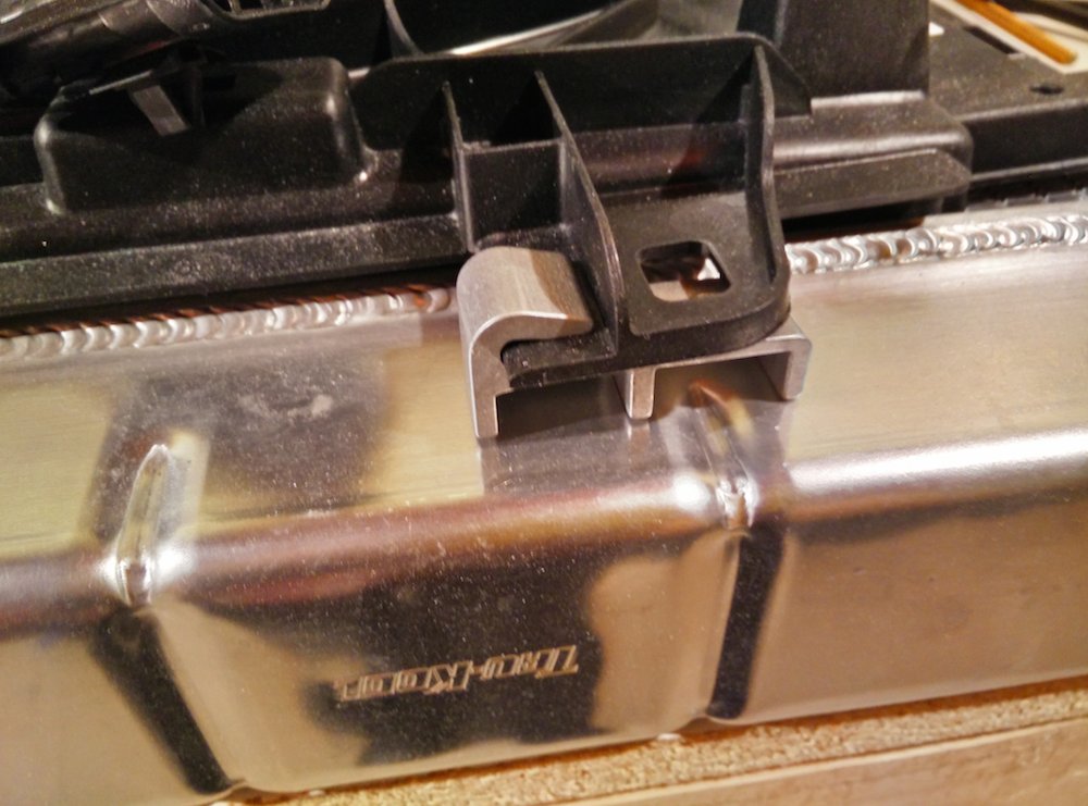

waynieZ 02-12-2015 08:00 PM
Those brackets are going to make this fan a lot easier to mount. Nice!

Hey Andrew, I got the C6 fan that you have. Wondering if you are seeing the same as I am. One of the clips with the hole, the hole doesnt line up with the hole in the fan shroud. You seeing that too?
andrewb70 02-17-2015 02:38 PM
Yes Sir. I noticed that too. I guess I'll slot the hole. Won't be a big deal since you have to use a u-bolt there anyway. I wonder what the stock bolts that go in that location look like. And why is the hole square? LOL
Andrew
