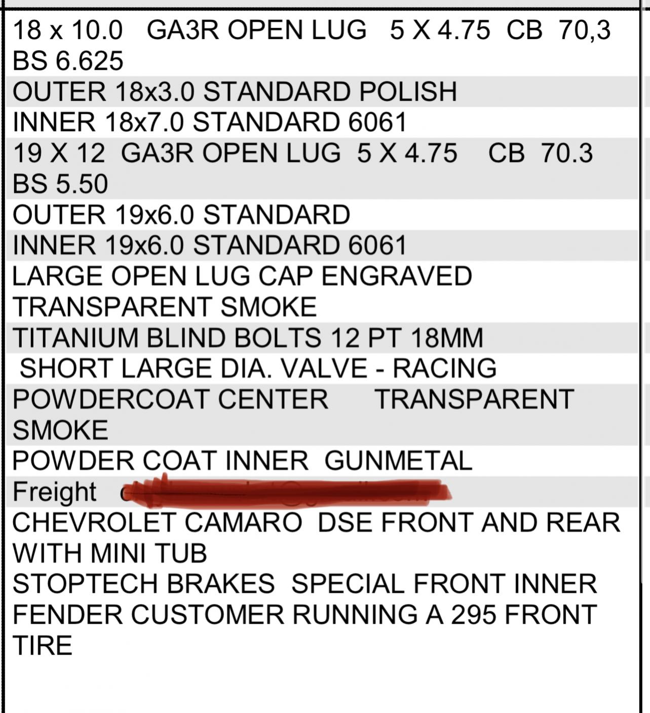

295/35 up front on 18x11
345/30 out back on 19x12
I'm late to the party.
Any specifics on the offset for the front wheels? I also have a DSE front subframe for my 76 T/A.
two-piece 01-14-2023 02:11 AM
1 Attachment(s)
Attachment 79649

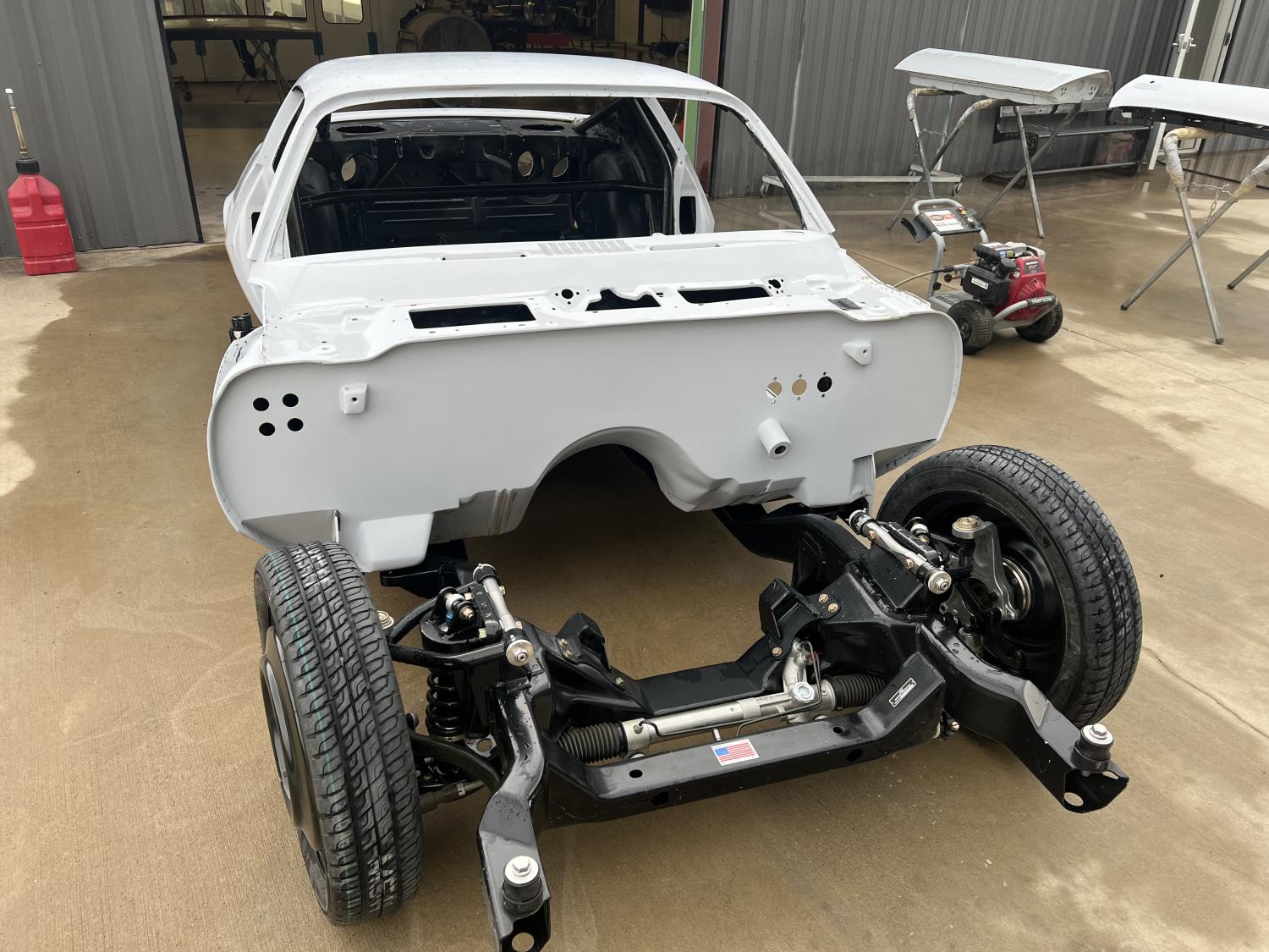

Cars in final prime.

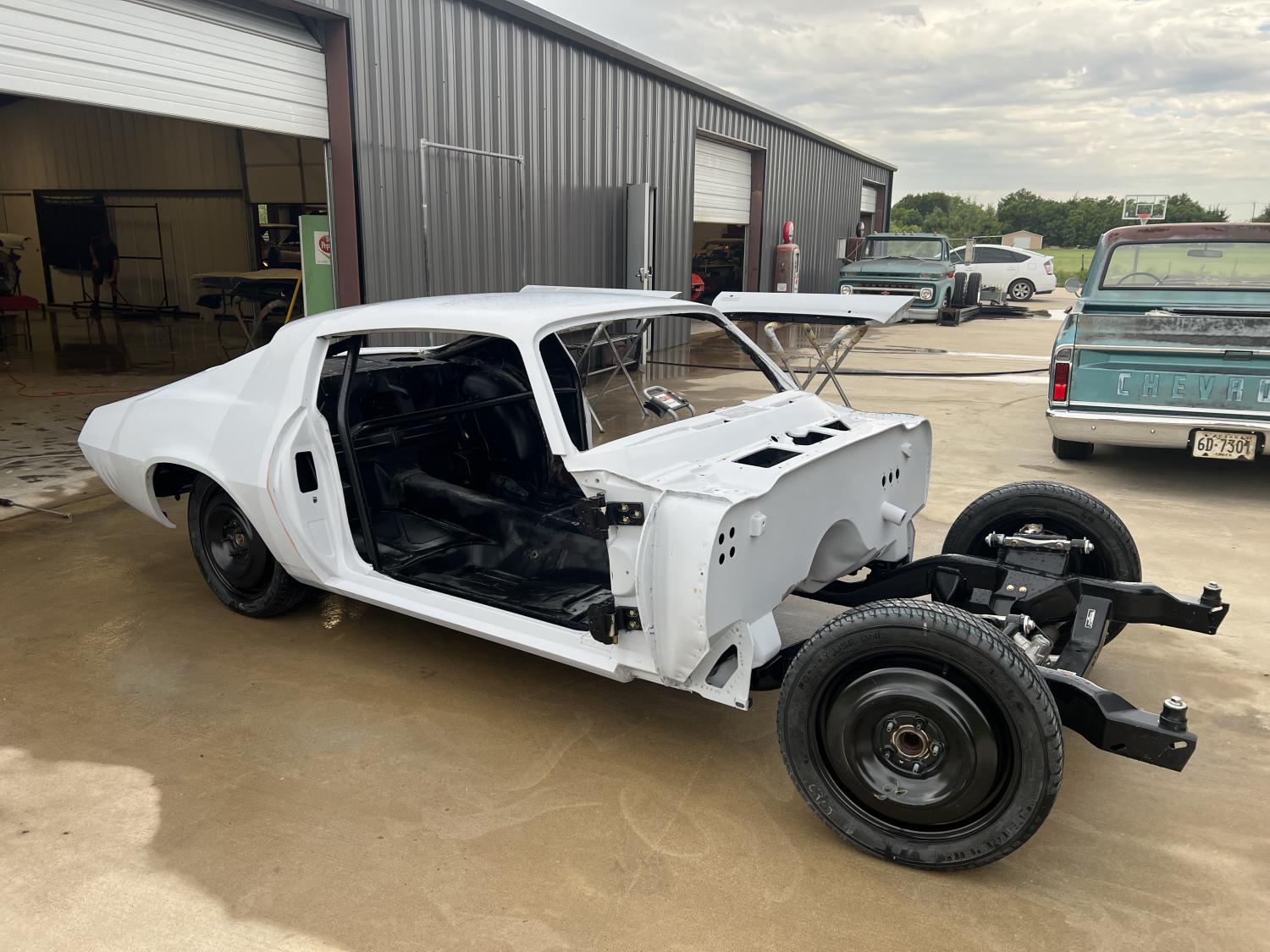

The Camaro is finally going to get color. It’s been a long time coming but the final sand before going in to the booth is underway.
