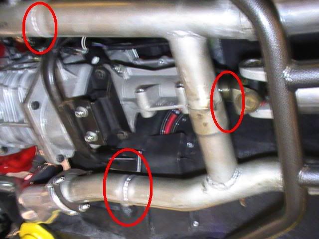

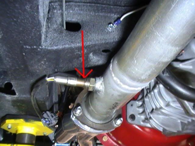

H Pipe
Got a lot done today. Took a day off to regroup. Those damn gremlins keep sneaking up and screwing with everything.
For instance, the drive shaft delivered to me was too short. Well I ordered, and received from UP (a few weeks late) a longer driveshaft. This fixed one problem but created another. The front universal knuckle started hitting the H Pipe. Damn it!!!
OK I removed the H pipe and had it cut 3/4" on both sides to give me a little room. I also clocked the EFI sensor a little clockwise because it was getting very close to the frame. This allowed me to lift the transmission a little more, hopefully taking care of the shifting problem. We will see in the next few days:
http://i98.photobucket.com/albums/l2...tHPipeCut1.jpg
http://i98.photobucket.com/albums/l2...stHPipeCut.jpg

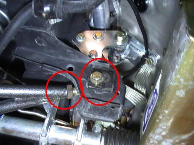

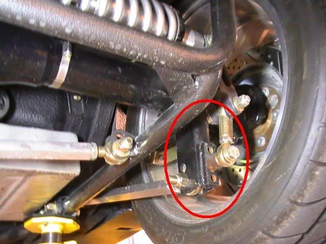

Front End Alignment
Got the front end aligned today also. I stayed with they guy doing the alignment, and boy am I glad. He really didn't know that you could rotate the plate to move the LCA out for the negative camber.
The figures from TCP:
Camber 0- ½ degree neg
Castor 2 ½-3 pos
Toe 1/16” -1/8” In
http://i98.photobucket.com/albums/l2...EndAligned.jpg
But We got it done. Front and rear end. It was only out a little, but a little sure makes a big difference in the way it drives. Now I got to lift the rear a little more. There are adjustments on the UP rear Coilover system to allow for this:
