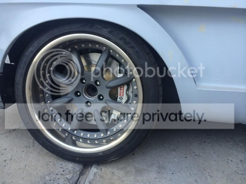

Funny how Sutton had me change to a harder rotor and a softer pad.... and wow did that ever make a huge difference!
Ron had something pretty close, those Brembo GT brakes, but my accent colors are yellowish to goldish in hue like the nickel on the wheels, or the titanium anodizing color on the rotor hats, and Ron's brakes were powder coated bright red, which would have totally clashed and I just couldn't have that. This isn't a race car, so everything has to be cool, haha
http://i366.photobucket.com/albums/o...psefd8b4ac.jpg
Matt those are BAD A$$! Rode in a Evo yesterday with 500HP and some Stop Tech. That things pulled your eye out the socket when you hot the brakes., just crazy bad! Your going to love them.

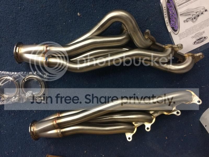

I gathered a few more parts at the beginning of 2015, most notably these Stainless DSE headers, which are amazing in quality. It's a shame they'll be almost completely hidden when the motor is in.

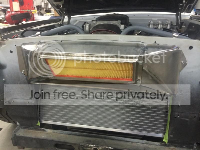

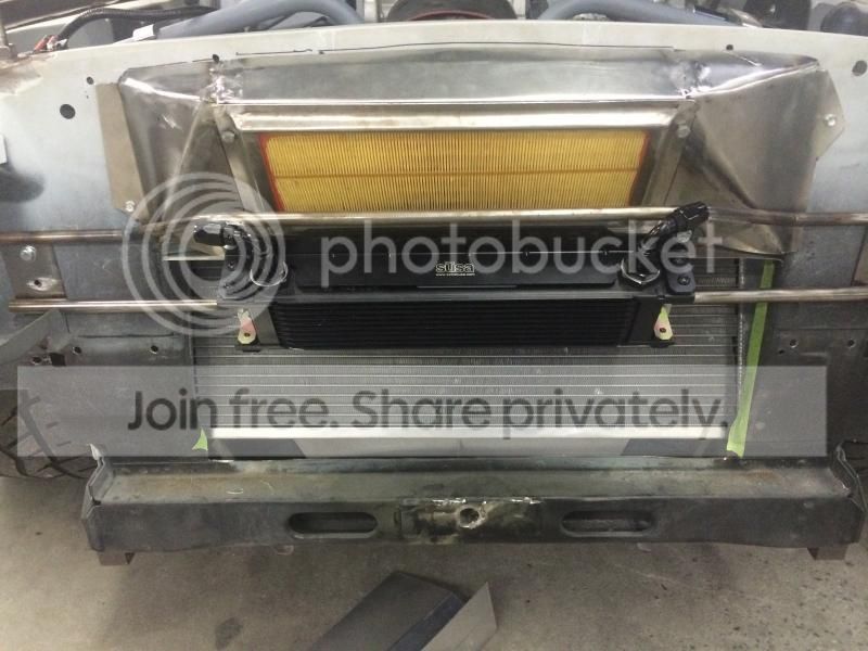

I've also continued work on the front end, placing the radiator, power steering and oil coolers, as well as the intake.It has been a ton of work as everything is pretty much custom at this point. I've had to cut and modify coolant expansion tanks and hack up the core support, but after what felt like a thousand hours of taking things on and off repeatedly to check fitment, I'm finally starting to have pieces that look like they might be something some day.
Here is the air box bolted up in its final location. Now I just have to build everything around it.
http://i366.photobucket.com/albums/o...psffcf539a.jpg
The radiator is shorter, but wider than factory, and is supposedly good for 600hp, however, with the location of the valance and coolers, I wanted to make sure that the radiator's air had a dedicated path since it will only be flowing in through the lower grill opening. I also could not leave the airbox bolted on like in this picture
http://i366.photobucket.com/albums/o...psf173301e.jpg
I'm building this cover that will become part of the core support. Undo four bolts and you can change out the filter, without taking everything apart, at least in theory.
http://i366.photobucket.com/albums/o...ps482e455e.jpg

The car is coming along great. I think you would be better off with that cooler with the grain rather than against it. Seems you are blocking off way to much radiator.
Matt@BOS 02-22-2015 12:38 PM
The radiator actually won't draw any air from in front of the power steering cooler. The PS cooler is mounted 4" forwards and will fit into the the upper grille section. The lower opening will have panelling to make a direct path to the entire radiator. The oil cooler will mount in front inside the lower opening, and will have plenty of space between the radiator for air to flow. We'll be finding out if this plan works the hard way. :lol: I could also mount the oil cooler down low and horizontally, in front of the engine, with a protective cover and it's own dedicated fan. Isn't building cars fun?

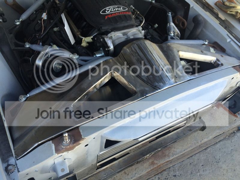

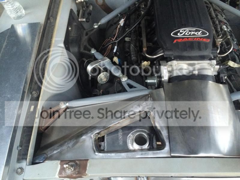

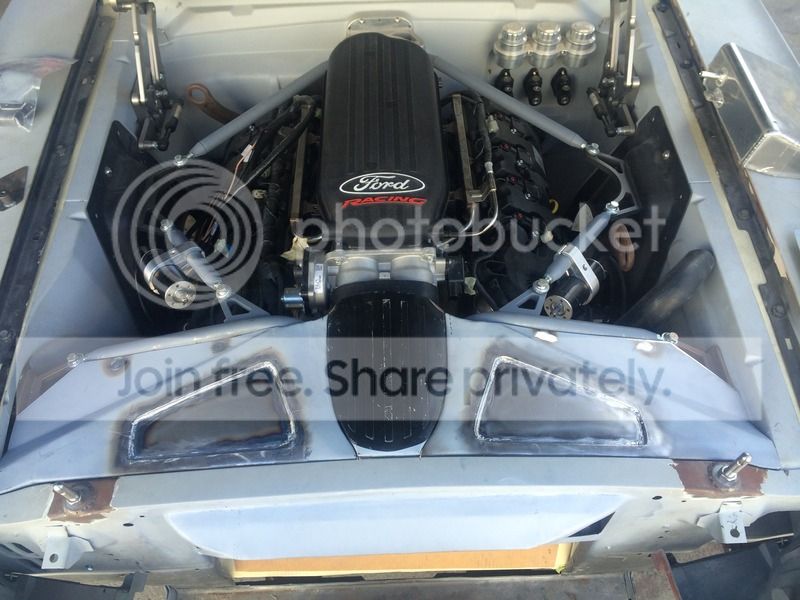

Matt@BOS 04-02-2015 06:49 AM
I've mostly been working on things that will never be seen on the car like a way to mount electric fans, which proved more difficult than usual since there was very little space to work with. The radiator and intake cover will be seen, however, and I do have pics of that.
It's been through a few revisions. The radiator fill cap was supposed to fit through but do to other space issues, it wouldn't work without moving the intake/filter mount.

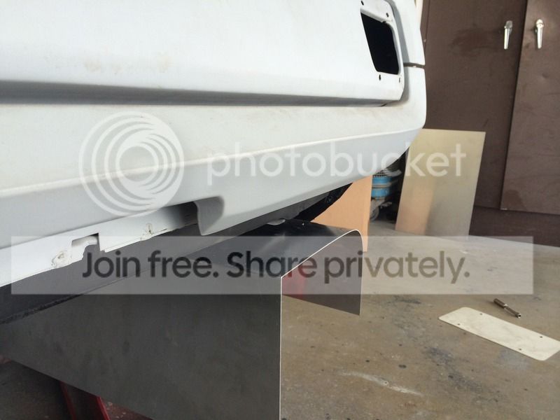

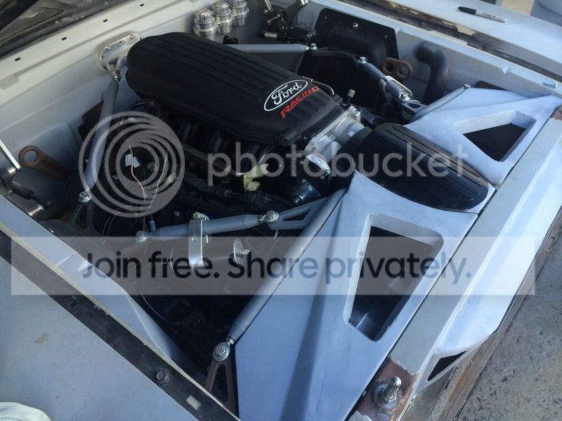

Matt@BOS 05-15-2015 08:52 PM
I'm still making progress on the car, and still think its a possibility to get it finished before Dave gets BMF on the track, or Ron buys another car. One can hope, right? :lol:

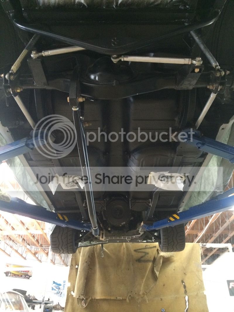

I finished the underside. It has been seam sealed and undercoated. I also ran the fuel and brake lines, so there's a little less to do later.
http://i366.photobucket.com/albums/o...pszmqbzvlw.jpg

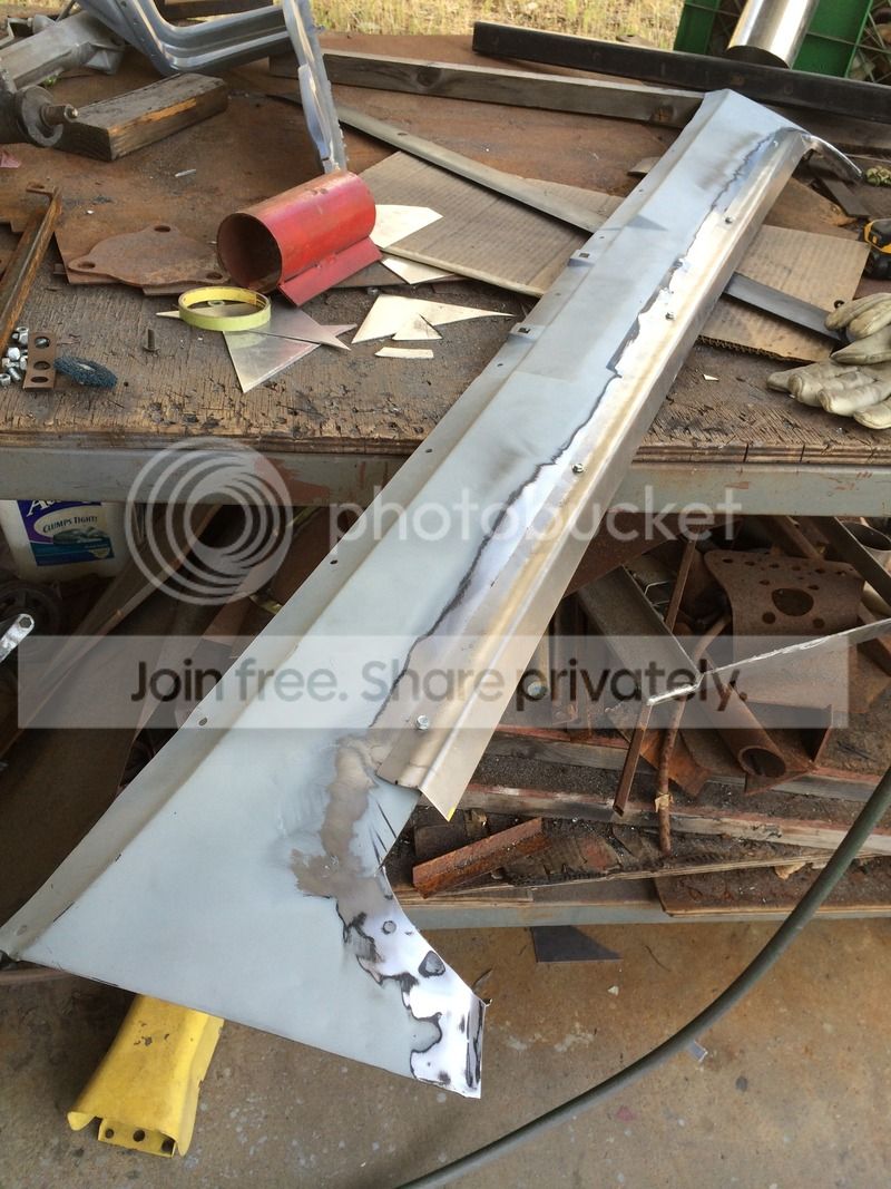

I was just about to disassemble the front end of the car and get it ready to have the engine bay painted, but then I found something else to do...
http://i366.photobucket.com/albums/o...psqwkvvuuc.jpg
http://i366.photobucket.com/albums/o...psrxfrsxom.jpg
http://i366.photobucket.com/albums/o...psxt9kuma9.jpg
http://i366.photobucket.com/albums/o...psmlridppw.jpg

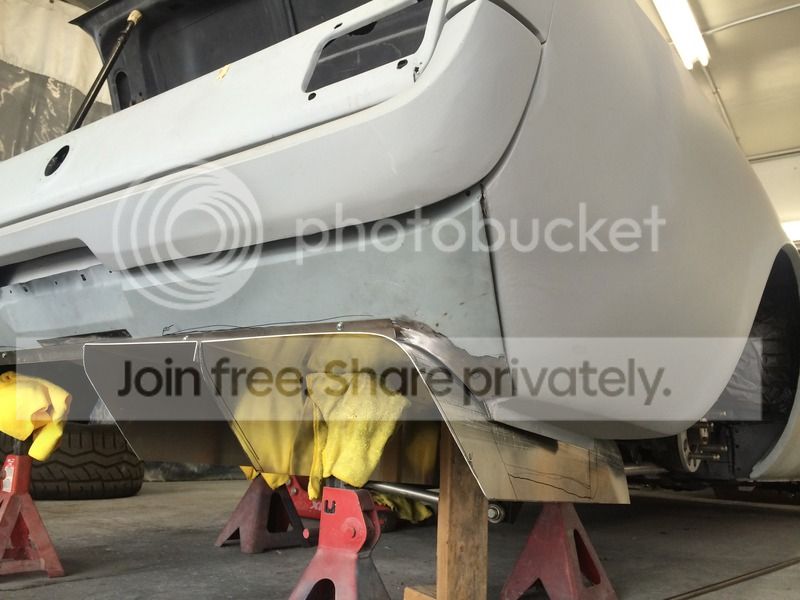

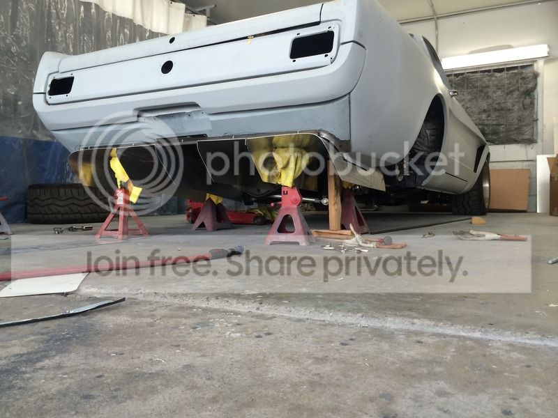

I'll be finishing the odds and ends up tomorrow. Then I might start mocking up ideas for a rear spoiler. The rear body lines between the trunk and end cap pieces are a bit complex and tricky to work with, and if I can't make something that looks like a "could have been" part, I'll just leave it alone.
