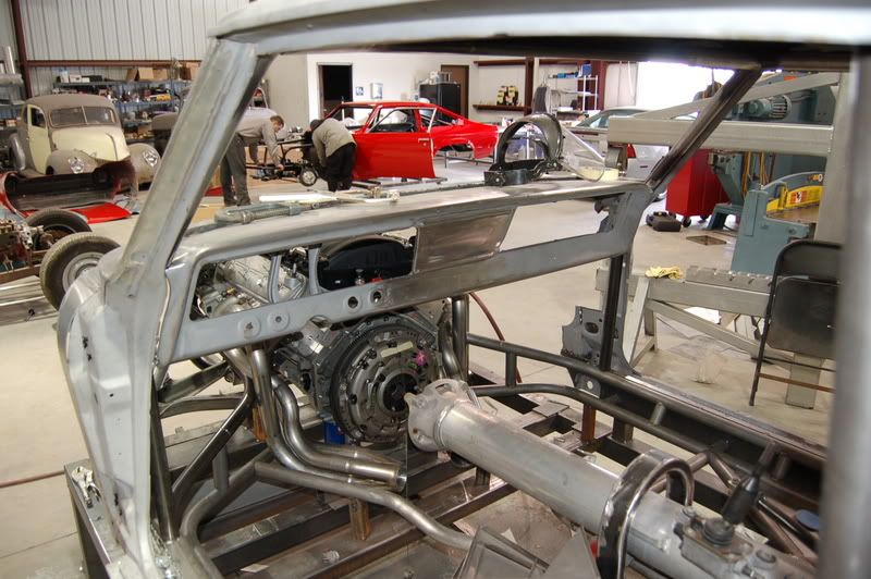

We had to move the sway bar and radiator up a little to make room for the blower elbow but it all fits snug as a bug in a rug! :D

what are the boxes bolted to each side of the rear tubs in the trunk?
HWY Nova 04-20-2009 09:12 AM
Those are John's 'fuse boxes/wiring system' boxes by Isis....... Really fancy stuff! John will explain.
--Eric
ironworks 04-20-2009 09:18 AM
It is for the ISIS power system. It is pretty high tech stuff. It is basically the controller for the main body harness for the car.
Just search for ISIS power system. It does some really cool things.

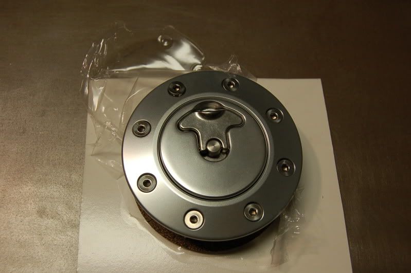

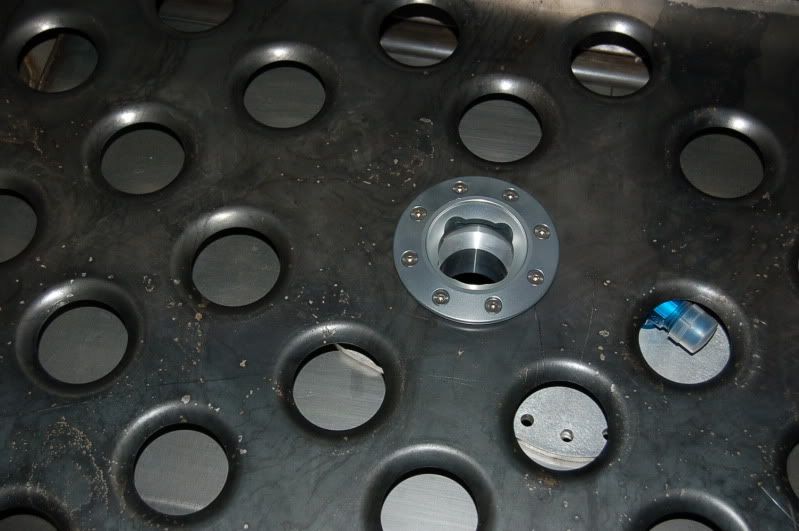

The filler neck that AirRide sent me that they're making worked out PERFECT!!! It feels so nice when it's in your hands and is really a quality piece!!! The neck extension is perfect for whatever you want to do and worked out great for us!!!

rjsjea 06-01-2009 06:49 PM
Insane build, obviously ;) Great detail
Is that dimpled trunk piece easy to remove?

ironworks 06-02-2009 08:15 AM
Just unbolt the fuel cap bolts and the 4 perimeter bolts and she comes right out. It sure gives it that different look. We have few more ideas coming along with it but you guys probably get the point.

ironworks 06-03-2009 10:09 AM
It was pretty easy, We waterjet the panel, or I would have used up like 10 hole saws. Then Brycen and I dimple died the whole panel in like 45 minutes on an air over hydraulic press. Nothing too difficult.
